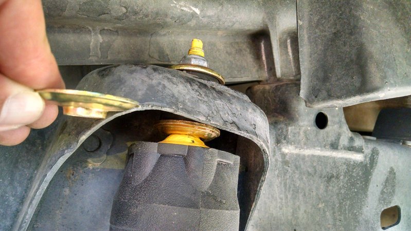

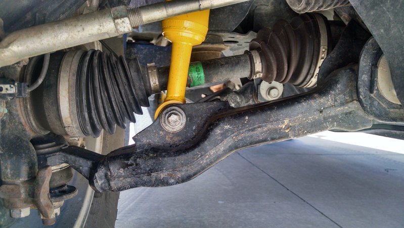

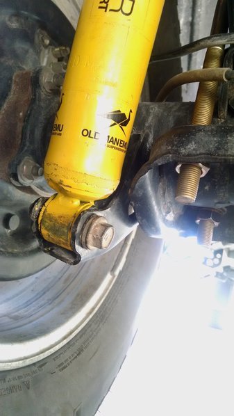

    I like this thread helped a lot and installed my lift last night with 2 friends we were able to get it done in about 4 hours. We were on a time crunch being that the base auto shop was closing, so I know we rushed somethings a bit and was curious if we actually did everything correctly. pics included.
    Yes, I will be getting new tires soon.
    Thanks for all and any help!

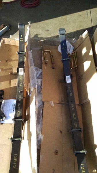

    1. Wanted to confirm which side each leaf back goes on? One had a "+" the other an "O"

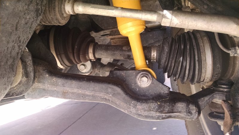

    2. I am going to do the diff drop tomorrow, but how do the CV's look? I think its touching a bit. (Pics taken from the front)IMG_20160713_175644858.jpg IMG_20160713_175711956_HDR.jpg

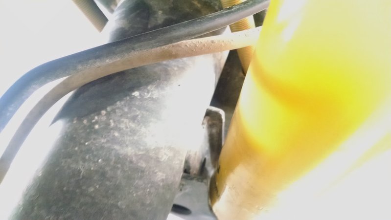

    3. The top mount for the rear shock? I had an extra washer, was told by one of the guys that works at the auto shop it wasn't needed, wanted to double check his word?

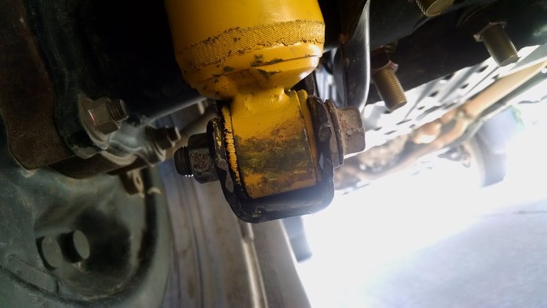

    4. The spacing on the bottom shock mount on the axle and the shock body seems very tight, is that correct? Yes, I had to pound the shock to align it and get the bolt through...
    IMG_20160713_175849317.jpg IMG_20160713_175910839.jpg IMG_20160713_180027655.jpg IMG_20160713_180033443.jpg IMG_20160713_180154050.jpg IMG_20160713_180217788.jpg

    1. + pack goes on driver's side.
    2. Diff drop for 2nd gen is pointless. Stay away.
    3. If you have a washer in there you should be good.
    4. It is what it is, not like you can f up the installation of the rear shocks, they only go one way.

    Thanks, there is one washer on bottom then the rubber piece then the frame then another rubber piece and then the second washer, it came with 3 washers total and 2 rubber bushings.

    OME 886+Dakars, ARE Shell, ARB Front Bumper+Winch
    Alright, so you think the CV's are good in that picture the way they are?
    I did put the "+" leaf on the drivers side so I am good there btw

    Looks fine to me. You can always do the boot slide mod to help space the fins a little more. Here is a crappy pic of mine after last weekend's install.
