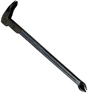

    If you pull the UCA out you dont need to mess woth the tie rods, there is enough room. I had to pry my lca just a little bit, barley any force to work the eye of the shock in, this was with OME 885s and nitrochargers. I got the shock in place, then shoved a catspaw in between the eye of the shock and the LCA mounting location, made it really easy to line everything up and push the bolt thru.

    I was surprised how easy it was, especially with write ups like this one, props to bjmoose. There is a couple other good write ups floating aroud here, some good ones that are not stickied also.
