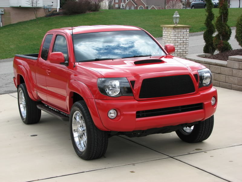

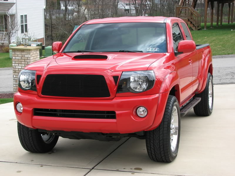

    I used the 3M rubberized undercoating. It was really easy and looks good too (IMO).

    I like that were did u get the grill how did u do it did u have to cut the center out of your old grill

    Wow dude, punctuation!
    I bought the grill off ebay. I would recommend spending the $ on a brand name grill. I had to do a lot of trimming to make the grill fit right.
    Basically you remove the grill from your truck, cut out the center cross bar, and install the billet grill. Mine included clip nuts which fasten the billet grill to the plastic grill surround. Installing the grill is easy.
    I sprayed all the billet grill parts with the 3M rubberized undercoating. You can buy it at any autoparts store. I think I put on 2 coats.

    +1 thats a really clean looking truck u got there. sport access cabs are always a plus, hard to come around

    Ok so you once you apply 2 coats of 3M rubberized undercoating what kind of black spray paint did you use? :)

    The undercoating is black itself.

    The 3M stuff is black itself. It has a light texture to it, similiar to a bedliner.
