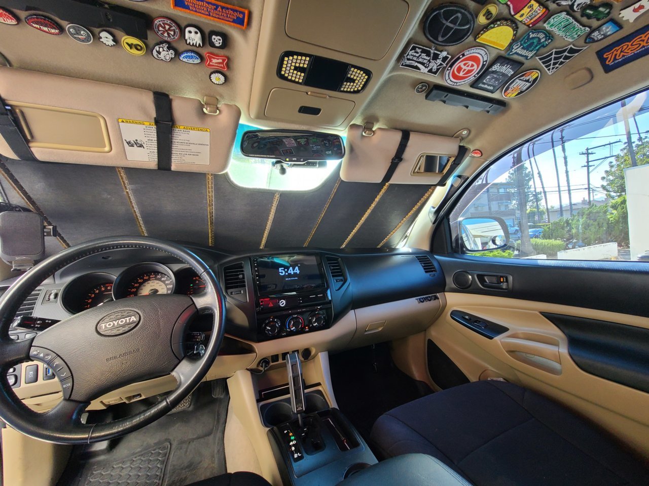

    This project was the first time I ever built a wiring harness using pin connectors, it wasn't bad. I got 20 awg wire off of Amazon, the assorted colors helped me keep the right wires/pins going to the right location in the connector. Pin removal keys are nice to have incase you do put a pin in the wrong location. Also, borrow or buy some open barrel crimpers, they a specifically designed to crimp the pins to the wires. Watch a video on making the crimps, you use a smaller size of the jaw for bare wire and larger for insulated section to secure the pin to the wire. I found that I needed both sizes of the crimpers in the link below.
    Crimpers
    https://www.amazon.com/dp/B07G98DLB8
    Wire
    https://www.amazon.com/dp/B07TGJGJGD
    Pin removal tool
    https://www.amazon.com/dp/B0922GF9W8
    The pic below is my finished product! No more silver on the dash! The Dasaita head unit has been amazing! The Scosche Magic Mount has worked well, it would work better if I put the magnetic pad on the phone cover as suggested. I changed the lower center section of the dash to a version from the Gen 2.5 Tacomas because it offered 4 additional switch blanks.

    Are the pins in the harness different? Why not just de-pin and re-pin?

    Holy smokes, both of those last two posted interior shots are money. Nice job, guys!
