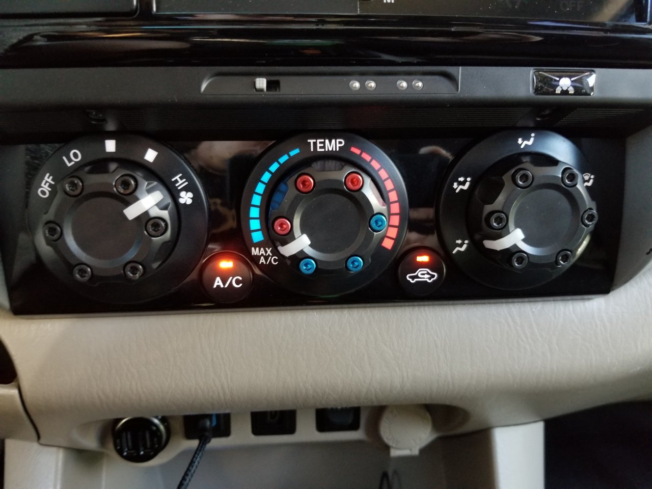

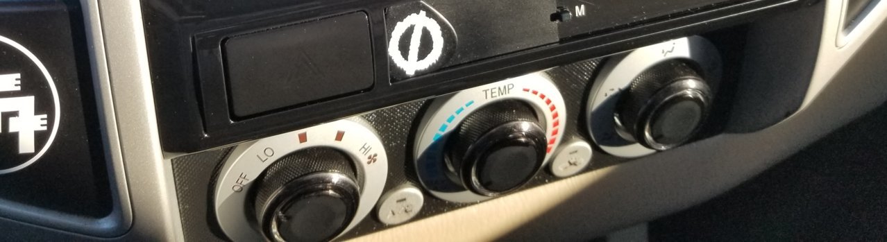

    Ya I understand that, but that damn silver trim is driving me nuts. I've been trying to fully delete all the silver interior trim. As you probably know, the trickiest part is those damn climate rings and buttons and they stick out like a sore thumb. :rofl:
    Ya I saw those threads! if it comes down to it, I'll do the conversation. There's a guy on here who makes the harness and just a bit of trimming is needed. From what I learned the plastic face pieces can't be swapped. But I could be wrong haha but its worth a shot IMO :D

    I wish it were that easy. I ended up buying a used climate control for $68. Now I'm on the hunt for a '12 tacoma plug to make a harness (pig tail) and or someone that can make me a couple. :thumbsup:
    Plus I want the white LED look.
    Absolute PITA little mod :rofl:

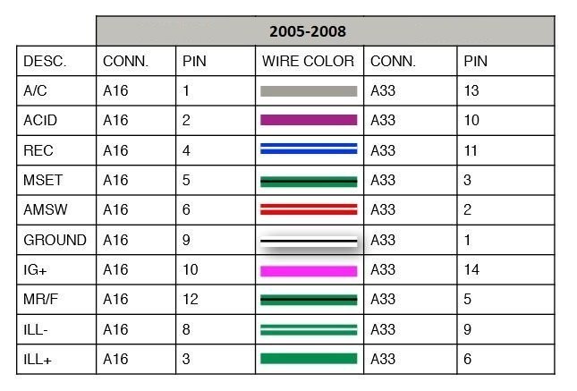

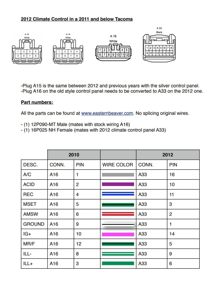

    Building the harness might be the easiest way but you would have to research the male and femLe connectors and pins. If you find a reliable source and the two wiring schematics post it, i am interested in collaborating but i have to finish the suspension issue right now

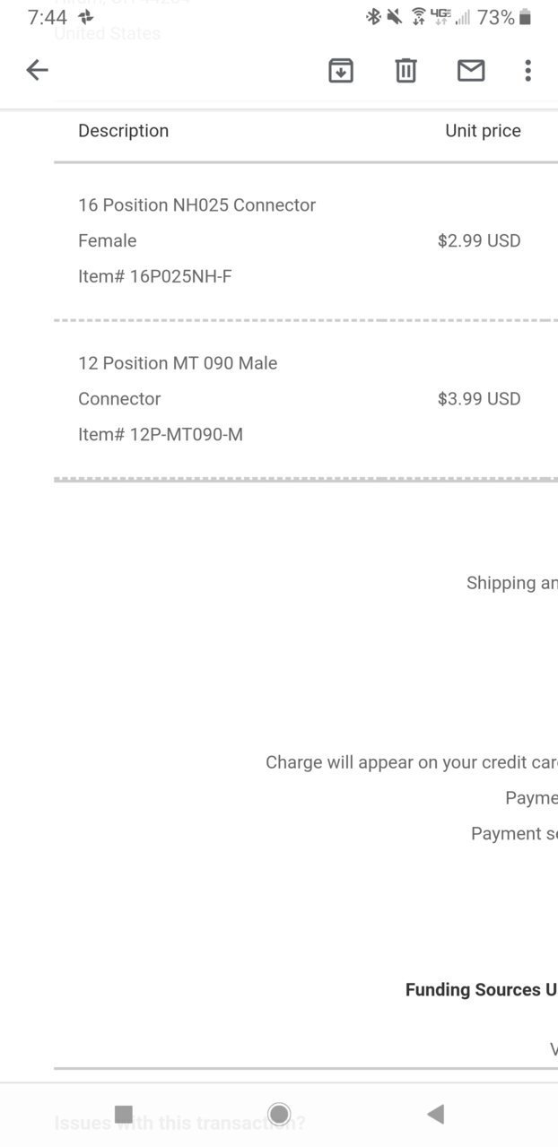

    Not sure yet, a fellow member and I collaborating on a couple harnesses for our trucks. I believe with both connectors (which comes with pins) is under $12s not including wires or shipping costs. Once we figure out what website we're going to use I'll post it up here asap. :thumbsup:

    Haha I feel like we do, it all comes down to making the harnesses correctly. I'm going to try and order extra connections. :thumbsup:

    No need to wait for me, all the information is above. You can order the parts at your own leisure my friend :thumbsup:
