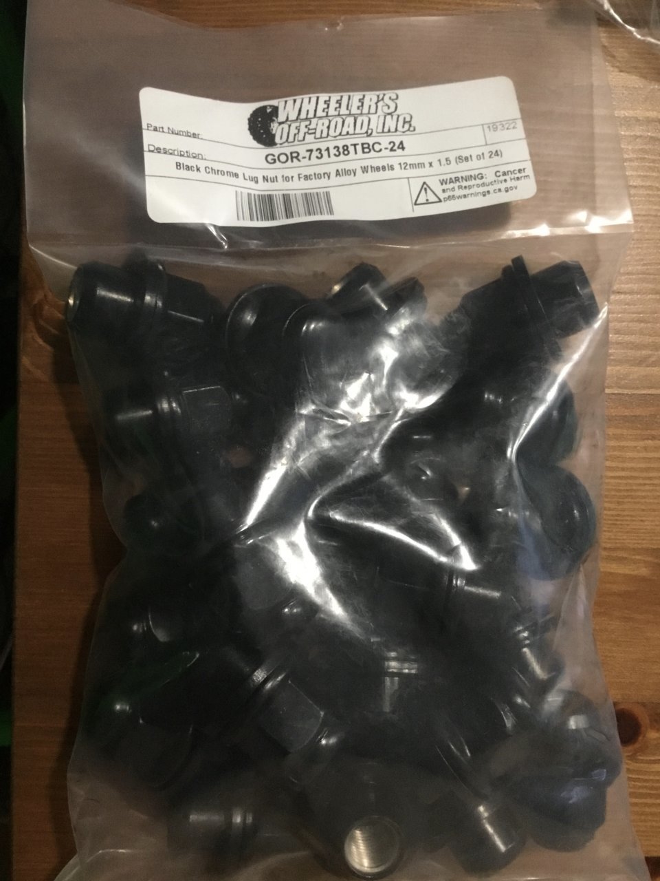

    I ordered Black Chrome Gorilla nuts for mine from Wheelers Off-Road...

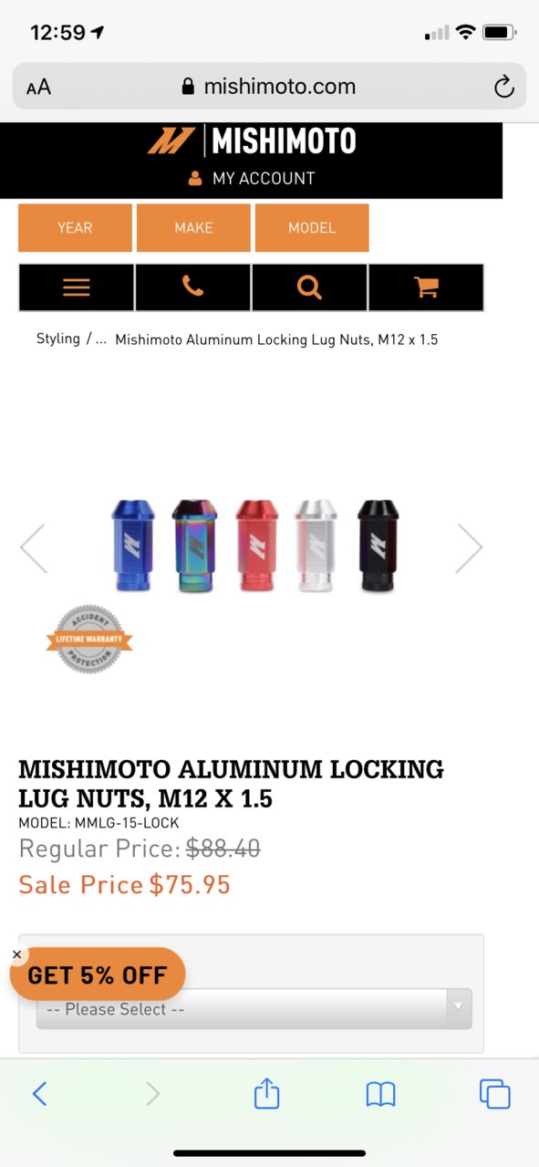

    Hi I am new to these forums as well as the Tacoma side. Loving this side btw. I was following these threads over the last couple of weeks as I want to pro my OR out a little. I just bought the wheels and center caps this morning. I too am looking for the lug nuts. As nice as these wheels are going to look I would really like the lug nuts to be a little different and I won’t have to wait on the black ones. Maybe you experts can help and tell me the size of the lugs if you know and if something like these would work?980DFB20-4CEB-4786-9839-64F4B9F4B90F.jpg

    Those won’t work on the OEM Pro wheels, they need to have the flat seat with a washer like OEM lugs do. The ones you posted would be for aftermarket wheels.

    Thanks Sub_Par. Just trying to see what my options are for multi colored lugs if that is even a thing?

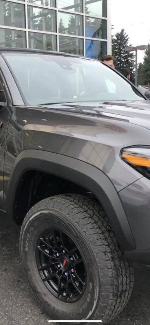

    I noticed the pro wheels having these multicolored lug nuts on wheels at the dealership and now looking at someone else’s pro I saw that they aren’t black, rather multicolored.

    Not multicolored, they are chrome plated and what your seeing is paint from the factory. They mark the lugs and bolts one they’ve been torqued to spec so they know it’s been done. It’s a quality control thing that the factory does.
