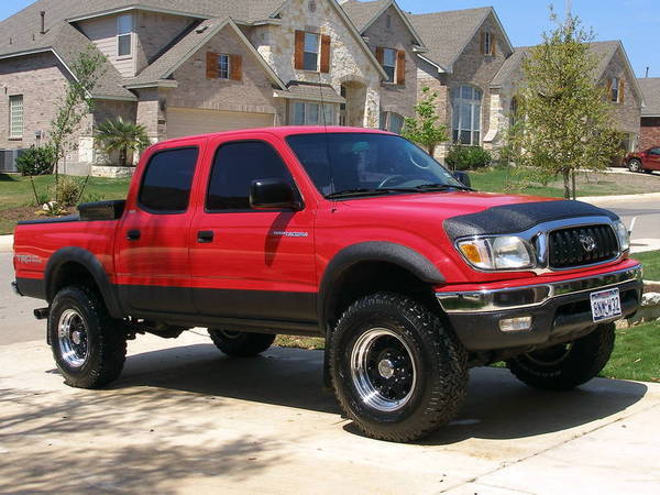

    After 100's of applications of armorall etc. I had them Extreme Line X'd when I did the rest of the truck. No more fade. The extreme is the new product.

    Damn!!! I wonder what it would cost to just have my flares sprayed with the Line-X.

    that looks k:)iller man. one of the best looking first gens i have seen. the line-x looks rugged as hell on there too.

    Durability should be good, on my old 96 the one place Line X can't hold up is sliders, but for fenders, brobably do just fine.
    If you carry in the flares I'd guess $150

    Appreciate that, this look is something I had in my head for a long time before I finally put the money down and did it. The wheels were actually my second after market set, my first MB's Chrome and Alluminum just never looked right. The hood was done to lay out the same as a Magna Bra which I previously had, they added the bit above the side lights to tie it all together. This is my 4th Toy, my 2nd Tacoma, unles a time comes that I need a heavy hauler, I'll stick with a Tacoma.

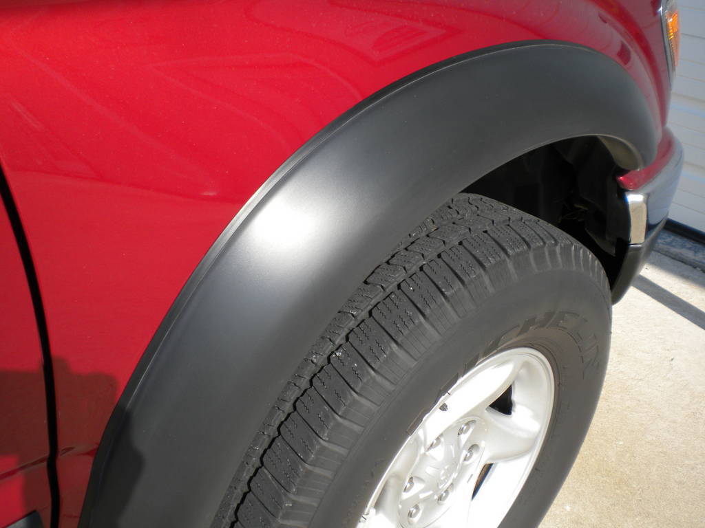

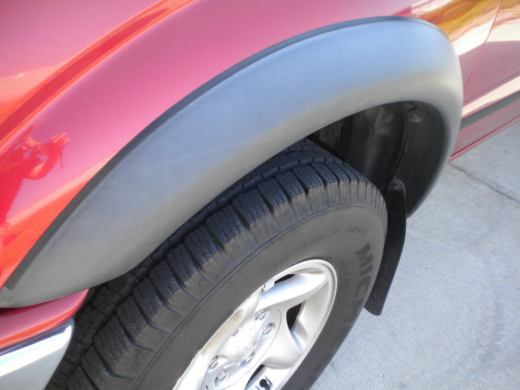

    Check out the wonders of the Magic Eraser! A pack of four cost me about about $5.00. This project took me all of about 10 minutes last night and I only used one Magic Eraser. I'm going to hit it a few more times for good measure, you can still see some "grey" around the seal.
    Faded Grey Fender Flare BEFORE The Magic Eraser.
    Restored Black Fender Flare AFTER The Magic Eraser.
    The AFTER picture of the flare does not have any "store bought" shine enhancing product applied (Black Magic, Back to Black, 303 ect.). The Magic Eraser is slightly abrasive, and removes the built up wax and oxidation that causes our flares to become grey over time. It also worked wonders on my unpainted door handles and my "faded" lower bumper as well. I may follow up with some 303 on there for good measure, but I was impressed with the result regardless.
