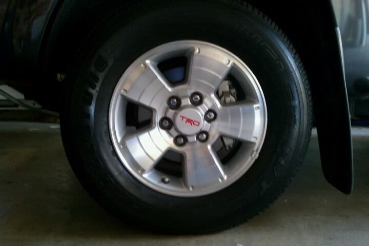

    Here's mine

    Got mine in silver...
