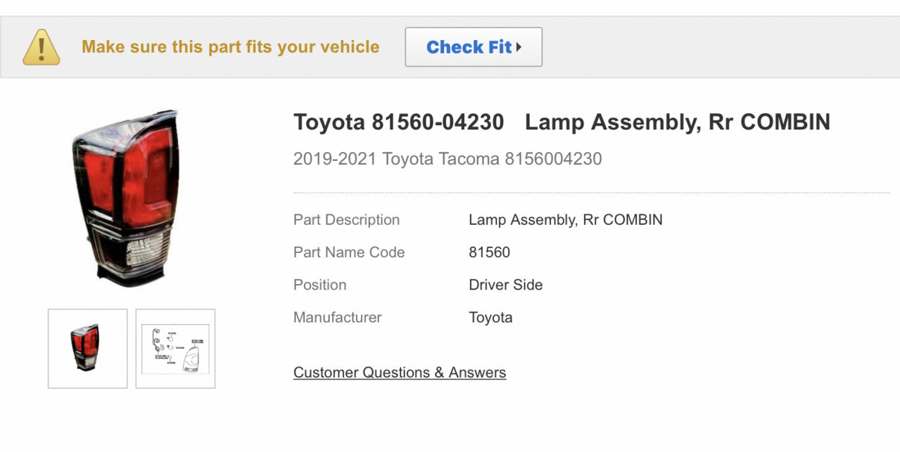

    I got the OEM TRD PRO tail lights and I love them , is there a projection headlight blacked out ? I found some 1200$ ones but I kind of want OEM , THX C88A54B1-7E41-4E20-B7B9-143FABAF5FA3.jpg
