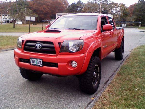

    jhodge83, u have a bad ass truck man. that thing is sick. those rockstars?

    looks good ill prolly do this
