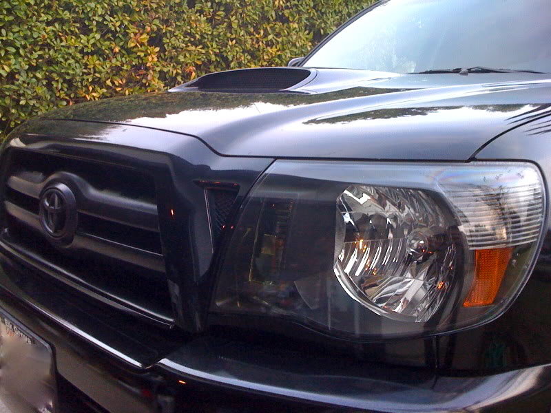

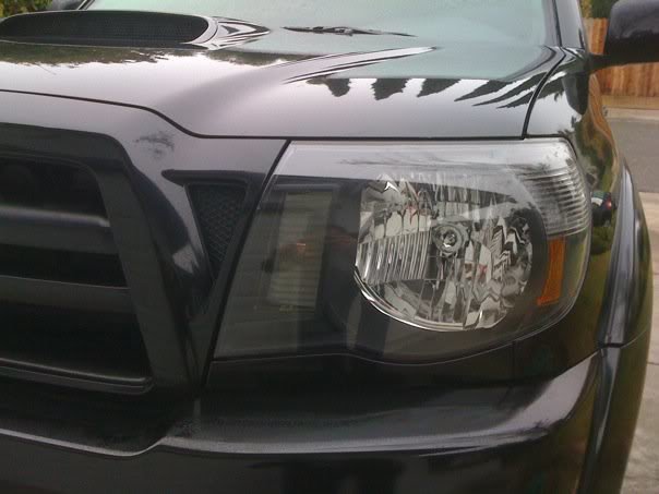

    Here are my pics. I finished last night and was to lazy to upload pics. I would say the hardest part was pulling apart the headlights after they came out of the oven. I heated the oven up to 300 and let the first one sit for 10 mins, then put back in for 5. The second one only needed 10 mins.
    Like everyone said, it did take some time, but I am very happy with the results. If anyone has any questions let me know.
