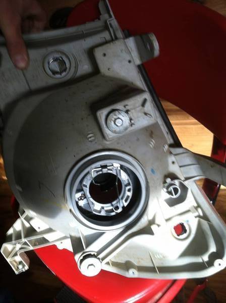

    Dores this look ready for oven? I removed 3 bulbs 3 screws and 3 rubber pieces. just want to make sure. Thanks!

    From what i see... Yes

    its in now so hopefully. Ive read up on this a ton and I still wasn't sure once I started doing it.

    Yep, it looks like you are ready to go

    it all went well! I just did the chlm. Im going to let the sealant cure over night +since its snowing outside lol. Im in no rush. If you do your homework(read all the bhlm and chlm threads you can) its a piece of cake. I took info from all of them and sorta combined them. the 4th bolt is a piece of cake to remove( because I read all the info of other people struggling). when I resealed the HL, I put it together and put it in for 5 min. took it out and tightened down the screws and squeezed it together the best I could. then I put it back in for 5 more min to remold since it was tightened down. then I removed it, clamped it and gave the screws a tiny turn more. after it cooled, I applied Loctite polyseamseal rainguard to the seam for "piece of mind". well see what happens down the road.
