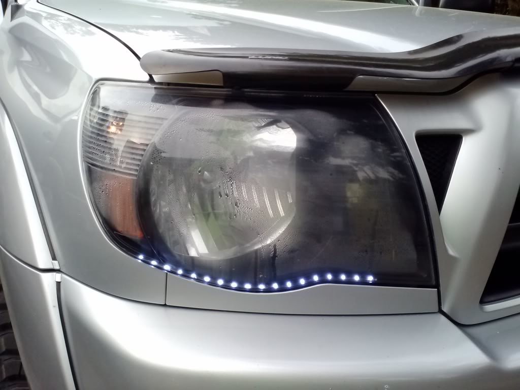

    My turned out nicely, it's been a few weeks now, but my left headlight lense has that oil in water colour on it.
    Anyone run into this before?

    Yes, it looks its running down my headlight too.

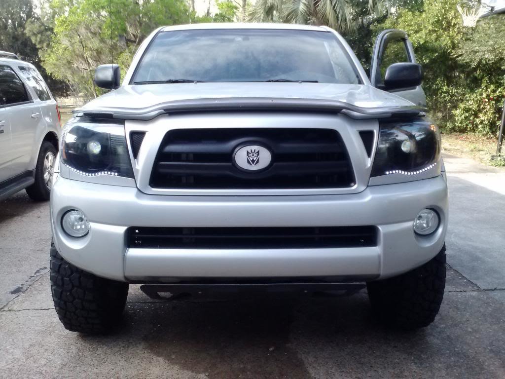

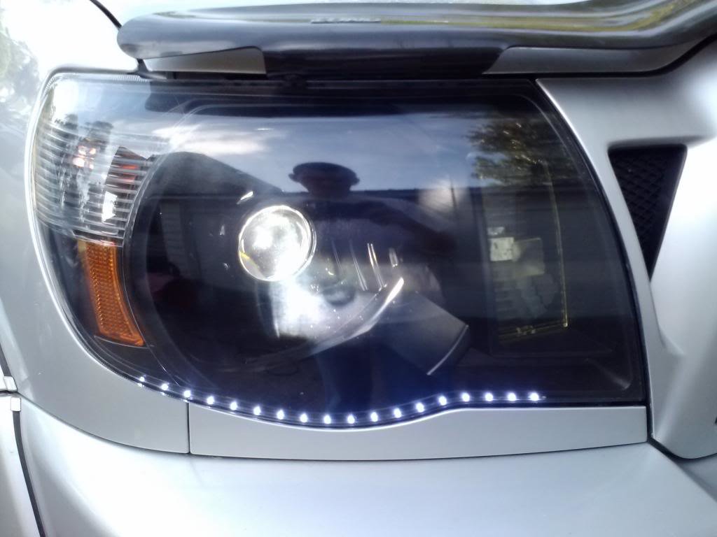

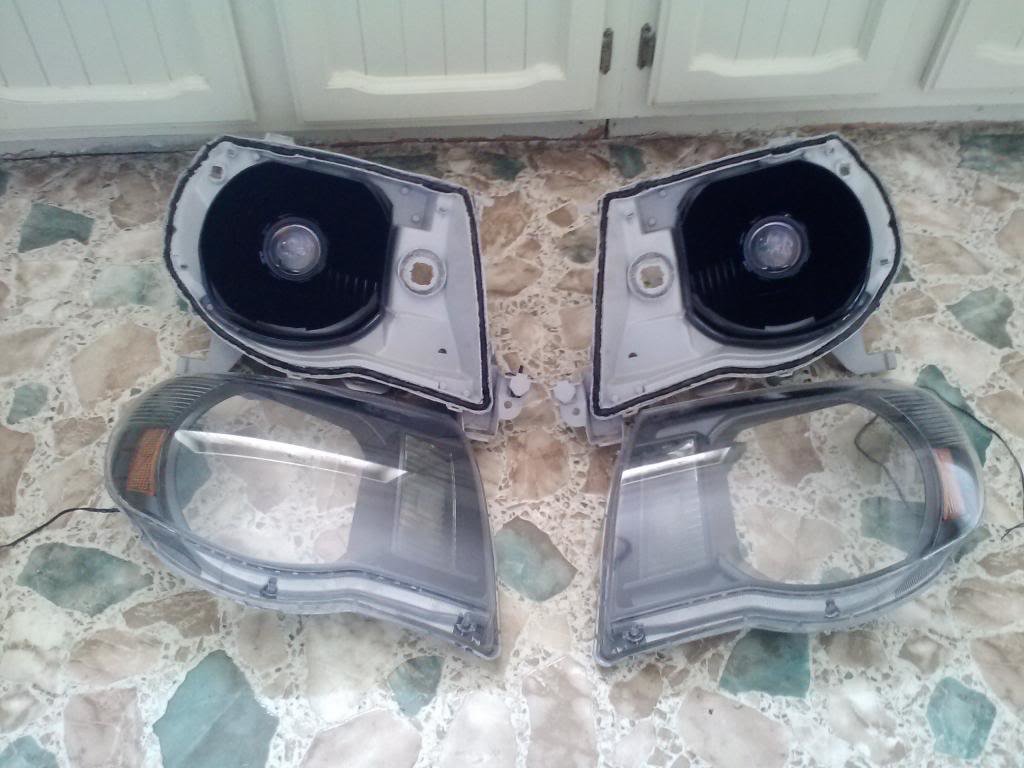

    what did you use to seal it back up?
    my first go-around left me with a similar outcome with both lights because I used some cheap house window sealant stuff... big mistake...
    not to mention a BAD moister problem with my right headlight
    about a week after that photo though I completely cured the problem by getting the RIGHT sealant, and while I had the lights opened up AGAIN, went ahead and did a full blackout and threw some HID projectors in them too :D problem solved; not a hint of moister or discoloring since
    I just gotta do something about those dang fog lights though...
    If anybody is contemplating HID projectors, my suggestion is DO IT! ESPECIALLY if you live out in the country and have to drive through the woods on 2 lane highways often at night... the light out put is RIDICULOUS compared to the factory setup, in a good way. I'm impressed with them every time I drive at night. I went with the Morimoto Mini H1's; super easy install and well worth the money. Running 6000k bulbs; great light output, and just enough hint of blue to look fancy ;)
