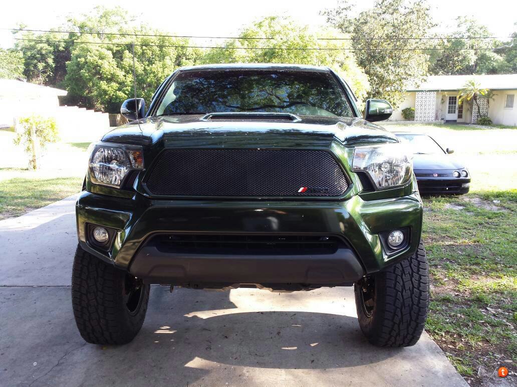

    Thanks. It turned out pretty good. Thanks to this thread! Haha. I did use a green scrub pad to scuff the chrome. No runs and looks like it came from factory that way. Pre-heated oven to 300* and put in for 8 minutes (oven off). Then 200* and 2 minutes for reassembly (oven off). Now i just hope it doesn't fog up in the future.

    Looks great! Good job.

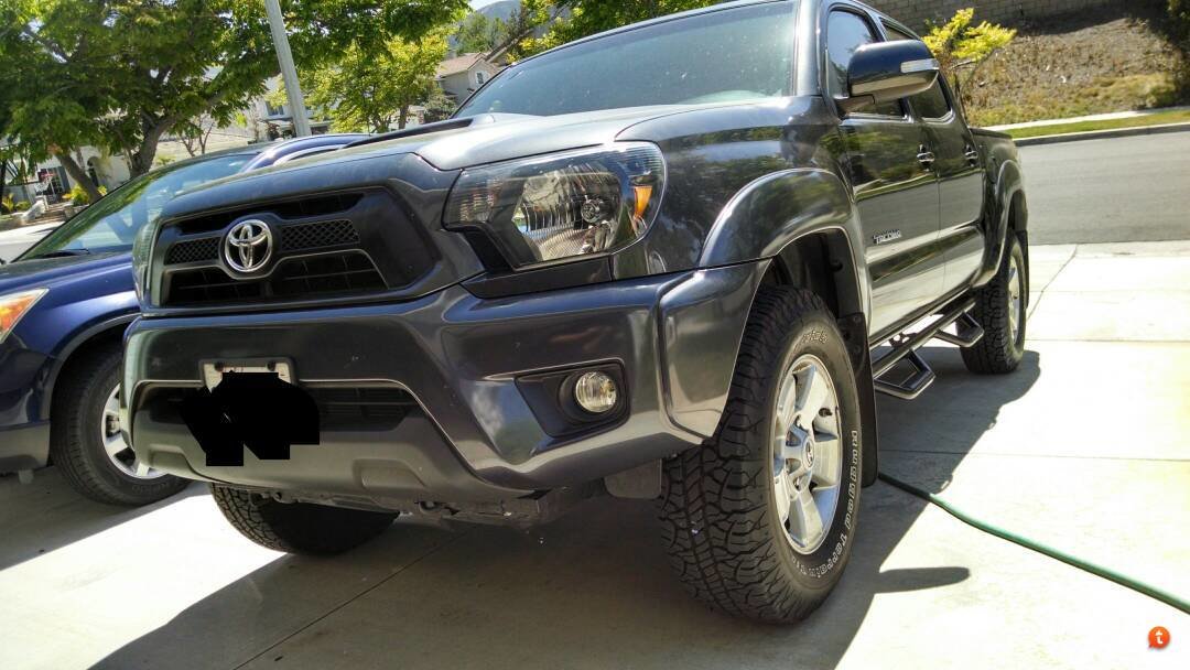

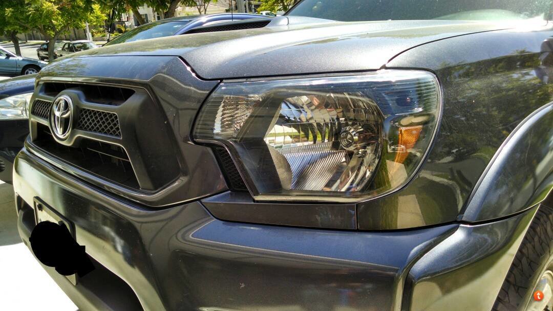

    So it took from 10 till 2. Definitely worth it. I was scared about melting it. 8 min at 300. Perfect!
