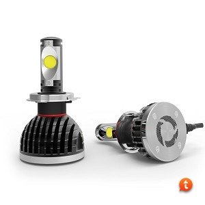

    Correct. That have a small fan built in the back for regulating heat so I had to take off the metal part that makes the bulb stay put. Then put the rubber ring over the actual bulb, then screw the metal part on again. It was a pain to do but it looks pretty secure.

    The back part of the bulbs might be a little fatter. Here is the stock photo. It was impossible to slide it over the back part. I should have installed it with the headlight assembly off. Sorry to go off topic there. Back to the BHLM, still love them. No condensation so far, but it's 100 degrees and dry.

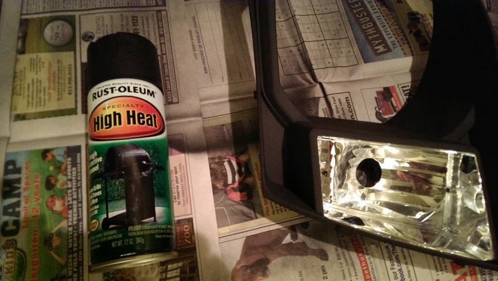

    I did not spray the reflective areas of the bulbs. I also used paint that is resistant to high temps.:)[​IMG]

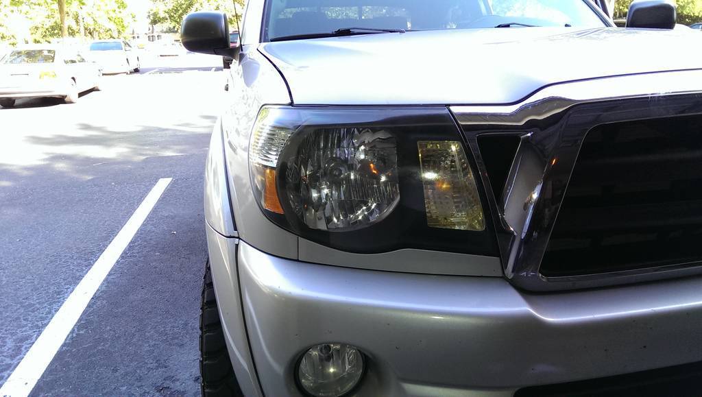

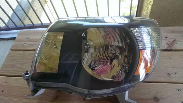

    If I had to do it different, I would have used high gloss instead of flat black.[​IMG][​IMG]
