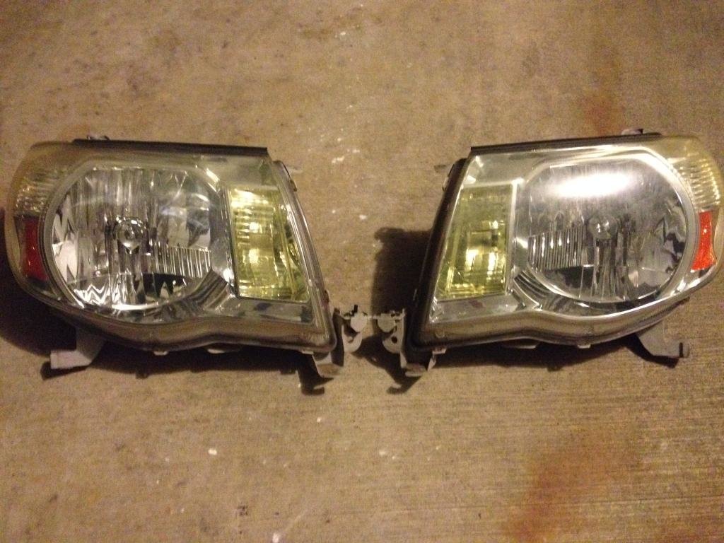

    I picked these up off CL to do the BHLM.. They are off of a 2006 tacoma and are in pretty good shape.. The lens needs to get buffed up a little but other than that they are good. I was wondering if I should tint the dtrl lens because I am not sure how the yellow will look after doing the mod. I know I want to leave out the side markers. Was wondering what people did to tint their dtrl lenses and if they will be affected by the heat of the dtrl bulbs?

    Hey what did you end up doing with these? All I can say is I would be doing whatever needed to get rid of that yellow lol.

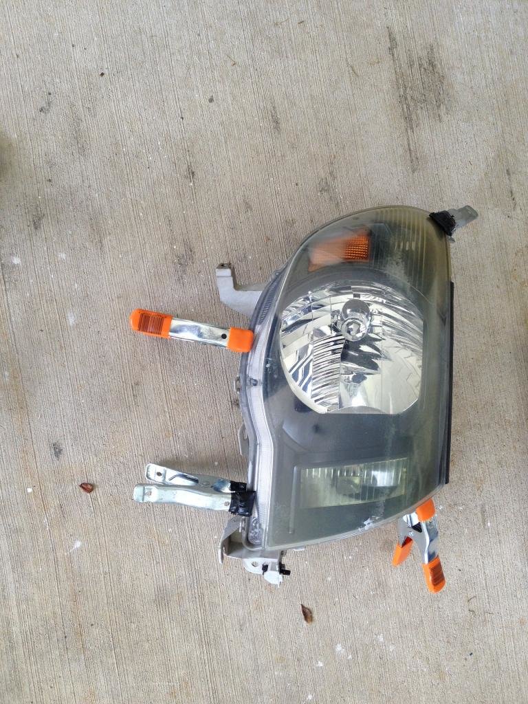

    I have these spare lights apart right now. The oven part was quite easy to do. So I am just taking my time prepping the bezels trying to sand it as much as possible. I think if I paint the turn signal reflector black the yellow lens shouldn't be too noticeable. If it's bad I will tint the yellow lenses with some vht. I probably will have to disable the dtrl so the yellow lenses don't get burnt and crack. I am still debating if I should black out the orange reflector in the outside corner or just tint it a little bit.
    I have a brand new oem set on my truck because of the dtrl warranty extension and they have clear turn signal lenses that would be awesome to use for bhlm but I want to wait on doing anything to them for awhile. Just keeping them as an extra set after I put the bhlm ones in.

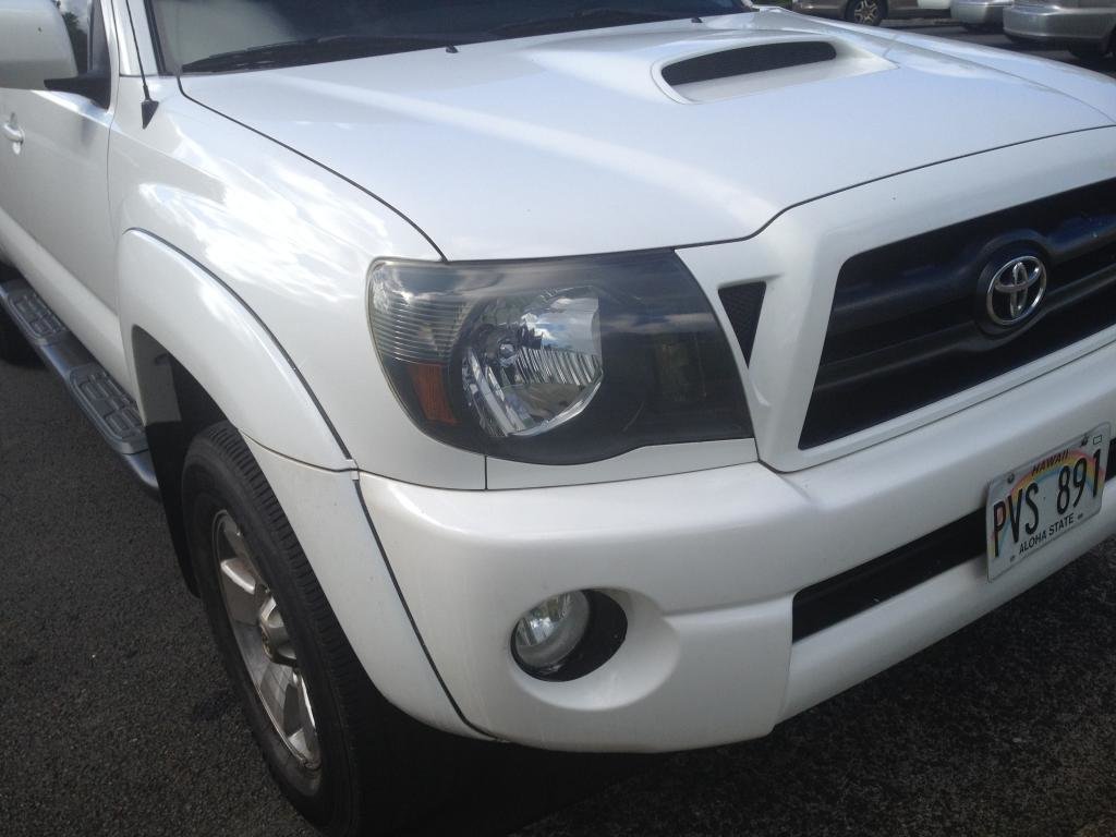

    08 PreRunner Sport
    Got the BHLM done. I ended up blacking out the whole bezel and not painting or tinting any of the yellow lenses and orange reflectors. I also used a couple of tubes of black gasket maker to make sure moisture stays out.
