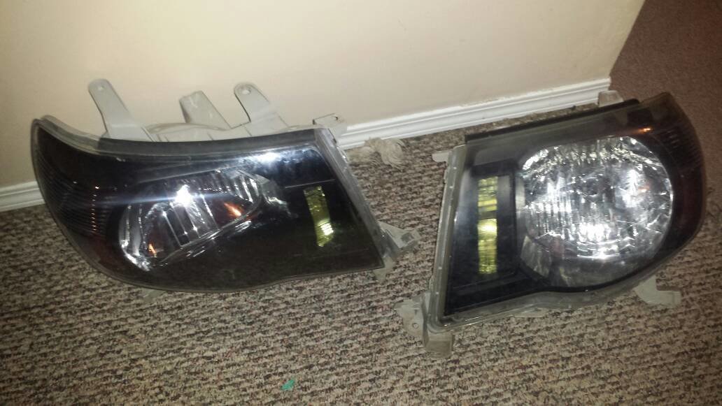

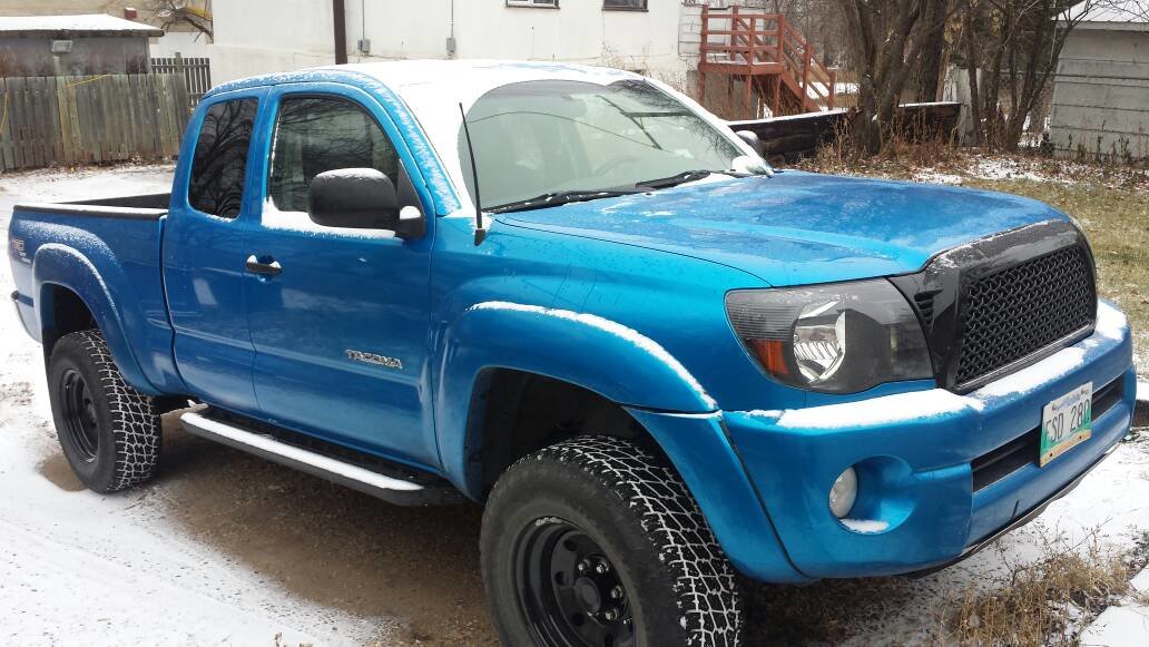

    Here's my completed set, turned out great in my opinion. Too me a whole two days to do with drying time tho.

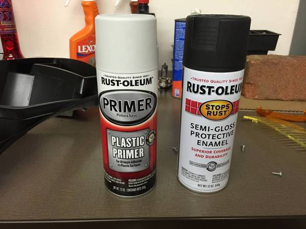

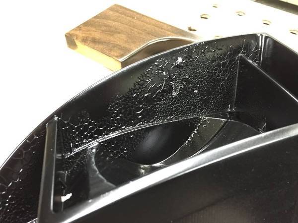

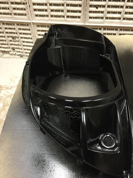

    Ok guys so I done effed up and I don't know how! I tried to be very meticulous about this. My paint is bubbling and I don't know why. Here's what I did:
    I got everything pulled apart smoothly.
    I then sanded the easy to get to areas with 400 grit, the rest I didn't bother with because so many people don't even sand at all.
    I then blew them off with my air compressor.
    Then I made sure I got all the remaining dust and any oils by wiping it down with denatured alcohol.
    I let it dry for around 10 min and then I primered 1 coat with Rustoleum Plastic Primer.
    I let that dry for about 16 hours (the primer was beautiful and smooth) and then I sprayed one light-ish coat of Rustoleum Semi-Gloss Protective Enamel in the spray booth with the fan on.
    Almost immediately it started to crackle :confused: I have no idea what I did wrong!! I tried sanding it down and tried again and it immediately started to peel again. WTF?! Does anyone have any ideas?? I really want my taco back I'm driving a jeep wrangler with chrome wheels :(

    Thats looks bad man. Really bad. Is that Paint made for plastic? I really dont know. Hope somebody can help out.

    Yeah Man. I would have used the rustoleum plastic paint with the plastic primer..

    I did a very quick sanding job on mine, no primer and used plasti dip. Maybe 3 coats, came out great, maybe you got a bogus can of paint Dakota?

    Shit. On the back it said it works with most enamels but it sounds like I shouldn't have paired a metal paint with a plastic primer.
    Hmm. I'm thinking of taking everything off and skipping the primer. Maybe I'll use Krylon fusion because everyone else seems to be happy with it.
