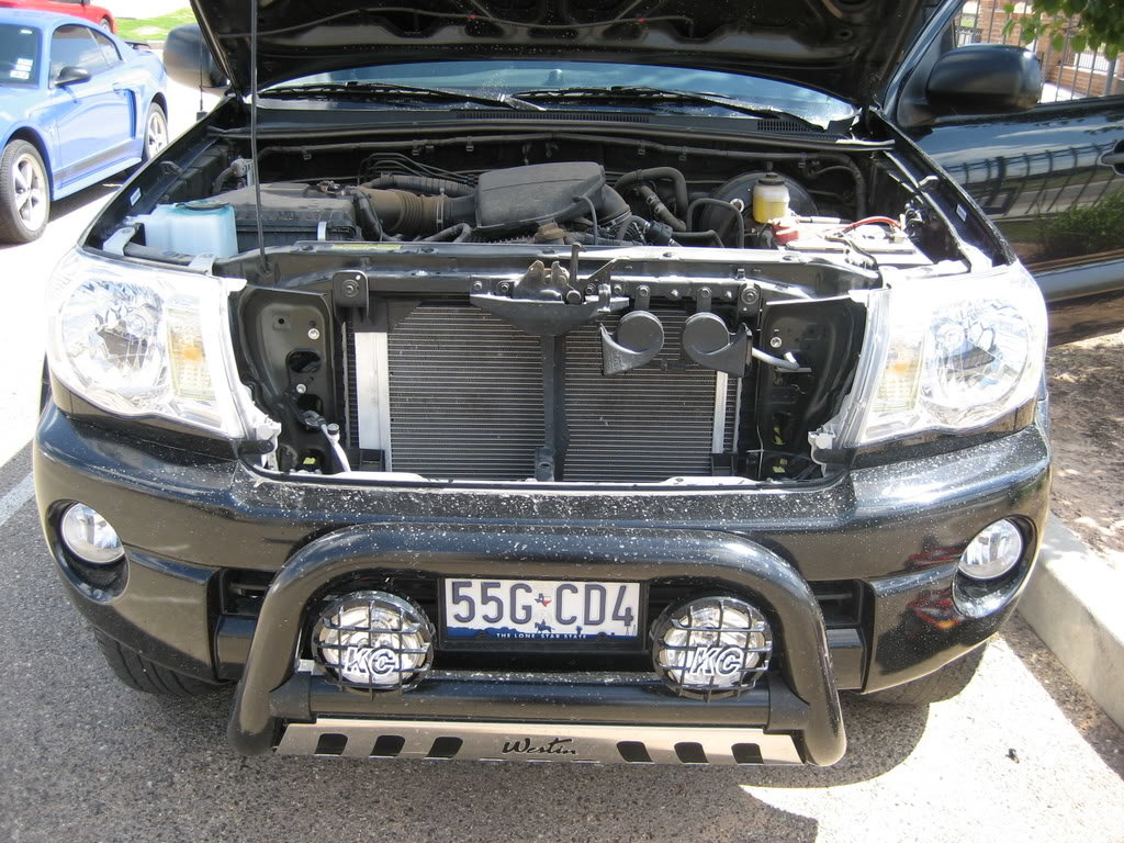

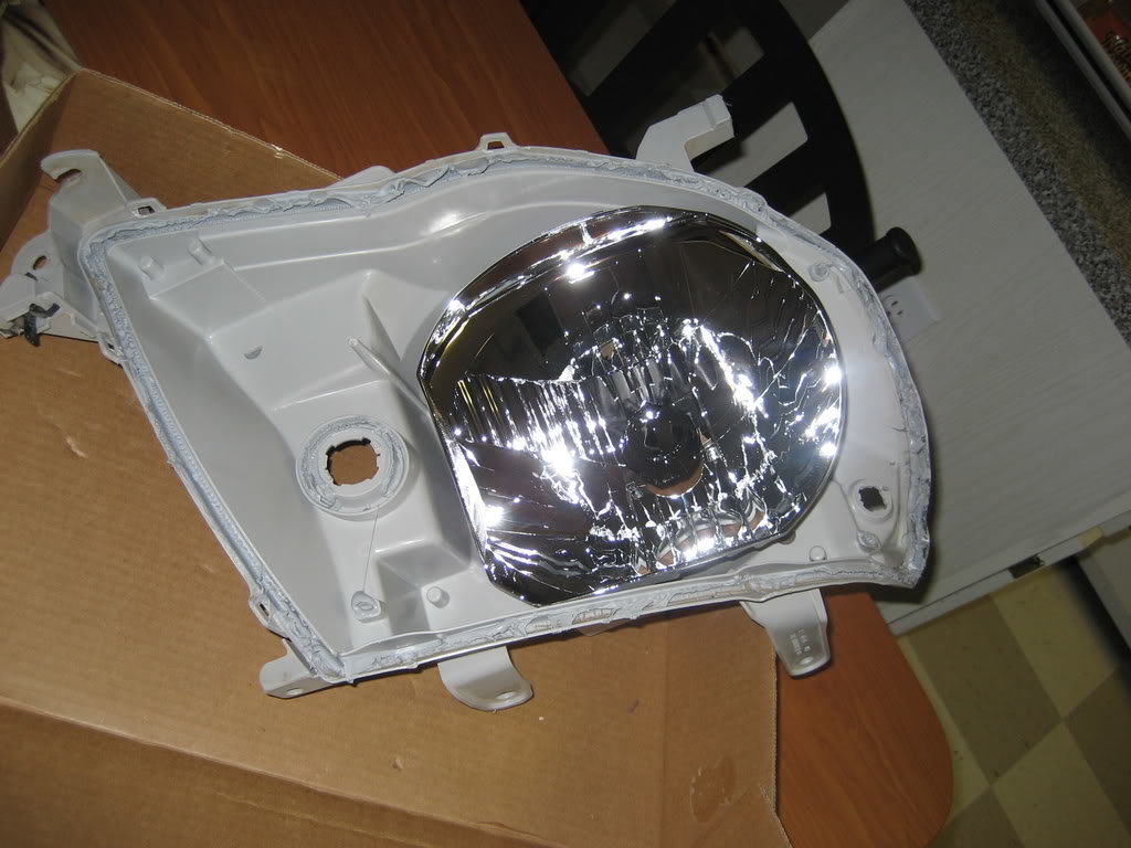

    Just finished tearing my headlights apart. Took a lot of pullin and tuggin but it eventually submitted to my will. I had to put it back in the oven twice for 5 mins. As of right now the paint is drying. I'll post pics of the install in a few.

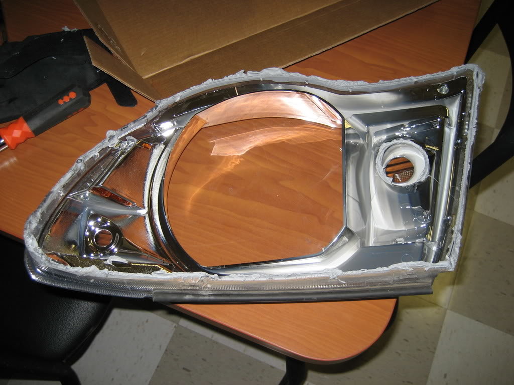

    Black Head Light Mod, Tacoma All Weather Mats, ScanGauge II, Tonnaeu Bed Cover, 40% Tint, Added Fog Lights, 600W x 1 Alpine MRP-M650 Amp, Alpine 10" Type-R SWR-1022D Sub, Secondary Air Filter Removed, Day Time Running Lights, K&N Drop In Air Filter (oiled), Westin Bullbar (Black Powder), Alpine IVA-W505 w/Nav, JL Audio 6.5" Front Speakers, Toyota SR5 Seat Covers, 2.5" Toytec Spacer

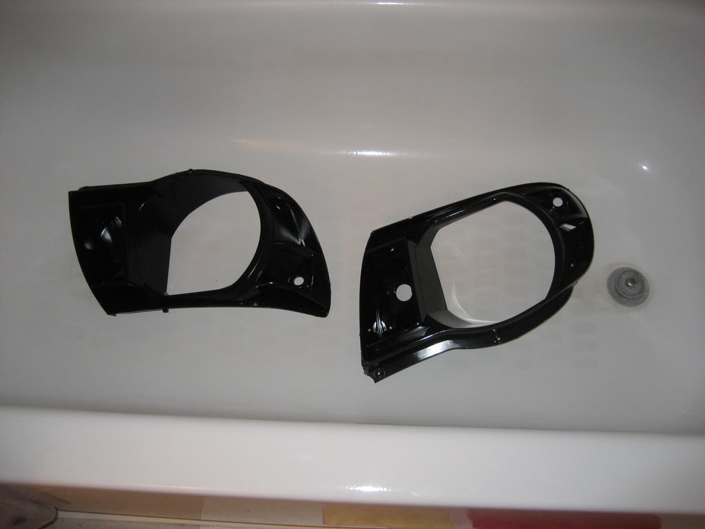

    Here of some pics. The paint is still drying. I plan on putting them back together tomorrow.

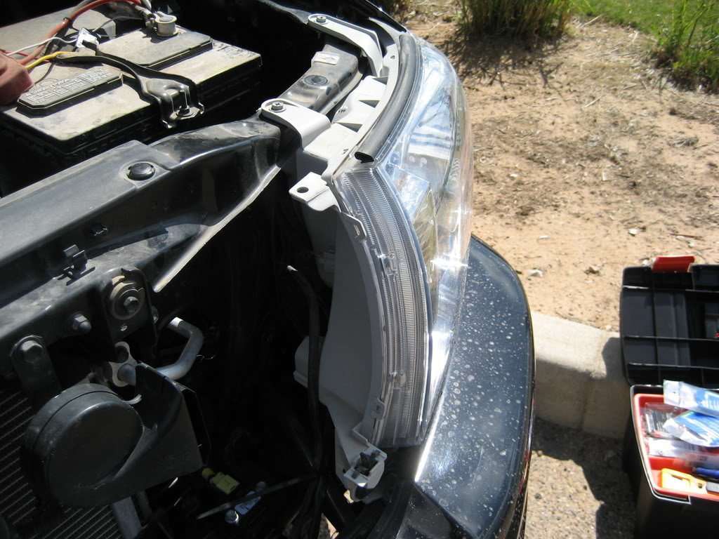

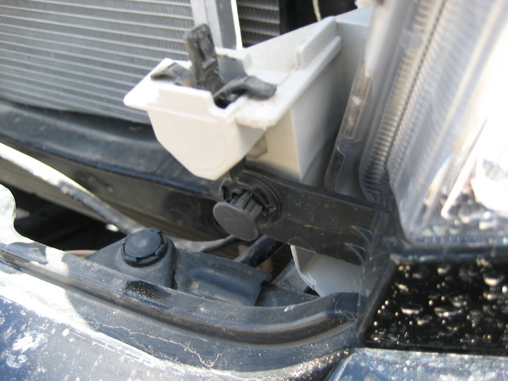

    Finished my blacked out headlights yesterday and I have to say that I definantly love it a lot more.

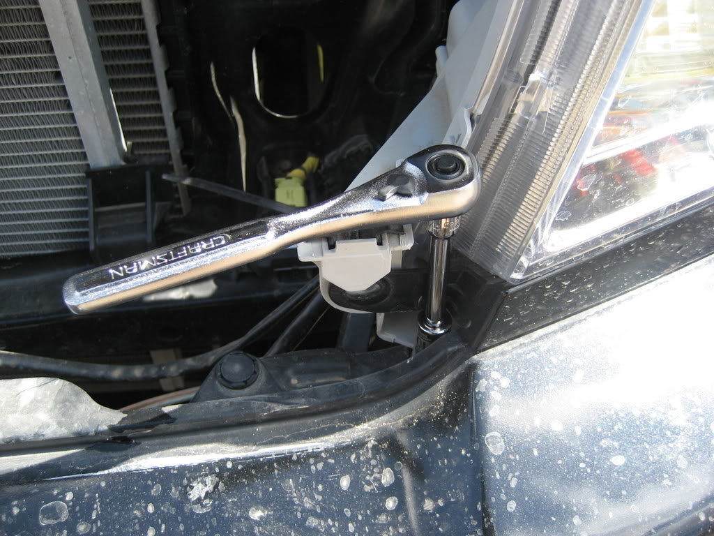

    One thing to note to people who are going to do this. Be careful where you get the glue. When it gets hot its almost like hot glue and will get everywhere. If it gets on the clear plastic part of the headlight it will be a bitch to get off. Just be careful and patient and everything and you will be fine.

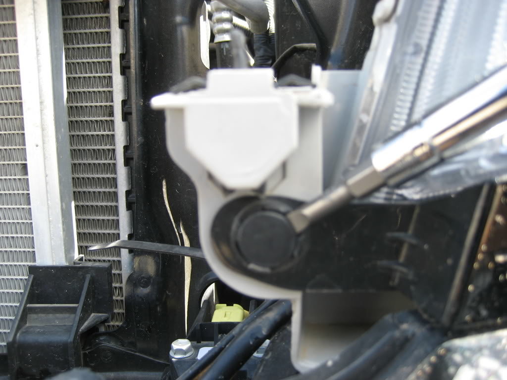

    It took me about an hour to figure out how to get the headlights out, but all but 15mins to put them back in. The only problem is getting to that 10mm bolt that is on the inside corner of the bumper by the fog light. I posted a picture of where it is just in case some are wondering what I'm talking about.

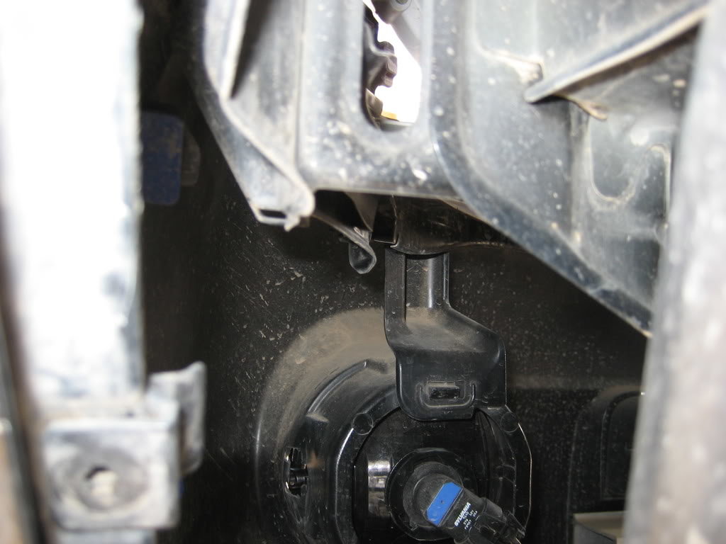

    Here's how I got to the small 10mm bolt. I just unscrewed 3 screws and took out 1 clip and pulled back the fender. The bolt is practically invisible so I had to use my hands to find it. The arrow points to where it is.
