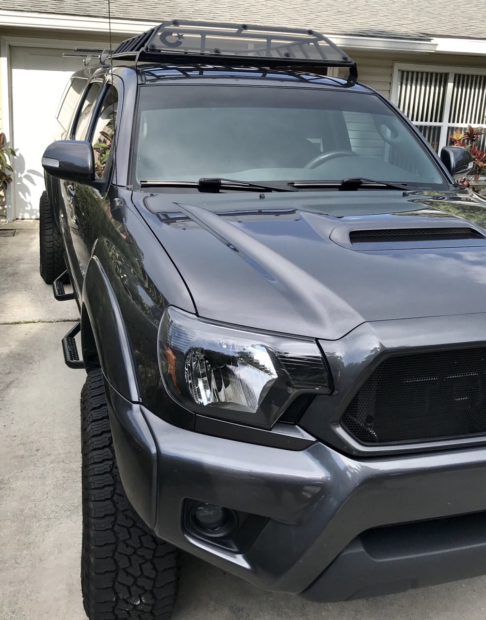

    Just did mine today, hell of a project doing the retrofit, but extremely happy with how it looks.

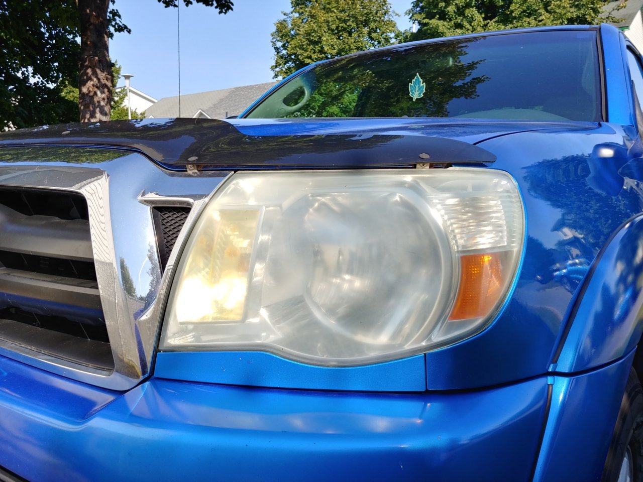

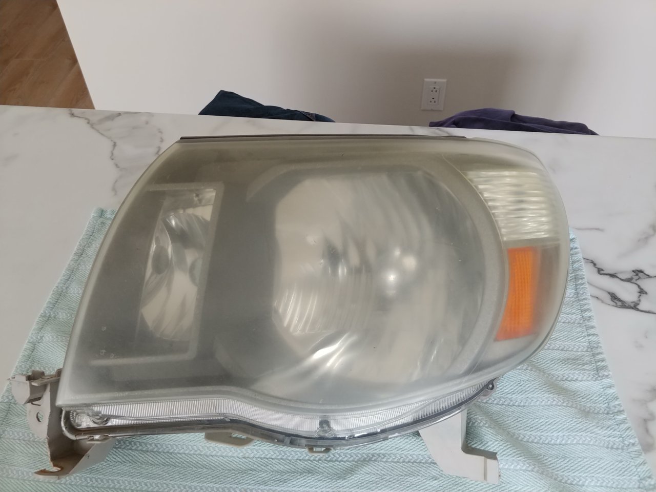

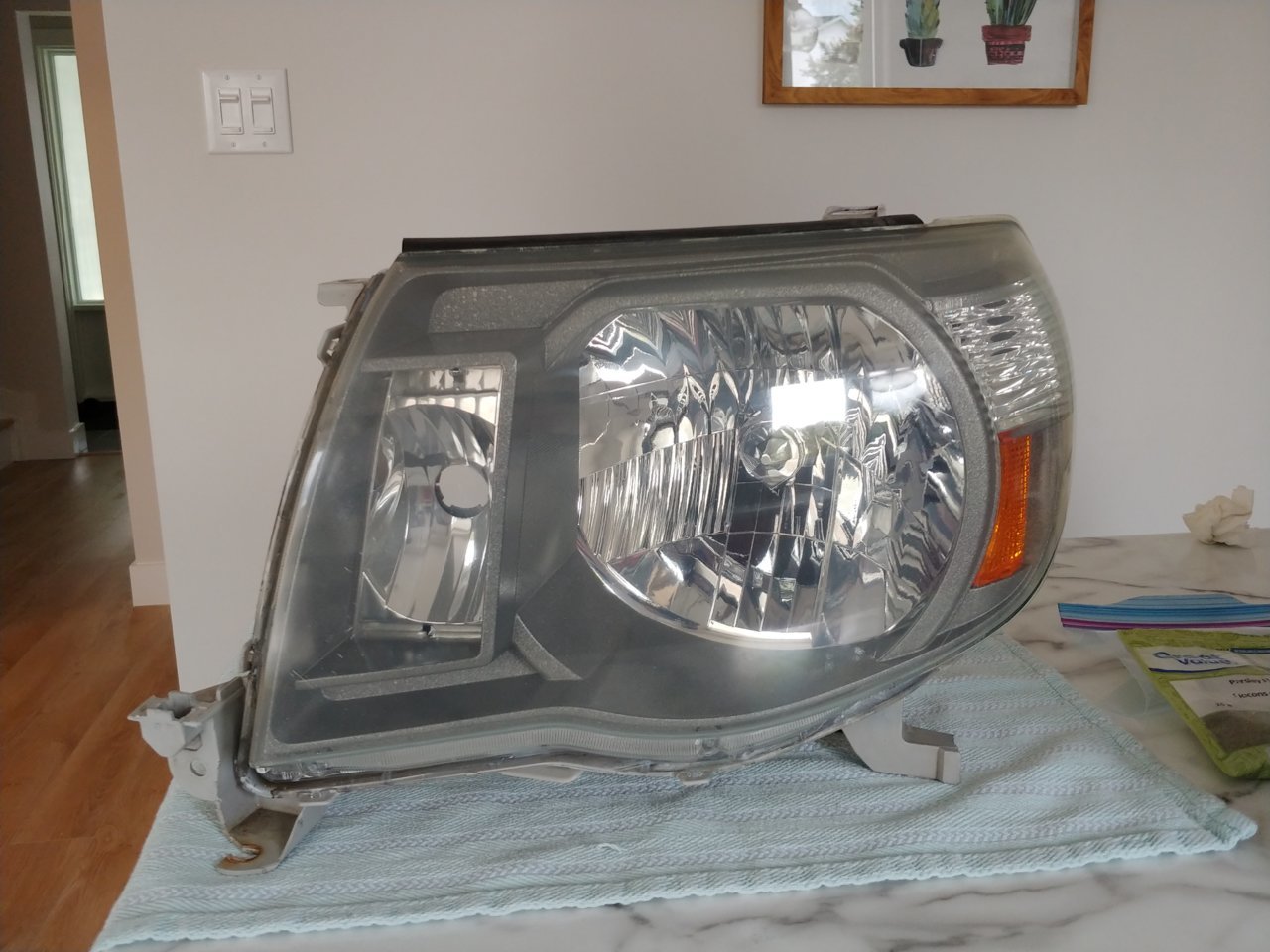

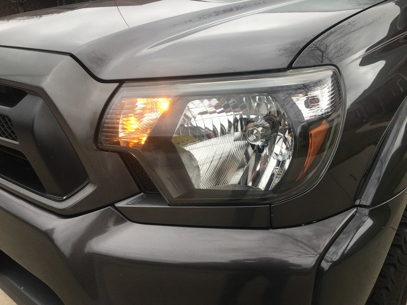

    Finished up my dark grey metallic headlight bezels. Also refinished the lenses. Might give the lenses one more round of polish then seal them.
    Step 1: wetsanded 2000 grit (drill pad)
    Step 2: wetsanded 3000 grit (drill pad)
    Step 3: wetsanded 4000 grit (drill pad)
    Step 4: meguiars M105 compound (porter cable polisher)
    Step 5: meguiars M205 compound (porter cable polisher)
    Step 6: Simoniz headlight restorer polish + wax (drill pad)

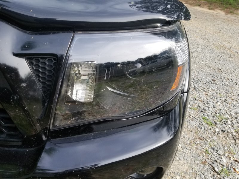

    Housings finished plus sanding/polish and a Spar Urethane + Mineral spirits for the sealer.

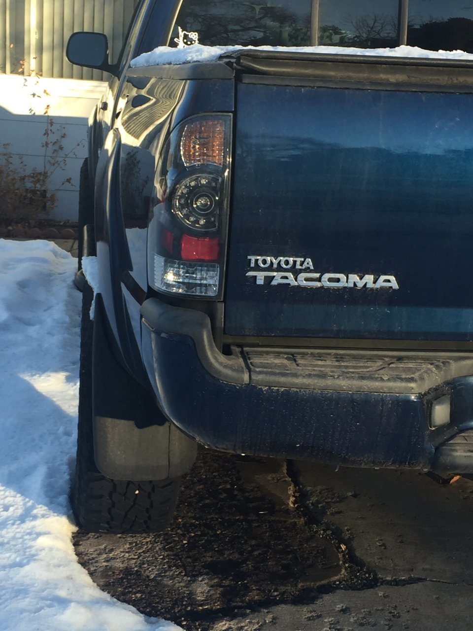

  17. Jan 13, 2019 at 4:57 AM
    #797
    SRH
    SRH My horns hold up my halo
    Jan 12, 2019
    #279020
    21,624
    Shauna
    2018 Sport
    I would like to see a picture
  18. Jan 13, 2019 at 2:59 PM
    #798
    303tacoma
    303tacoma Bad Karma is a Bitch
    Jan 19, 2014
    #121024
    10,978
    Rebecca
    Sw Denver Concrete Jungle
    2008 TRD AC 4th gen Rav4 Platinum
    ICONS Front & extended Rears DAKARS LR UCAS Wheelers Super Bumps F/R Homersoshi & Bumper insert, Ultra Gauge, Wet Okole seat covers, AFE air filter, Truxedo tonneau cover, LED White Cluster swap by yosh2000, Audio upgrade, ECGS Bushing, rcbs204 Lighted 4x4switch, Bullaculla trailer harness relocate bracket SOS Concepts IFS skid & sliders Anti- Dark RedLine Hood Struts Matt Gecko Bed Lights BHLM Depo Tailights Fog light anytime mod ABS cancel mod Rear diff breather mod Brake light 35watt mod Relentless u bolt flip Mobtown Recovery Bar Sound deadener doors rear wall
    Of the tail light?
