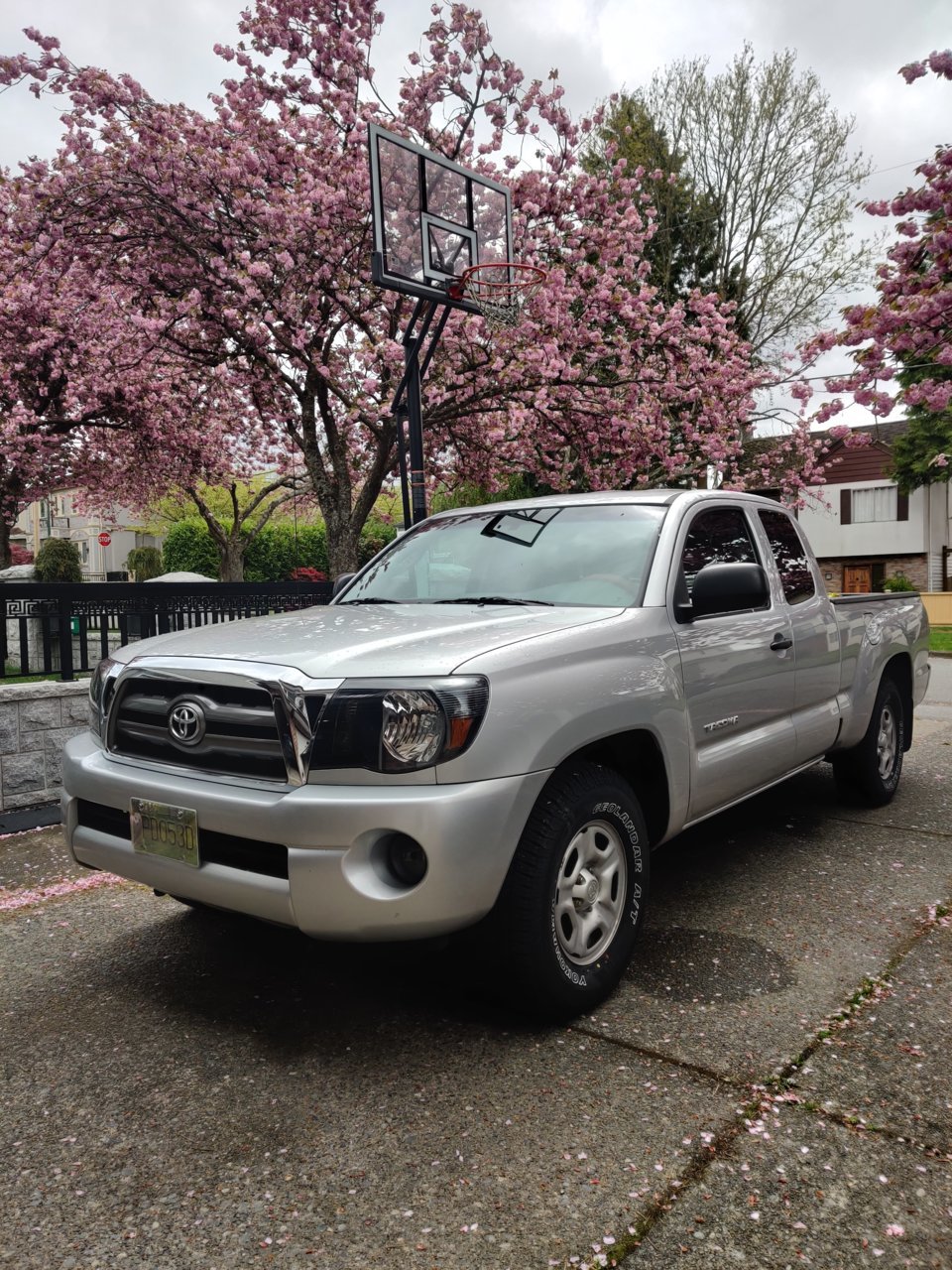

    Finally had time to do mine:D

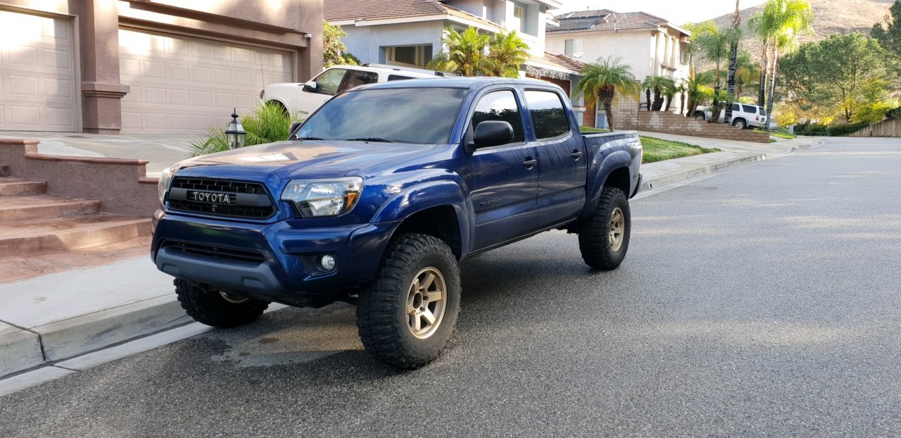

    4x4 Conversion 2.5 inch lifts with 33's Sliders Skids Front Runner racks Satoshi grill Patches and Stickers BAMF hybrid front HC tube rear Light bar 2 Hella's behind the grill Pioneer media player and subs Sleeping platform with lower storage for the bed
    I blacked out the whole bezel. I wanted as much black as possible. I ditched the yellow blinker lense, but I kept the orange reflector because I think it is a legal requirement. The only thing I would have done differently is masked off the turn signal reflector and fogged the turn signal lense. Then it would keep the light out put and look black when it's off I think. As long as my headlights and high beams are bright and the other two lights put out amber light I'm good with it. Especially because I made it through some rain without any moisture in my lenses.

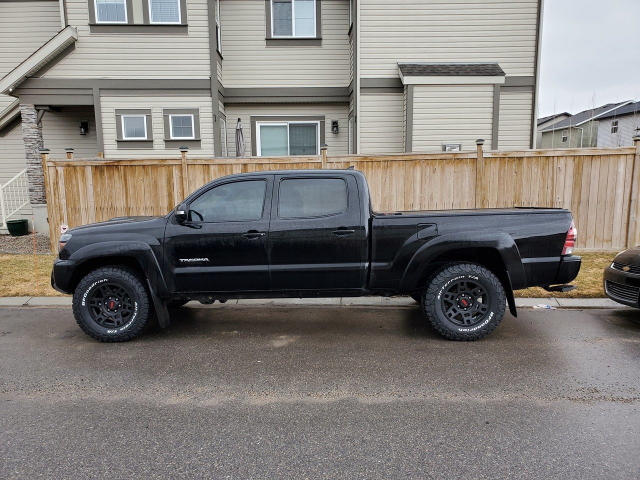

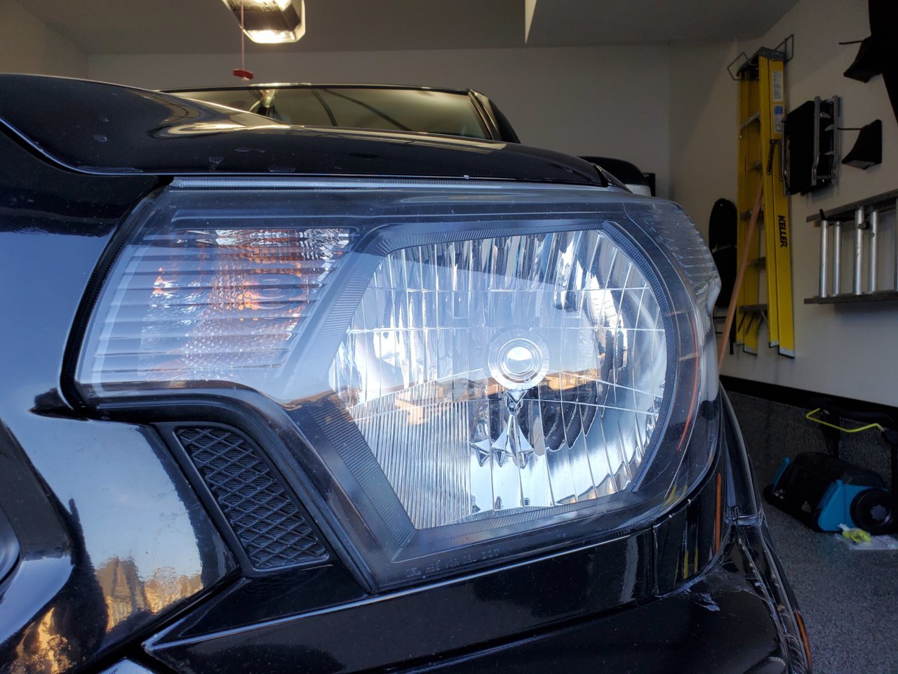

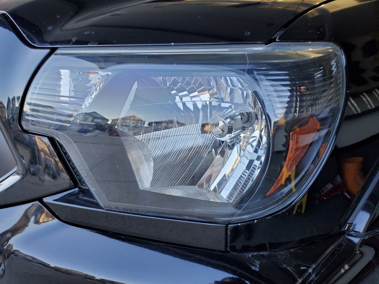

    This picture is from this afternoon before I put my new wheels on:
    Side angle with new wheels:
    Close ups:

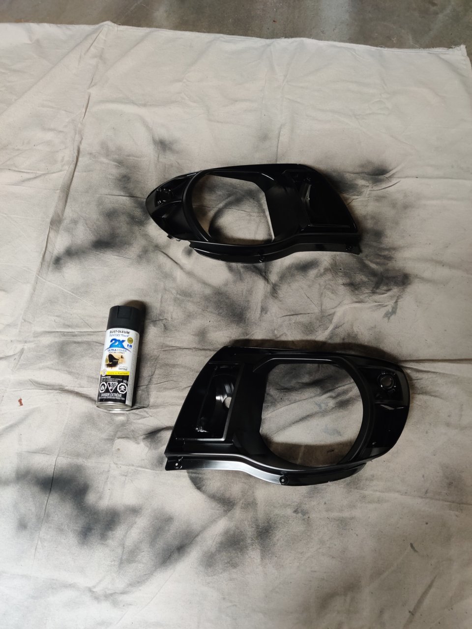

    Thank you OP. I used Rust-Oleum Painters Touch Satin Black.
