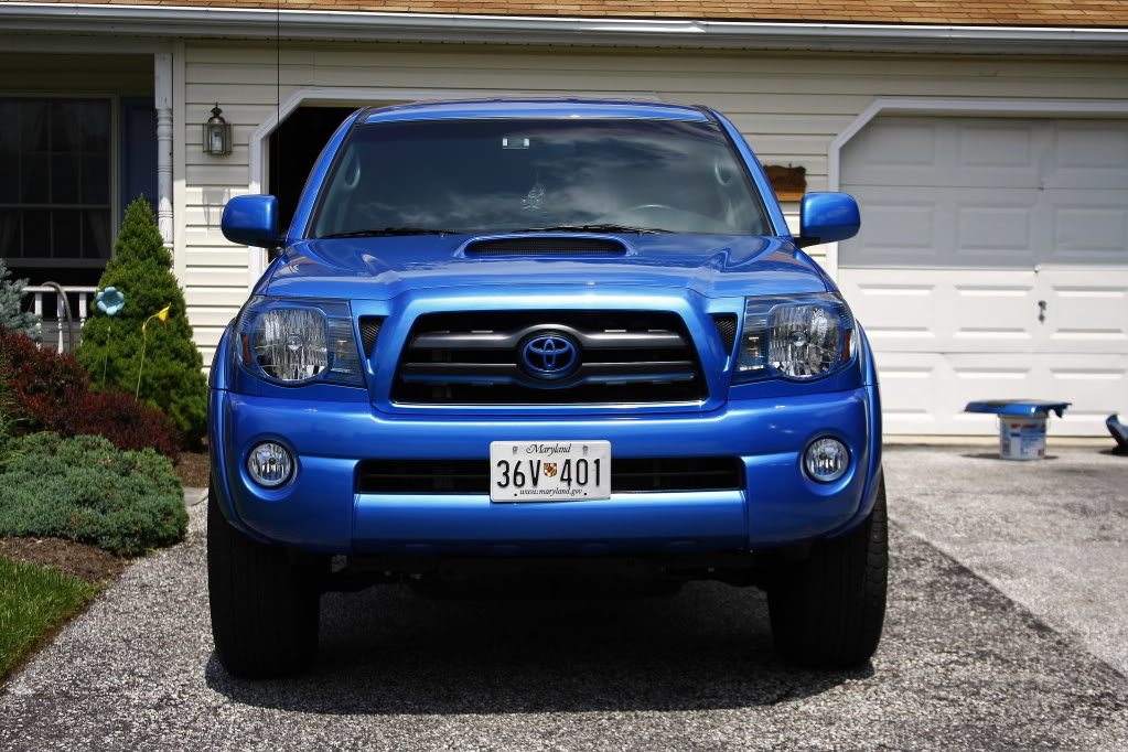

    I just finished mine a few minutes ago. Took a total of about 6 hours.
    I painted mine to match my paint instead of painting them black...... Speedway Blue..... It looks awesome. Can't wait to post some pics of all my recent mods.

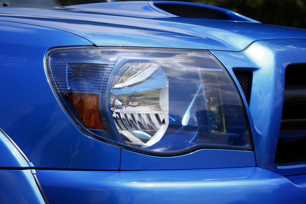

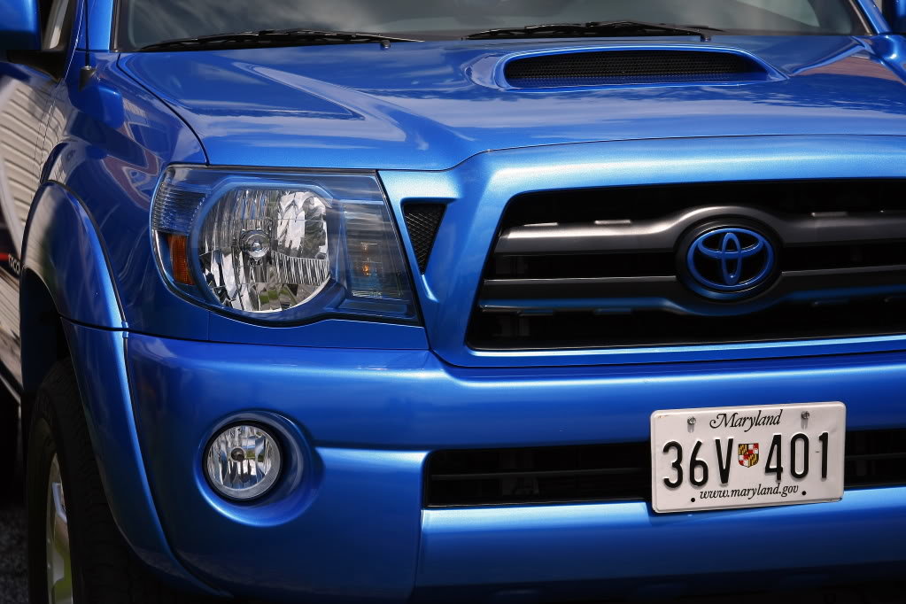

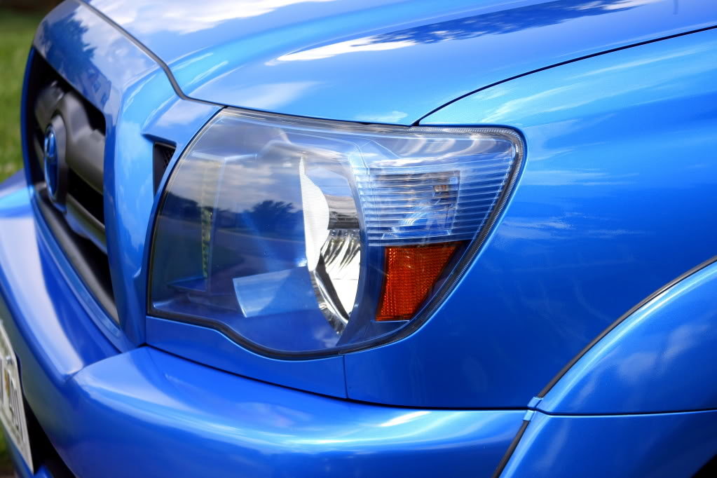

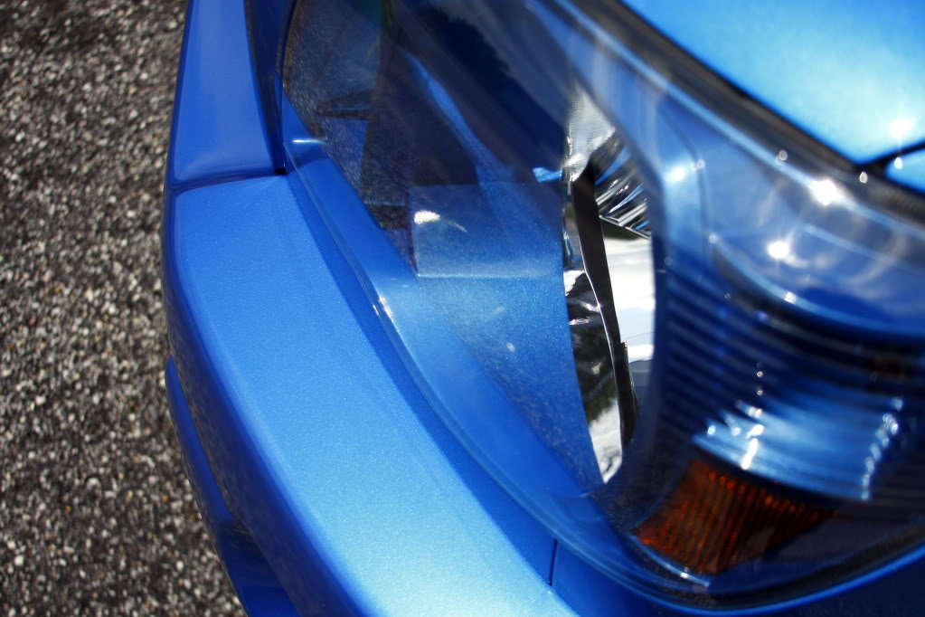

    OK, so here are my BHLM pics, only this time, the "B" stands for BLUE. In a few of the shots, it looks like the paint is darker than the OEM color, but it's only the way the sun is reflecting off of the paint. You can really see the paint color match well in the last photo.
