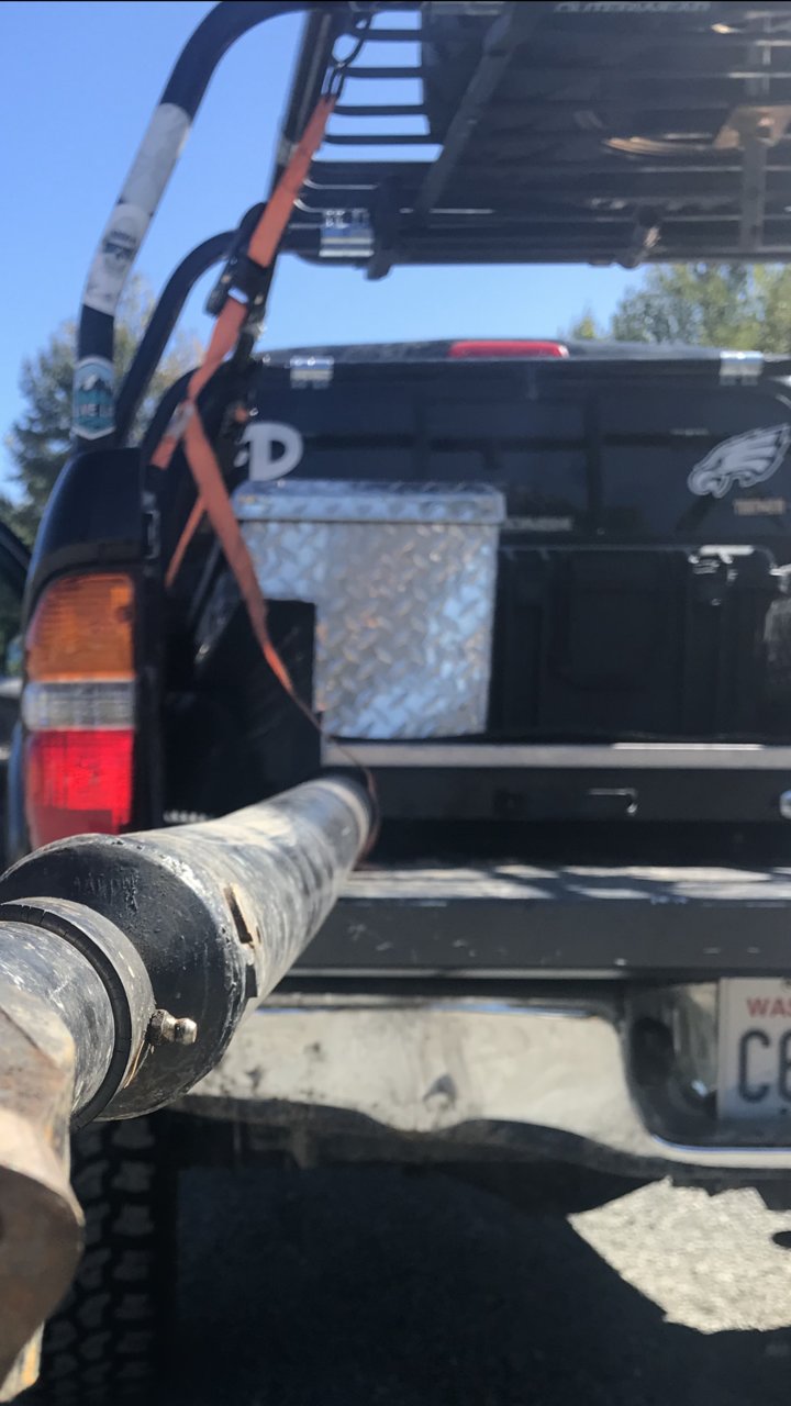

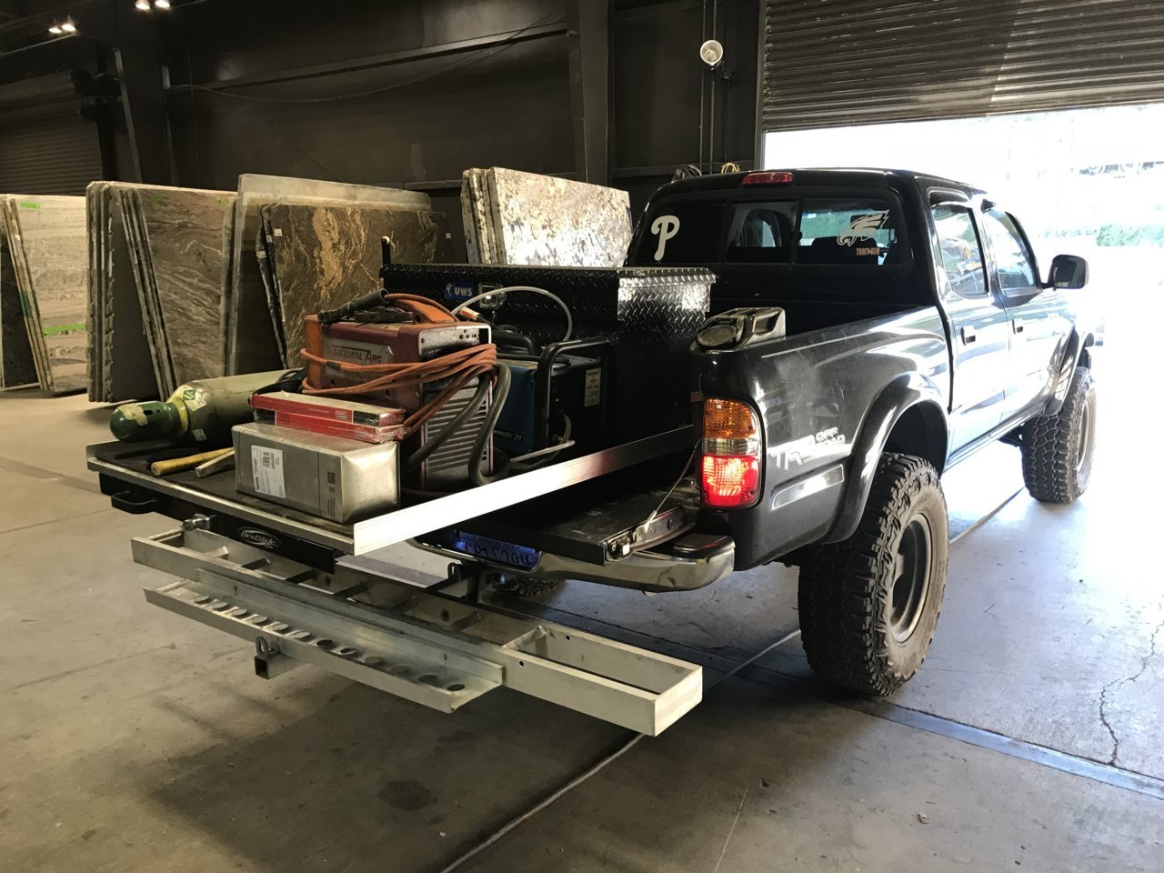

    Is the bedslide with the height extra weight and loss of room?
  9. Nov 15, 2019 at 10:42 PM
    #249
    BlackPearl
    BlackPearl [OP] Well-Known Member
    Apr 17, 2017
    #216527
    1,362
    Alex
    Toyota Tacoma TRD
    3” lift. Sway a ways 2.5 on 285 75 16 and much more
    It does add extra weight but in my opinion it makes accessing things in the back much easier with my set up. I bolted down two side mount tool boxes and also have 1 pelican case in the middle. Here are a few ways I had it set up. Also for longer trips I have a 5’ pelican case that fits perfectly between the tool boxes.

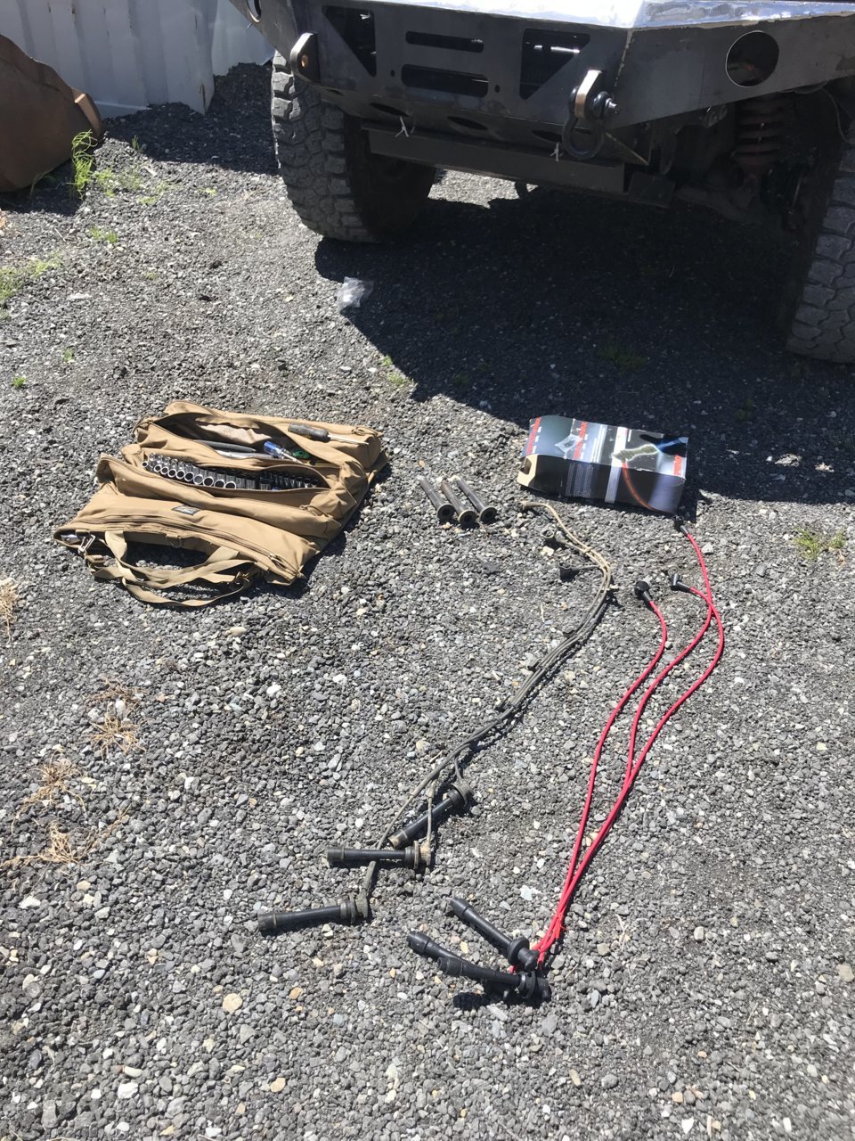

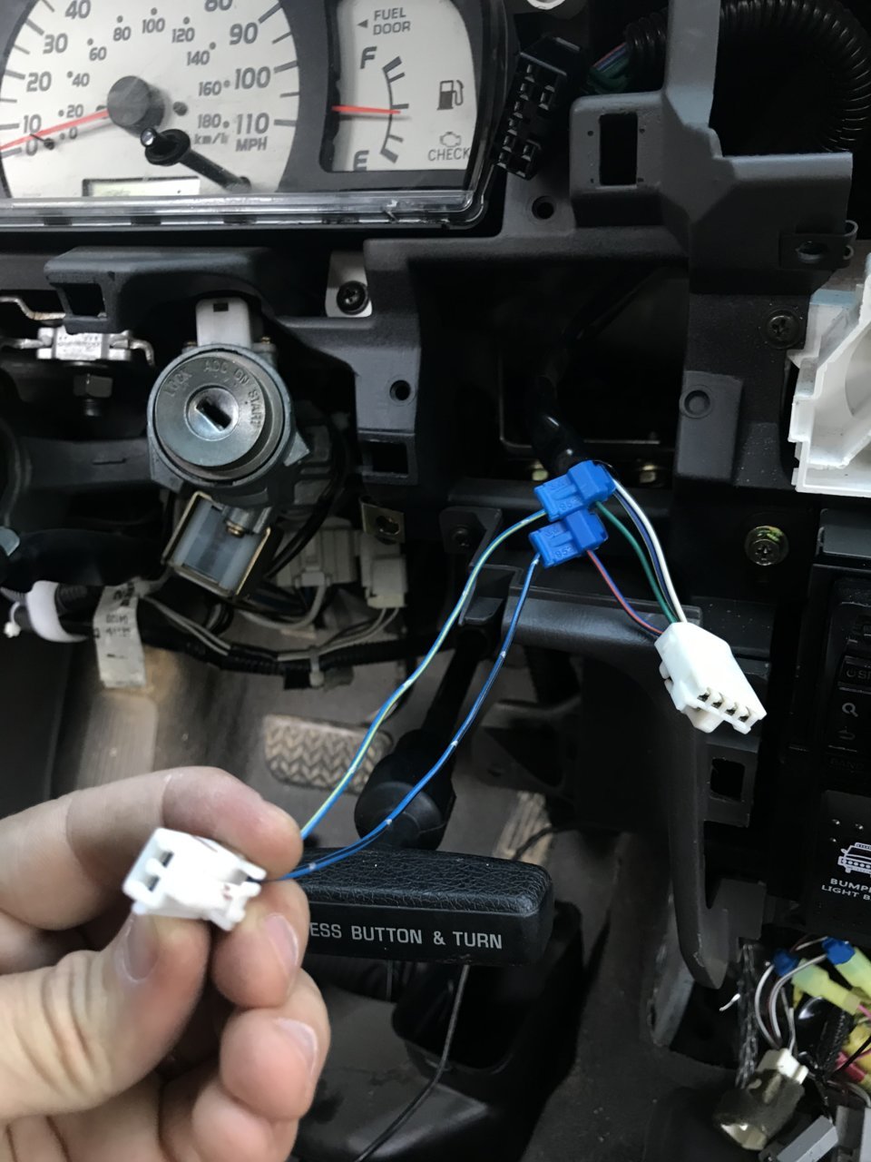

    Were did you find the plug wires?
    How do you like the 4.88's I'm debating on those or the 4.56.

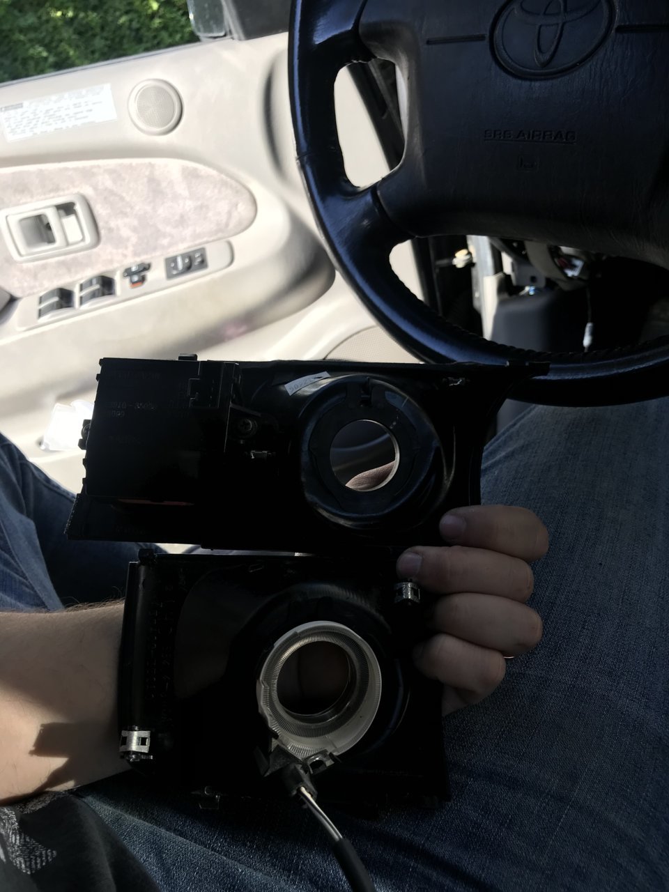

    What wires did you tap into for the key light? I have one on my Camry it's nice to have.

    I pulled one of those out of a 4Runner and found the corresponding plug under my dash. I was surprised it was a plug and play modification.

    Wires I first bought off ebay but they fell apart. Tossed em and bought this set at Auto Zone.

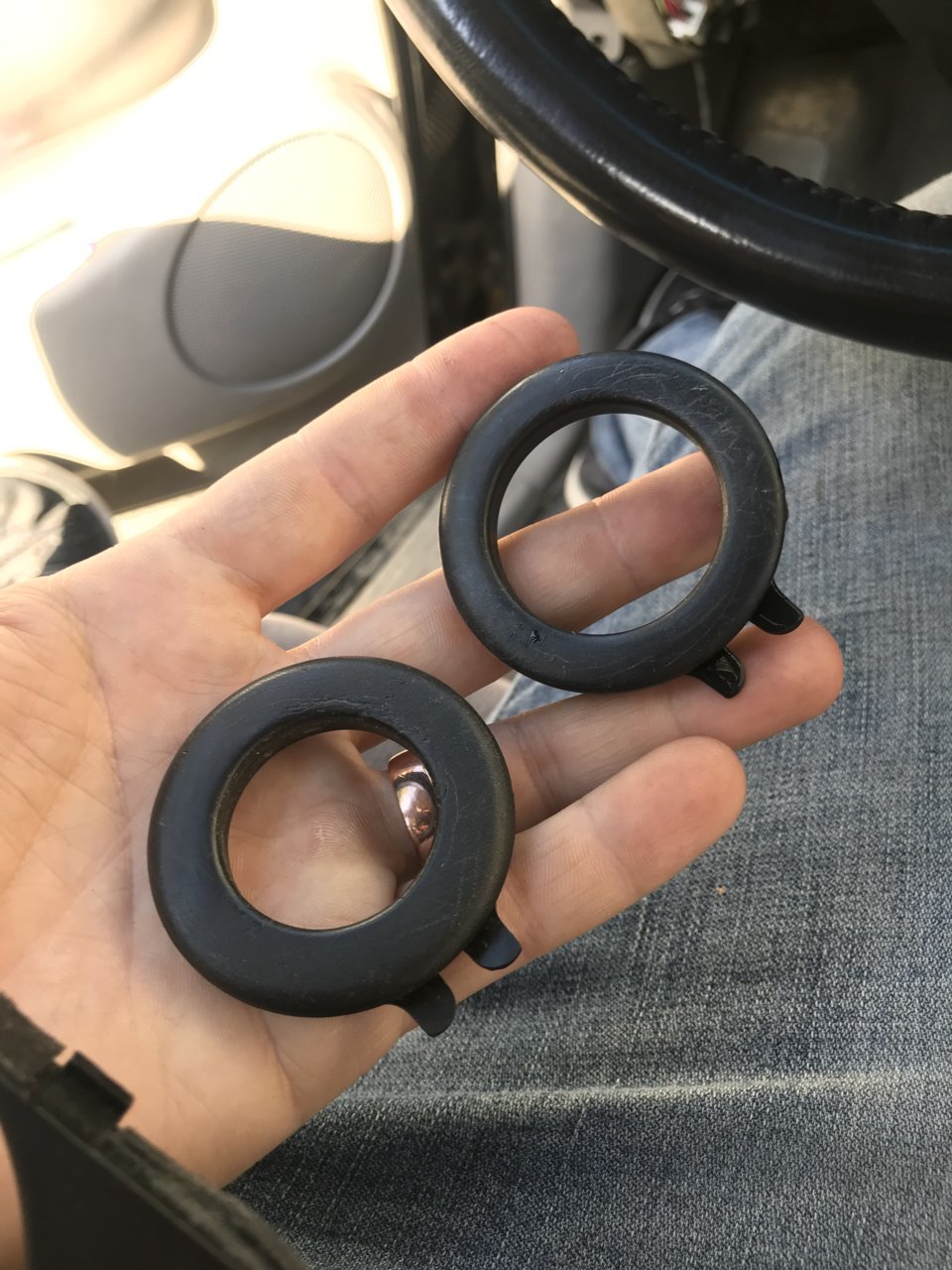

    Was it wired before you got the truck by someone else? or was this a stock option? Wonder how it works.
    I made mine turn off when lights are on, this way the light ring is not reflecting on the windshield when driving at night.

    I believe that most 95-00 are pre-wired for the light ring. It was an option on some trucks. It is activated from the integration module and comes on when you open the door. After you close the door it will turn off after 15-30 seconds.

    Mine came pre-wired.

    I did have a wire on the other side that didn't have anything to plug into. Still haven't figured out what it was for.
