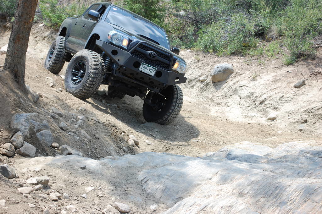

    Nice pics Bob.
    What springs I forget?
    Haha
    How do you like the ADS?

    toytec boss leafs. made for a 2" lift so dk if they would be best for your setup. but with the shackle flip its a 2.75" total rear lift. then little preload with 14x700 spring on the coilovers up front keeps me low.

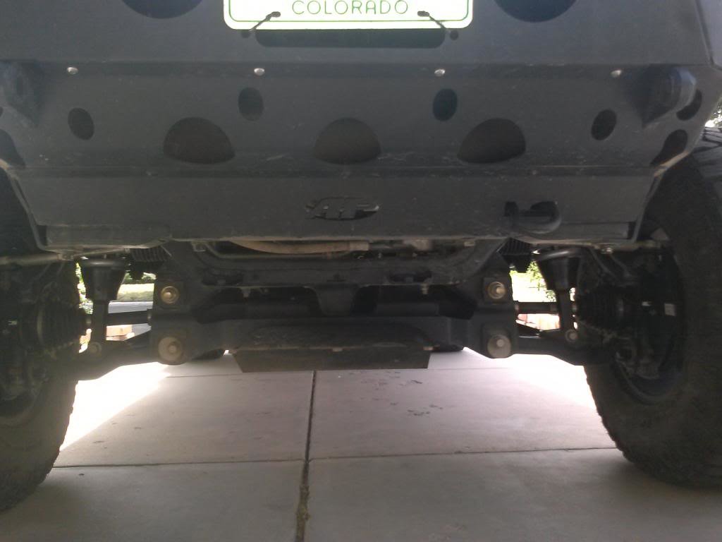

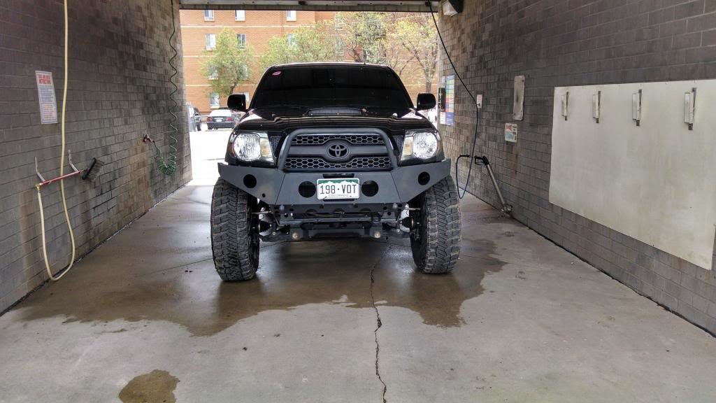

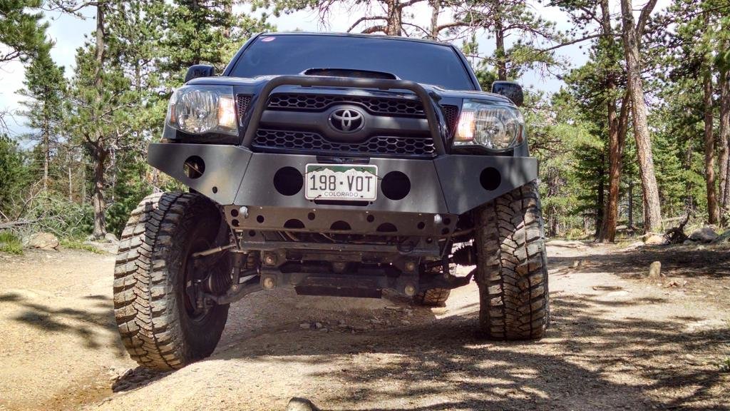

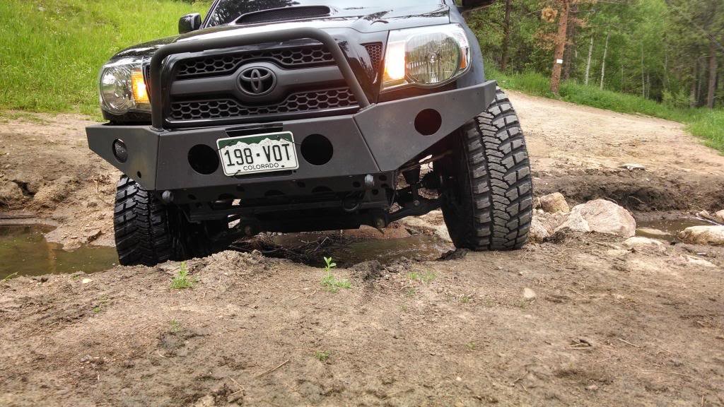

    Do you have a pic of the allpro bumper on your truck with the bds on your truck from the front?

    With the BDS or 3" lift?
    I had all my trimming done before I moved up to 6" lift. I'd say for 6"/35's just have to trim plastic and if you offload probably a cab mount chop.

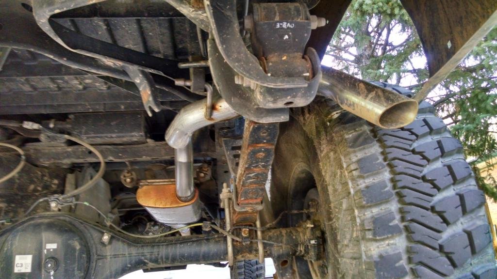

    Nice build. I noticed you chopped the mbrp exhaust. I have an mbrp too. Did you notice any difference in sounds or anything? Thanks

    Thx!
    I was a fan of that exhaust with stock headers. Too raspy with long tube headers.
    Have a 18" magnaflow muffler now much better.

    6" if you could and do you know if the bds skid will cover the drop bracket some?
