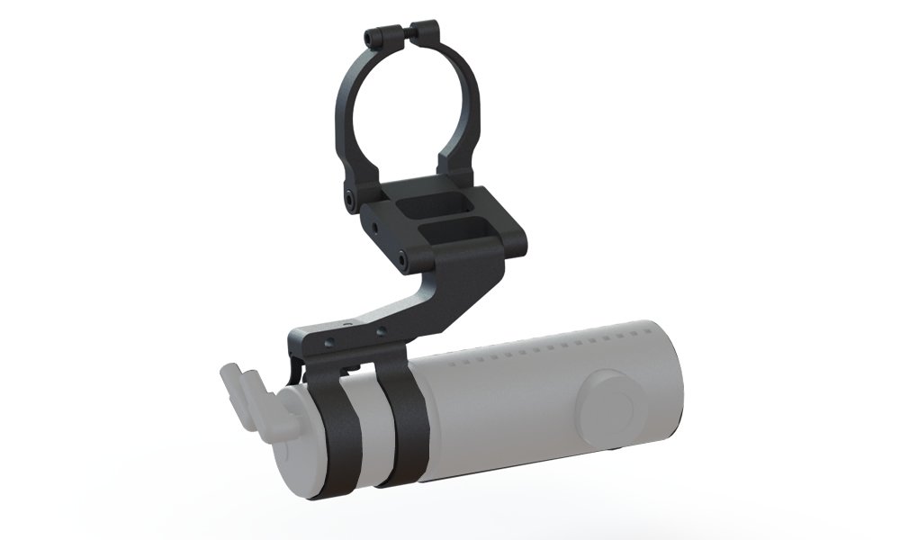

    I'm going to be installing a 900s with this Blendmount mount. I have a 17 so i have more space than your 18. my windshield is tinted so I didn't want to use the sticker.
    I hope it comes in this week so I can work on it on the weekend.
    https://www.blendmount.com/blackvue.html

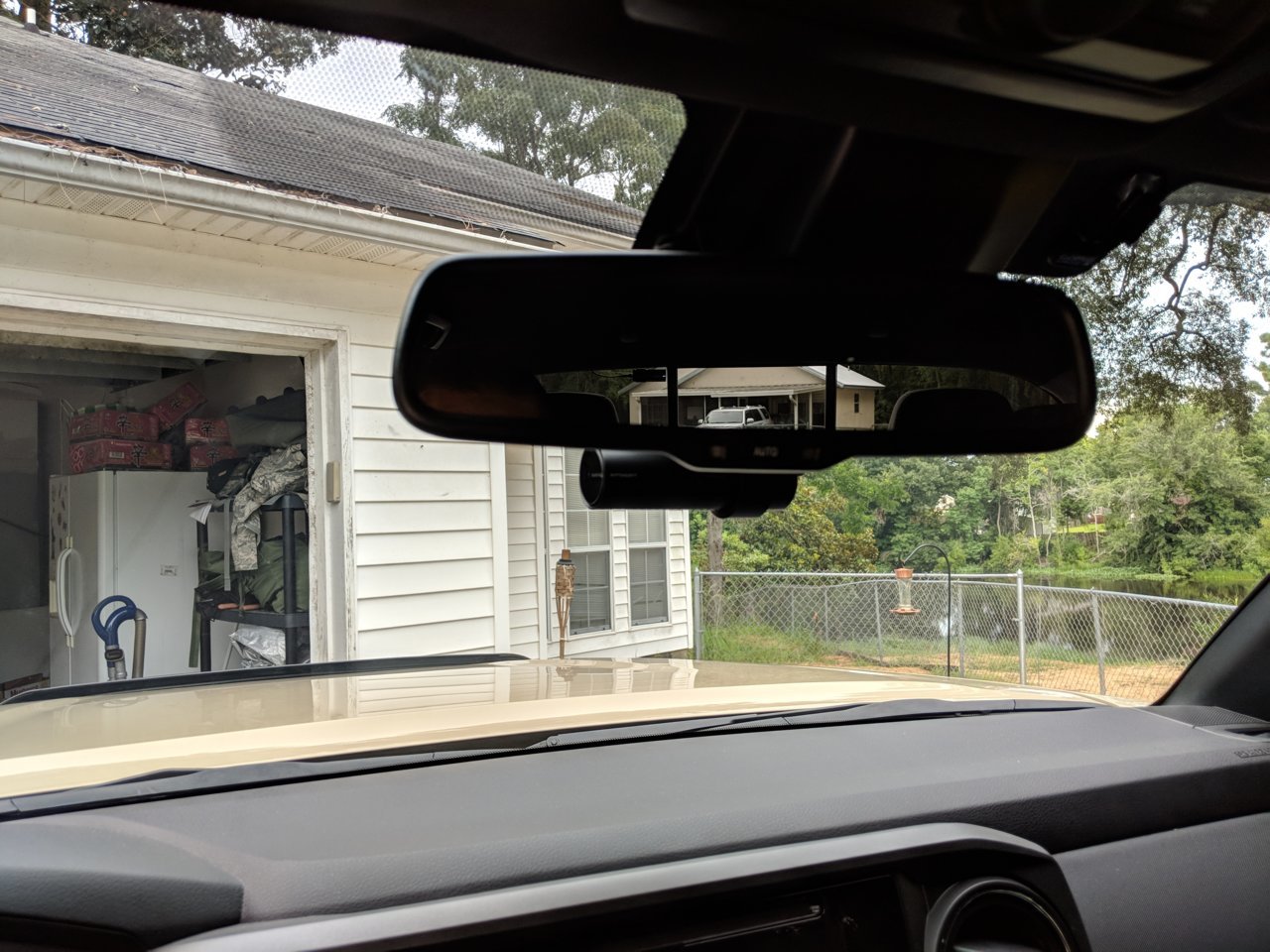

    I'll have to get a picture but mine is directly behind the rear view mirror. I don't even know its there. Mounted it in the same place of the wife's 4runner. Already came in handy when someone hit her mirror a few weeks ago.

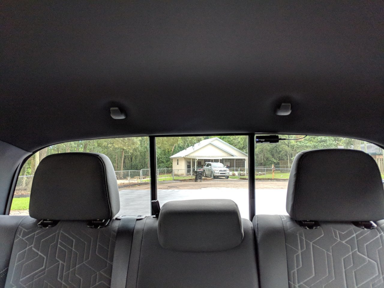

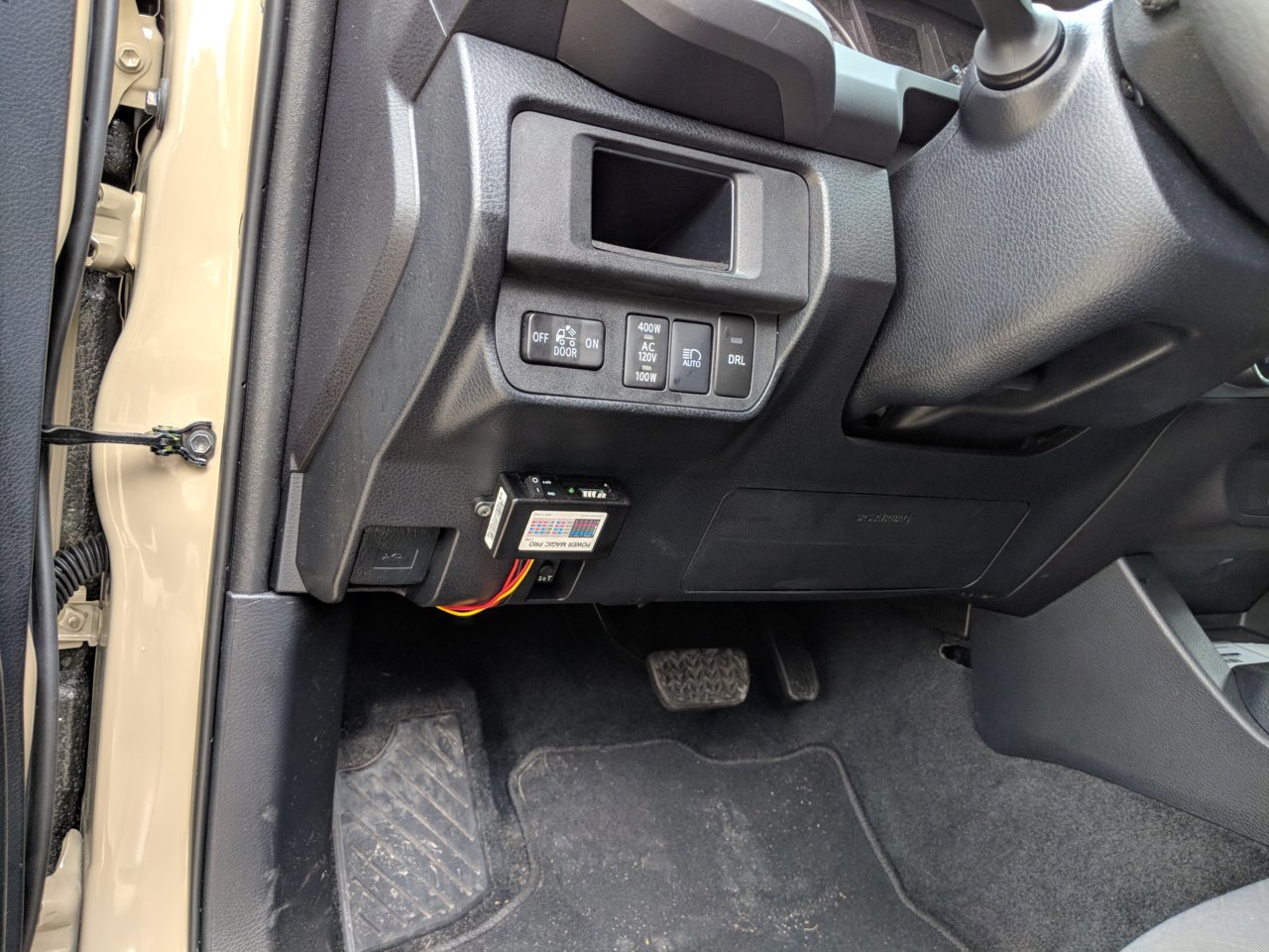

    I have the DR750S-2CH. Front camera is right behind rearview mirror. Rear camera is on the driver side of powered rear window. PowerMagic is installed near hood release latch. Can probably get some pics tomorrow.

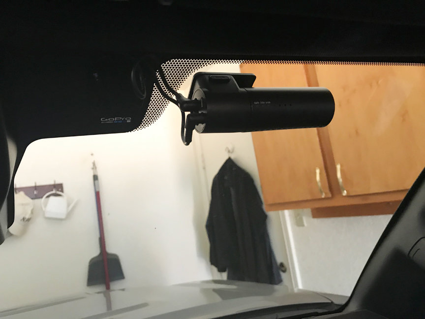

    Here’s what I ended up doing:
    https://www.tacomaworld.com/threads/blackvue-in-the-gopro-mount.532939/#post-17495255
    Power magic got zip tied up under the dash above the kick panel. Probably a one hour project. Maybe 1.5.

    I have mine mounted behind the rear view mirror. The power magic pro is hardwired to the cab fuse box and just thrown behind the steering column. It traps it up there pretty well.

  16. Aug 15, 2018 at 2:45 PM
    #16
    robie_0n3
    robie_0n3 Well-Known Member
    May 12, 2018
    #253303
    214
    David
    Scott AFB, IL
    2018 Tacoma TRD Off Road
    Here you go. Hope they help.

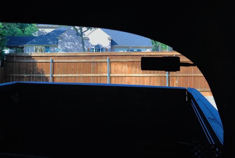

    Got my Dr590w 2Ch installed. I Used the double sided tape install on the front camera while waiting on the Shipeways mount and a few GoPro connectors to do the final front camera mount. Also I need to tweak the rear camera position.Currently have it on drivers side rear close to the side. It captures a pretty decent image from there but think I need to move it more to the center.

    Same thing happened to me! I figured out too that I had the cloud on trying to access my wifi so you can't access it via the app while doing it. I learned when I was driving away from home and my phone automatically connected to the Blackvue.
    I'm using the Blendmount mount so I can get it below my mirror and reach to disable/enable wifi and audio recording.
    https://amzn.to/2w7rn29
