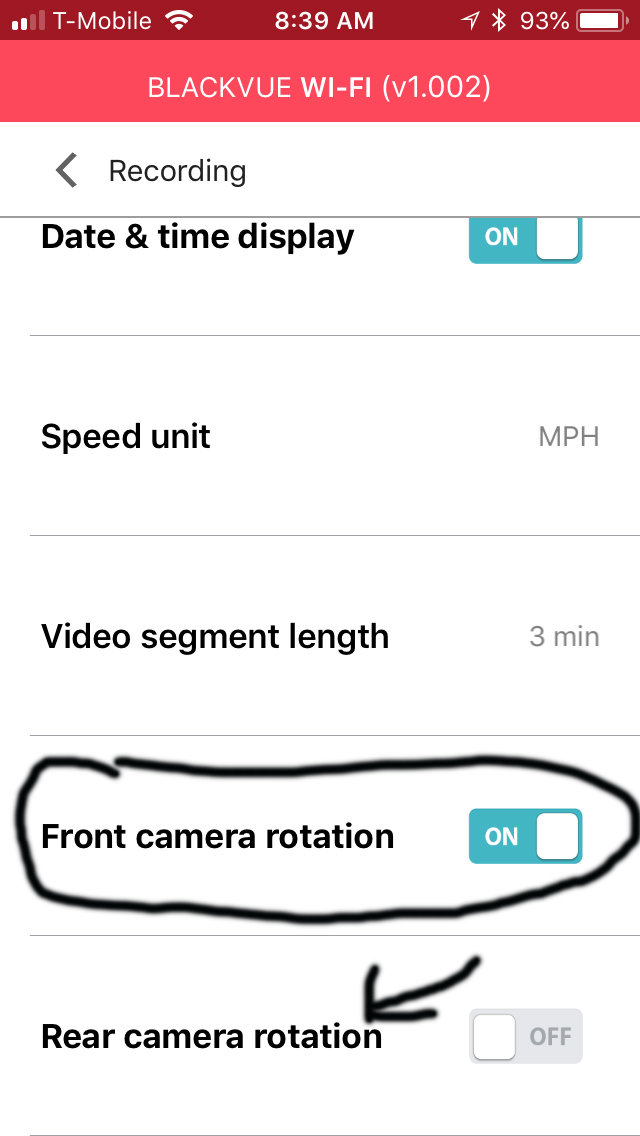

    Are you finding a setting in the Firmware to flip the front camera image? I find it to set for the rear camera by default, but have to flip the video once viewing on my computer.... can't seem to find a setting for the camera to record flipped.

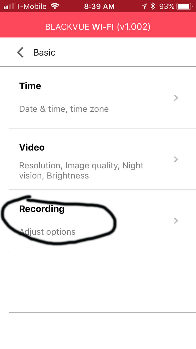

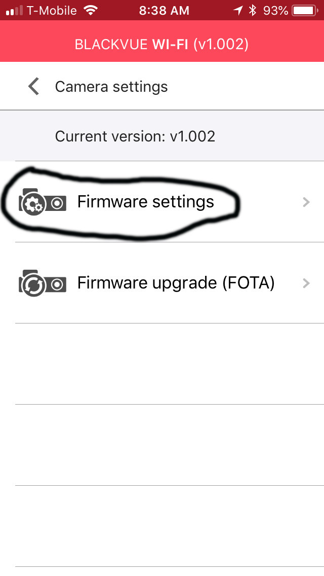

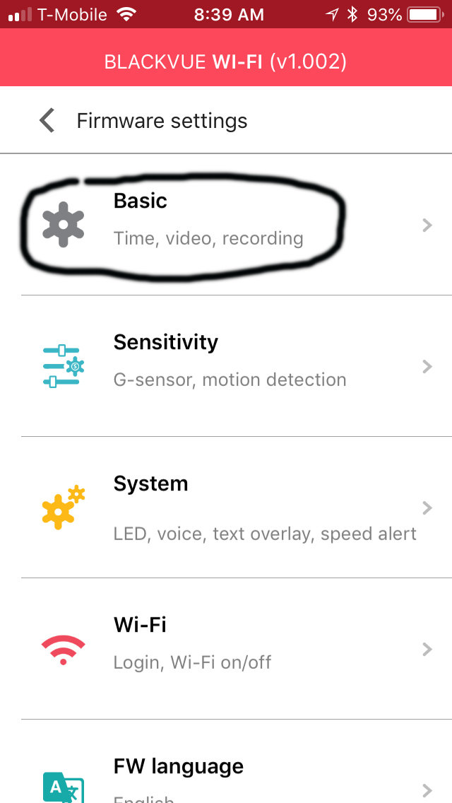

    Yes, the setting is in the Firmware accessible from the phone app. It my be accessible from the PC interface but I've not tried that. Let me see if I can walk you through.
    The tree to get there is: Camera Settings> Firmware Settings> Basic> Recording> then select Front (or rear) camera rotation.
    Here are some screen shots.

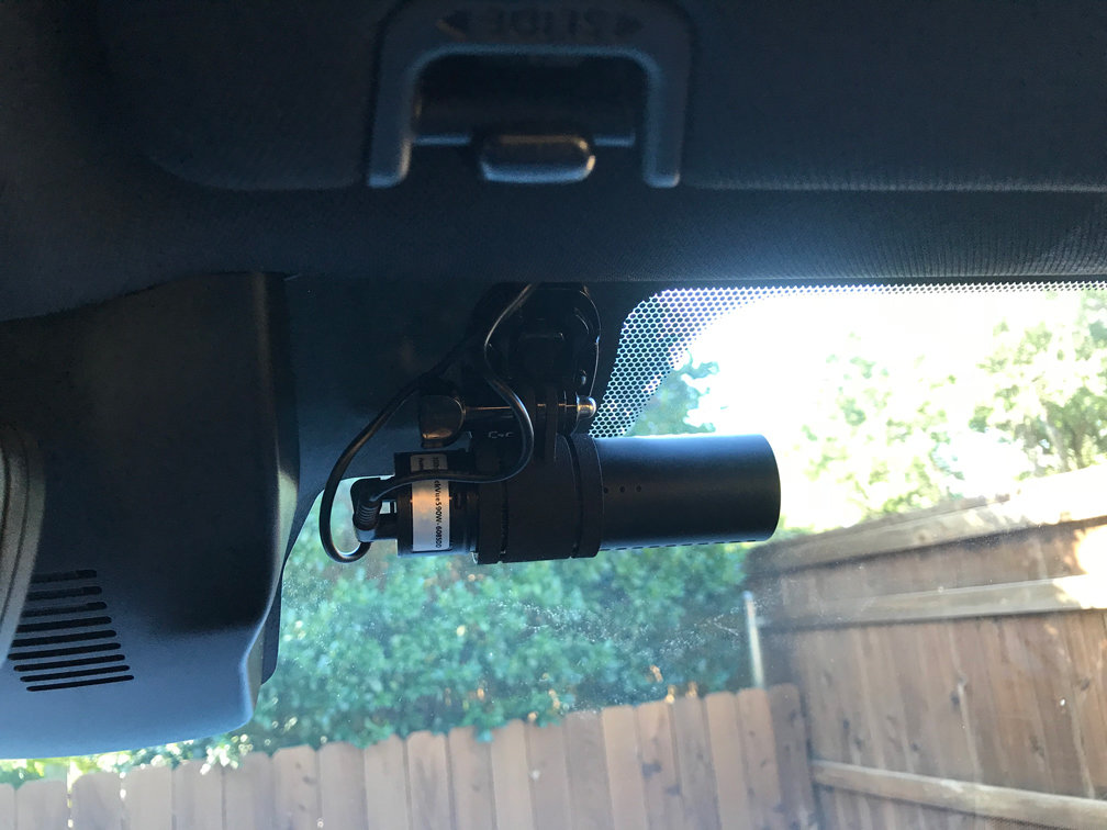

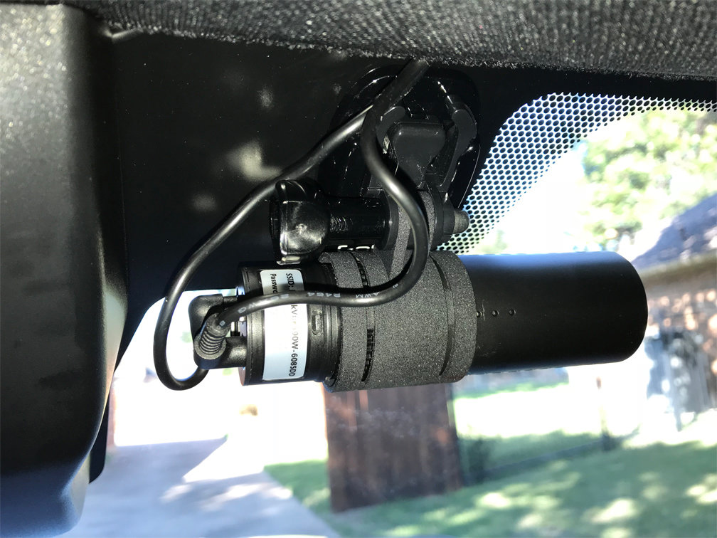

    Received the Shipways adapter and got it installed. All in all I'm happy with it although there are a few things I wish worked out differently,
    One, the adapter fits over the camera main body, not the end part that the OEM mount fits on. Where it mounts it covers the function alert lights. (recording, WiFi on etc) Not a big deal I guess. I pretty much know what's on or not. Two, to get the SD card out I need to pull the GoPro adapter from the window mount. There's just not enough room to get my fat fingers in there and get it out. Again not that big of a deal since I can view images on my phone without pulling the SD card for most situations. And three, there is no adjustment as to how tight the mount squeezes the camera and as received it was quite lose. A bit of masking tape inside the mount solved that.
    I need to clean up the wires a little, but I'm considering ordering the GPS attachment which will mean another wire to deal with so I'm going to wait awhile on that. They are not that much in the way, just a little ragged.
