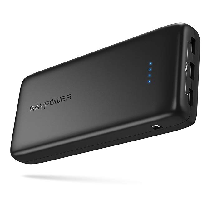

    Update:
    I wasn't able to get THAT particular battery delivered in time for some weekend testing, so I'm using an older Ravpower battery that I've had approx. 2 years. It's the Ravpower model RP-PB41, with a 26,800mAh battery, and 3 usb outlets, @ 1.0/2.1/2.4 amps output.
    With both cameras plugged in to the 1.0 amp usb outlet, I ran a 48 hour test; at the BlackVue stated power consumption of 0.30 amps, there was still approx. 1/2 of the battery left after 48 hours. This particular battery uses 4 led's to let you know the state of charge--which isn't very precise enough, but I feel confident enough that I could get close to the theoretical 89 hours of battery life/use.
    If this battery had a bluetooth feature to see what it's doing, like the BlackVue B-124, it would be perfect.
    Conclusion: It works FANTASTICALLY!
    (https://www.ravpower.com/rp-pb41.html)

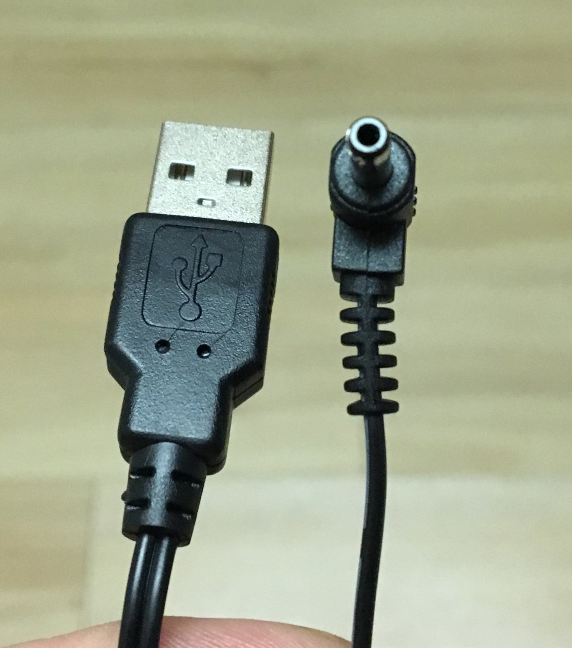

    What'd you use to connect the camera to the USB port?

    It's complicated.
    I was going to make my own cable, but I found this one in my box of spare cables & wires. I don't remember where it came from, and it has no markings on it. It's ~3 feet long.

    Looks like a power cable for a USB hub or KVM. I should have some spare ones lying around.
    So since the Ravpower battery greatly outclasses the B-124 in terms of battery life, what advantage(s) does the B-124 bring to the fight? Is it perhaps more heat-tolerant, given it's designed to sit in a hot cab? Obviously the Bluetooth is a nice feature.

    2017 QS DCLB TRD Sport
    Fast charging.
    In about 30-45 minutes, it will reach full charge.

    It's complicated.
    One battery is much less expensive than the other. One battery takes 13 hours to recharge from zero, the other one takes 40 minutes. One has bluetooth, one doesn't. One battery can be used while charging, the other cannot. One battery can be expanded in parallel, the other? Not so much.
