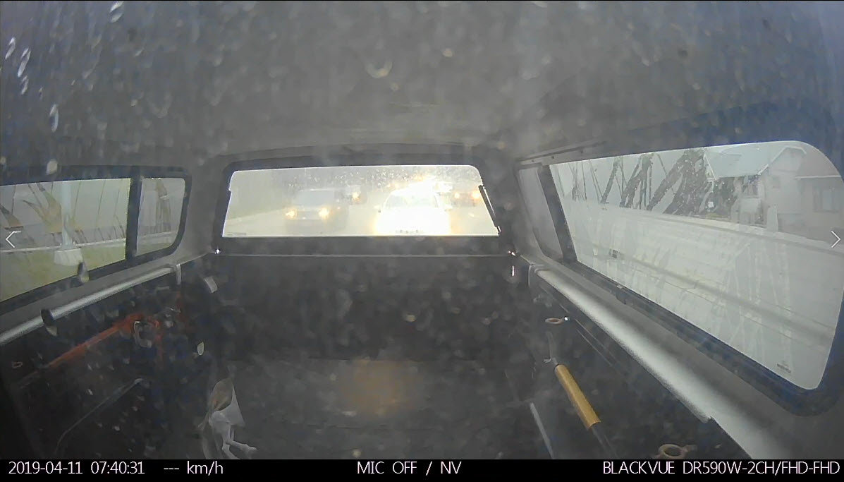

    Mine is like this, but a bit lower.
    It looks out the back through the canopy but gives good coverage of all cargo.
