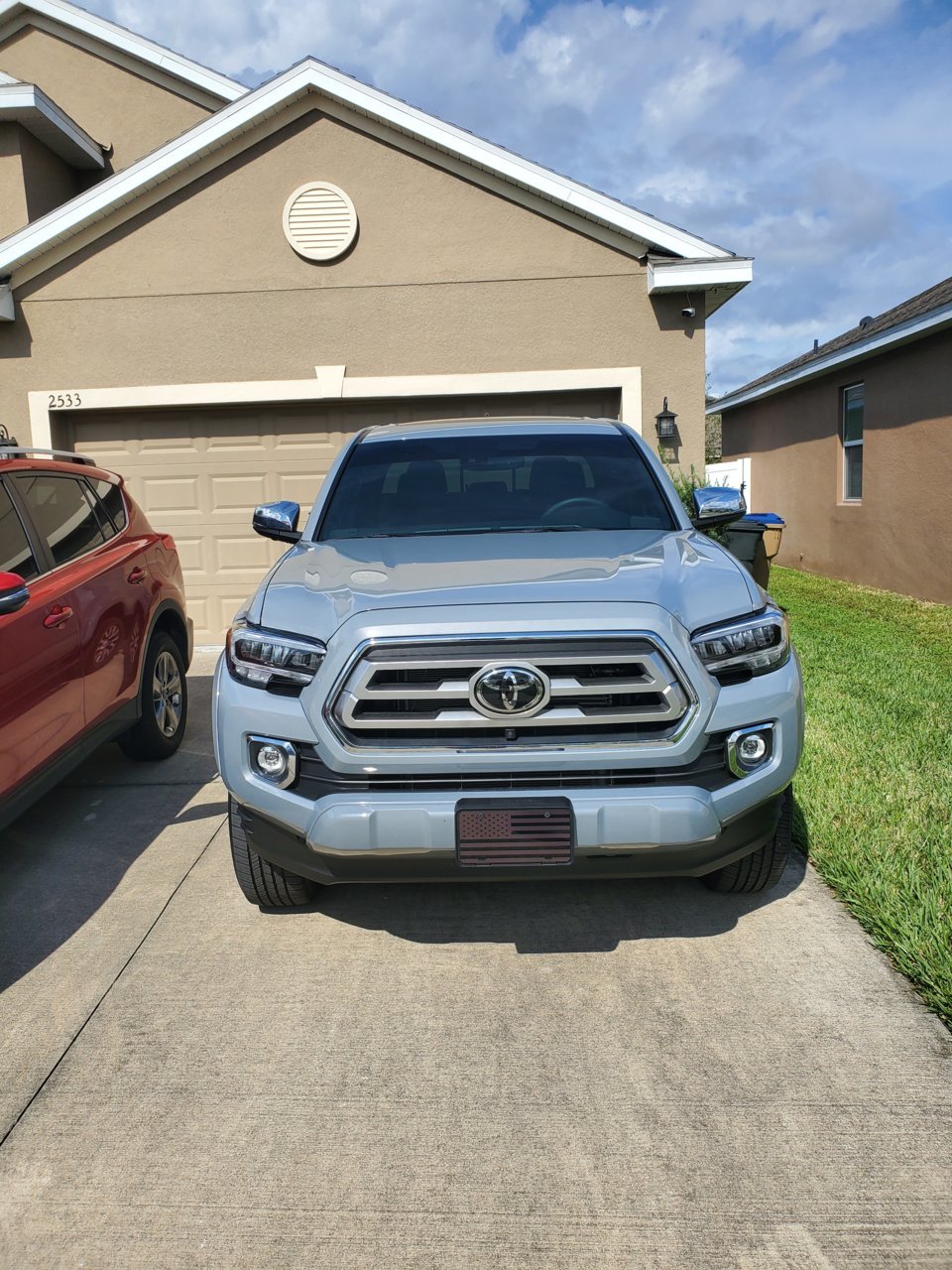

    What do you guys think of installing the dr900s on top of the visor strip tint on my truck. Will the weight of the camera mess up the tint? I have a 5% strip and would like to put the adhesive part on the strip itself so it doesnt show as much. My last camera i had the camera right on the glass but always wanted to install it right on the tint. But been worry it would pull the tint off. Anyone done this? Thanks

    Can't comment on how it will interact on the tint, but here's my thinking: it won't be good. Maybe I'm paranoid or something, but my experience with adhesive on glass has not been positive. Even if whatever I stuck on it never came off, if I ever wanted to remove or reposition it, it'd potentially be a massive headache.
    I bought a metal holder/bracket thingy that attaches to the mirror stalk. Also has the advantage of fine-tuning the alignment.
