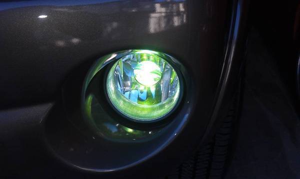

    I finished up my blazer retro today along with the wire down mod... Overall it wasnt too complex of a retro. The only thing left is setting the vertical adjustment tonight.

    looks good! how is your horizontal?

    It’s hard to tell right now, I just set them at the same height for now andwill do the final adjustment tonight ones it gets dark. Damn its windy outside!I want to do a FXR retro and sell my Morimotos, do you have any advice as faras how to set the horizontal adjustment. I have heard of people getting them inthere with minimal trimming on the reflector bowl…. I know you’ve done a set ortwo of FXR’s
