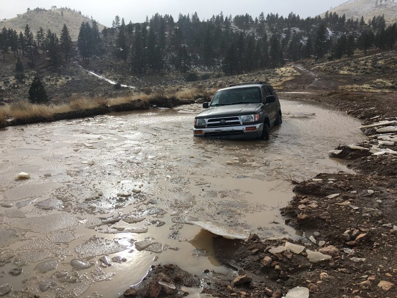

    I drove through a questionably deep "lake" (read puddle) today. My engine is hydrolocked so I'm gonna buy a jdm engine. My 4Runner is a 1997 my question is will any engine from a 1996-2002 4Runner work?

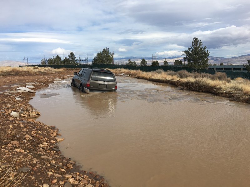

    It actually wasn't too deep. The splash got sucked in through the "cold air intake" the previous owner install. Immediately hydrolocked my 1 week old, new to me ride

    6 days to be exact. They claim the engine I'm about to buy has 40,000 miles so if that's true then it's an upgrade lol. Was stuck in that puddle for about 20-30 minutes
