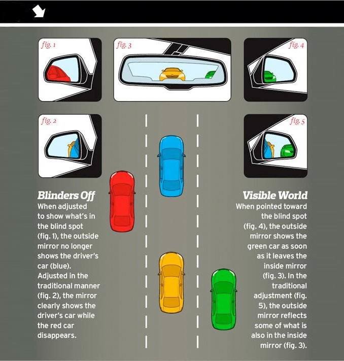

    You can set your mirrors to cover your blind spots.
    Drivers side - with the window rolled up, lean left with your head resting against the window. Now adjust your driver side mirror until you can no longer see the left side of the truck.
    Passenger side - lean to your right side about as far as you comfortably can without stretching yourself. Adjust your passenger side mirror until you can no longer see the right side of your vehicle.
    Test your settings - while parked, have someone stand on the drivers side so you can see them in the rear view mirror. As they step forward, once they leave the sight of view for the rear view mirror, they should be visible in the side mirror. Repeat the same procedure for the passenger side mirror.
    You may find that you'll have to adjust the mirrors down a little more than you may have done previously. The idea is for the mirrors to cover your blind spots, not see the sides of your truck.
    Learned this from a trucker and it works great!!

    This post from @steelhd is really good information- I use it and it really works
