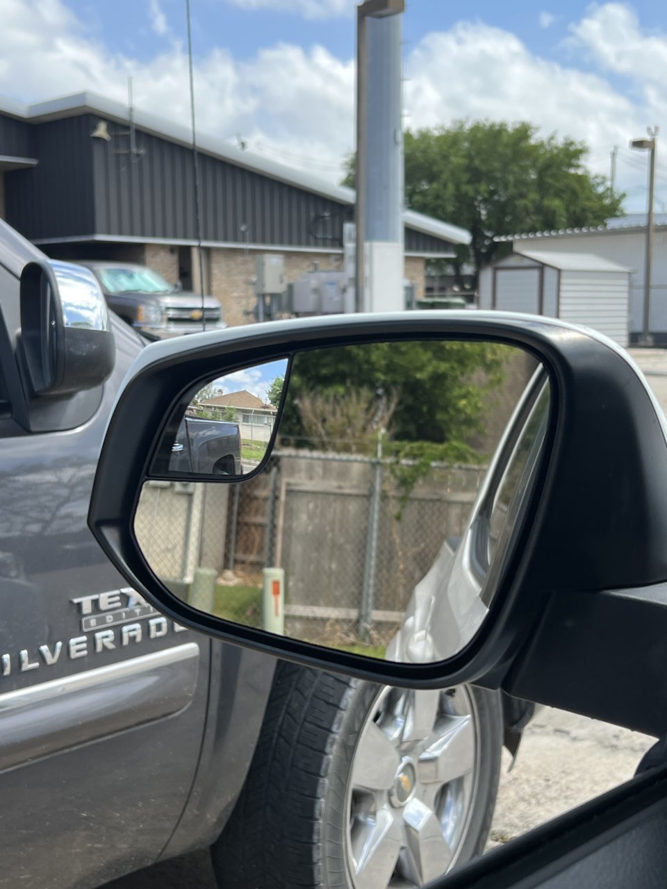

    On the newer 4Runners you can change the flat mirrors to RAV4 convex mirrors to get the blind spot mirror. Is there such a conversion for the 3rd Gen Tacoma mirrors or do I need to go to those 2” round stick on blind spot mirrors.

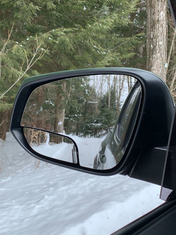

    You can use RAV4 mirrors - couldn't find the link with the part numbers but it's here somewhere. I have Spotter Mirrors on mine which I prefer over the RAV4s, but it's just personal preference. The RAV4 mirrors are less expensive - just make sure you get the right flavor if you have BSM.

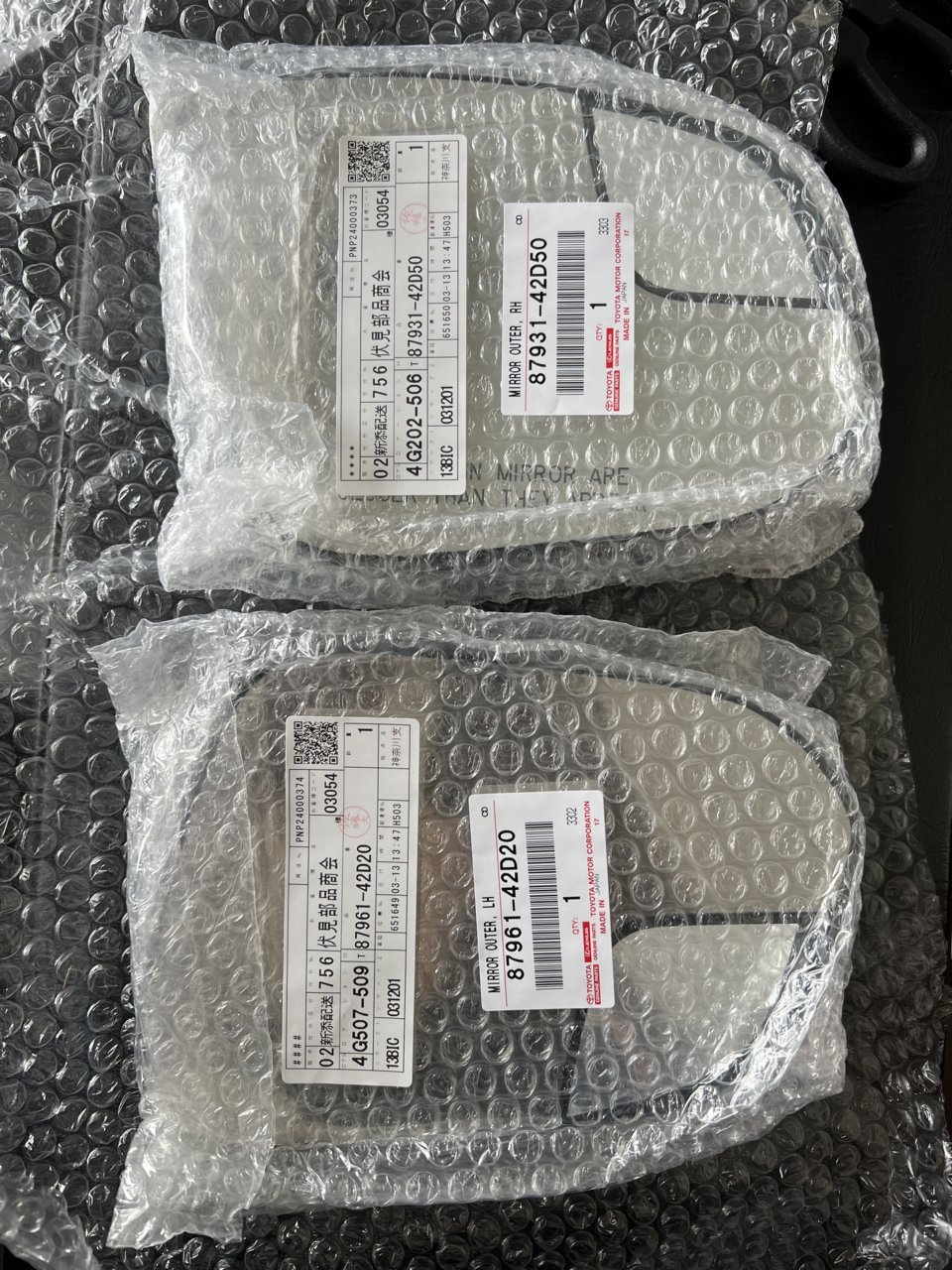

    I believe it’s off an earlier RAV4 - I only did the driver side but both work- DS part number 87961-42D20

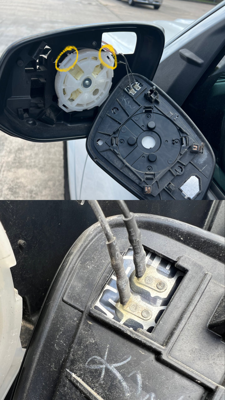

    Make sure all the tabs are clicked in once you remove the old mirrors if ya decide to go the Rav4 mirror route.
    Heater wires are a bit to pull off. I used some pliers in fear of ripping them completely.

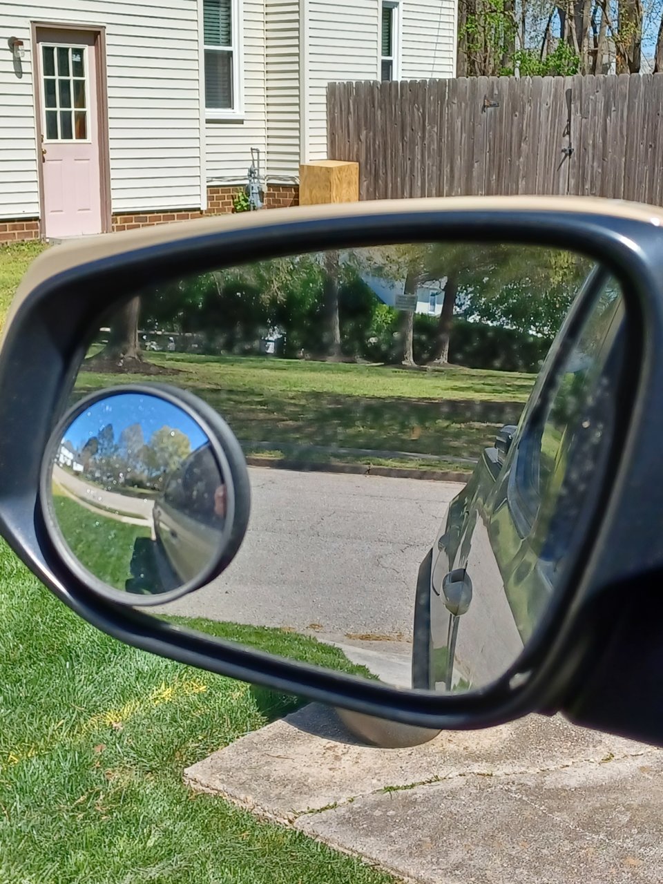

    I have the RAV4 mirrors on my 4runner and 2 inch discs on my Tacoma. After having both I prefer the discs in the lower corner because not only can I see cars in my blindspot, it gives me a view of the rear tires in relation to curbs / parking lines / driveway edge when backing up.
    You don't get that view with the RAV4 version.
    Discs were only about $5 whereas the RAV4 mirrors were about $80.
    If I were to do it over again I'd have saved the $80 and installed discs on the 4runner. I'm only keeping them because I'd spent the money and broke two clips removing the original 4runner mirrors during install.

    I have these also and they work great. They are a little expensive. If you go this route, cut the heat shrink off of the terminals before pulling the spade clips off.

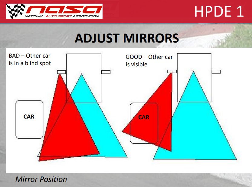

    Disagree, this method prevents the side mirrors from seeing straight back while sitting in a normal driving position. As the center mirror is occluded in even minor traffic angling the side mirrors out prevents one from seeing what is approaching from the rear.
    The same procedure is recommended however do not lean your head over the shifter or against the glass, simply tip your head slightly to the side towards whichever mirror you are adjusting but not leaving your normal driving position.
    Side mirrors are designed to see parallel to the side of the vehicle, not simply to look in the blind spot. BSM, spotter mirrors, and turning your head are for the blind spot

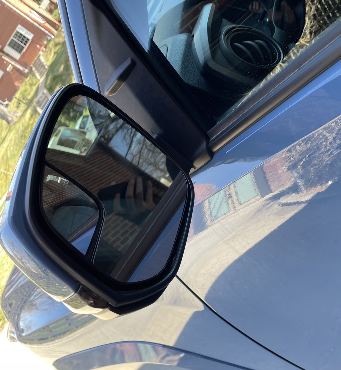

    OP if the mirrors help, wether its glued on blind spot aids, rav4, other. Do it.
    I wanted mine to look as it came from factory. So I opted for RAV4. ($75 shipped) via ebay.

    Disagree, there is no need to see straight back with your side mirrors, that's what the center mirror is for. Different if you've got a canopy or something that prevents center mirror use. Basically, if you can see the side of your truck in your side mirrors you're doing it wrong. The side of your truck isn't going anywhere. We teach this in HPDE.

    the Rav4 mirrors are awesome, one of the best "mods" (if you want to call it that) I have done to my Tacoma. I liked them so much, I did the same on my GF's 4R.

    @Firn @Cleanwilly In the end, all three of us are recommending that it's necessary to angle the mirrors out more than many people do. That is the important take away. It's interesting these convex mirrors are being added to people's mirrors in this thread.

    You picture shows exactly what I was saying, it does show visibility straight back. It does NOT show what stftaco was describing. He is right however in that seeing the side of your vehicle is the worst thing you can do.

    I've never worried about crashing into myself, although I do like knowing there isn't a car in my "blind spot." I don't have blind spots because my side mirrors are angled further out.
