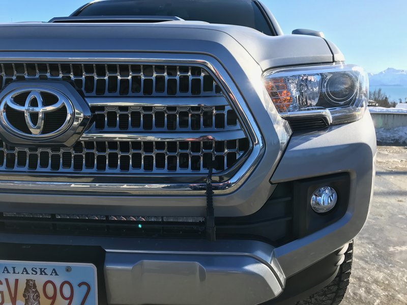

    I'm not sure we're on the same page...the block heater cord is hanging out from the front of my grille and that's where I plug it into the extension cord. It's this connection that's giving me issues.
    No, none that I can see. It looks just fine, not bent or discolored and no ice or debris present. I keep the male end of the plug in a protective cover that's also attached to the grille when I'm not using it.

    Yes, yours is different. Nicer, too. This is mine:

    so they clearly didn't do an OEM one for yours.
    are you using a cheap cord or good one? Could just be the cord.

    The Block heater is dealer installed. I don't know why the US doesn't get the same block heater but I like mine. It's a cleaner install, the cord doesn't flap in the wind scratching the vehicle and if you forget to unplug it. It doesn't rip the cord out.

    I have the same one since I'm in Canada. I would've thought they used the same one. Or the dealer just installed an aftermarket part?
    Could be using aftermarket though not OEM.
    I would figure they do. I swear there's been other members from the US with what we have to here North of the wall.
