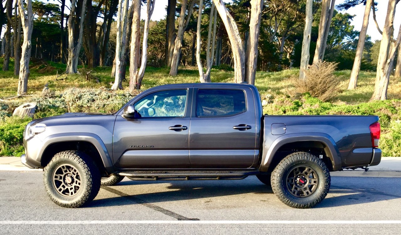

    I am happy with the 2" front and 2" back, for me it seems to be the right amount

    That's a sweet looking truck. I know for a fact, that as a daily driver that I certainly don't need a lift, but for looks alone, your's look "right" for me. Did the tires add any added "lift", I tried to zoom into get the size, but no luck on this old PC - Thanks Bill in MA

    What size tires are those?

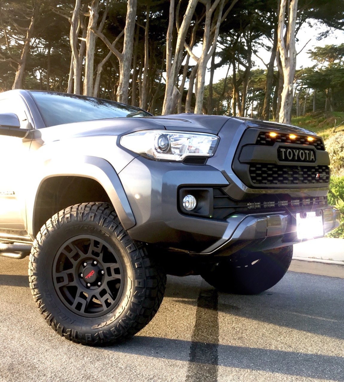

    Whats the info on your wheels setup? Thank you

    It is a dally driver, however it remains comfortable. Tires do add a small amount lift, I am using Nitto Ridge Grappler 285/70/17,
    I've seen trucks with a 3" lift and more, sure they look really nice and sometimes I want to lift my truck even more,
    but for me, really 2" is good!!
    The Nitto Grapplers remain almost as quiet as the original tires, to me that is a important.
    I also understand that going more than 3" on your lift, there will be other issues that will affect the truck, plenty of threads
    in Tacoma World about that.
    One thing I would say, I think I am paying a little more in gas with the current setup than before. How much I don't want to know.

    Did you have to do CMC and pinch weld? If not. do they rub?

    No rubbing, and I did not have to CMC or modified the inner fenders.
    If I had gone with 285/85/17 with the TRD wheels, for sure I would have had.
    Also, It seems that some rims are more forgiving than others. I don't know if it has to do
    with +/- off set and all that complicated staff.

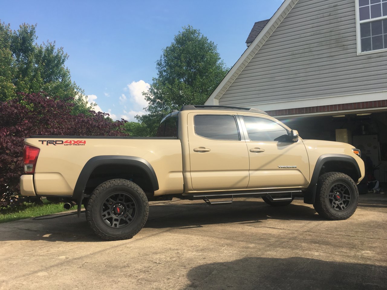

    LRO 3/2. Total lift ground to bottom of fenders was 2 inches all the way around.
