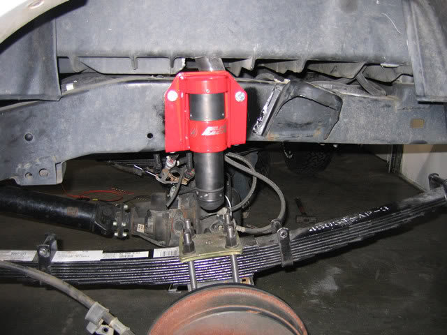

    The 3" AllPro springs installed, for those on the fence about the:

    thats awesome! Now whats the reasoning for moving the shock mount forward on the frame?
  16. Mar 19, 2008 at 12:39 PM
    #16
    mjp2
    mjp2 Living vicariously through myself Moderator
    Feb 16, 2007
    #924
    22,016
    Milton Juevo Portimous II
    NJ
    Current: '21 Bronco Badlands. Previous: '06 TRD Access Cab, v6, 6-speed
    I'm actually changing quite a bit. The Jounce Shocks will soon be moved to inside the frame rails to make room for 2.5" bypass shocks that will mount to the top of the axle housing and will come through the bed outside the frame and will tie into the bed cage.
    It has to keep pace with the front suspension:
