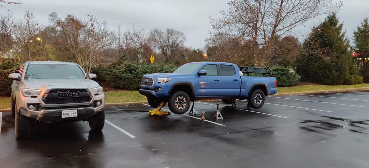

    Did the old "swap wheels/tires in a Panera parking lot" with my brother. He was running my 255s and spacers and I sent his bald, stock tires/wheels with the totalled truck. Now, he has my brand new set and I have my 255s back. Confused?
    I had the pleasure of doing all the work while he was on a call for work. Yay me.

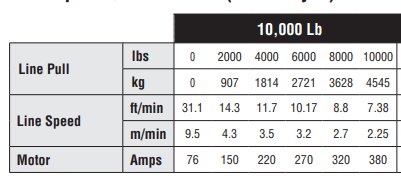

    Before I installed mine I took apart my X20 and replaced the grease, and I also added some RTV to certain areas of the solenoid. You may consider doing that before you install it.
    Where are you thinking about moving the solenoid to? Here's a helpful calc as you size wires: https://www.calculator.net/voltage-drop-calculator.html The battery leads that came with my winch were only about 3 awg and are really too small for the current draw. See what slcsez2000 did here for some info on the RTV, Grease, and relocation: https://www.tacomaworld.com/threads/smittybilt-gen2-xrc-and-x20-winches.325833/page-5#post-9211117

    Awesome info dude! Thanks for the links. I got the X2O as well. I totally agree about upgrading the wiring. I want to put the solenoid behind the airbox, which would require a decently long run for control and power cables.
    I'll read up and probably do this before installation. I was just going to bolt the winch to the bumper this weekend and not worry about wiring or spooling until next week sometime.

    I kept mine on the winch body. With the factory cables I could have positioned it behind the grill, but I think that's more exposed than in the bumper cavity. I definitely would like to relocate it a little higher up, but didn't want to spend the $ on new cables yet. Given that a 10k load draws 380 amps I'll probably run 1/0 cables to try to keep the voltage drop to about 3%. 2/0 would be better but that's definitely a big cable.

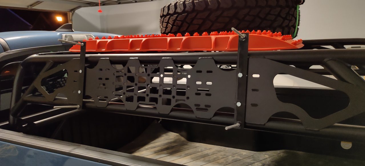

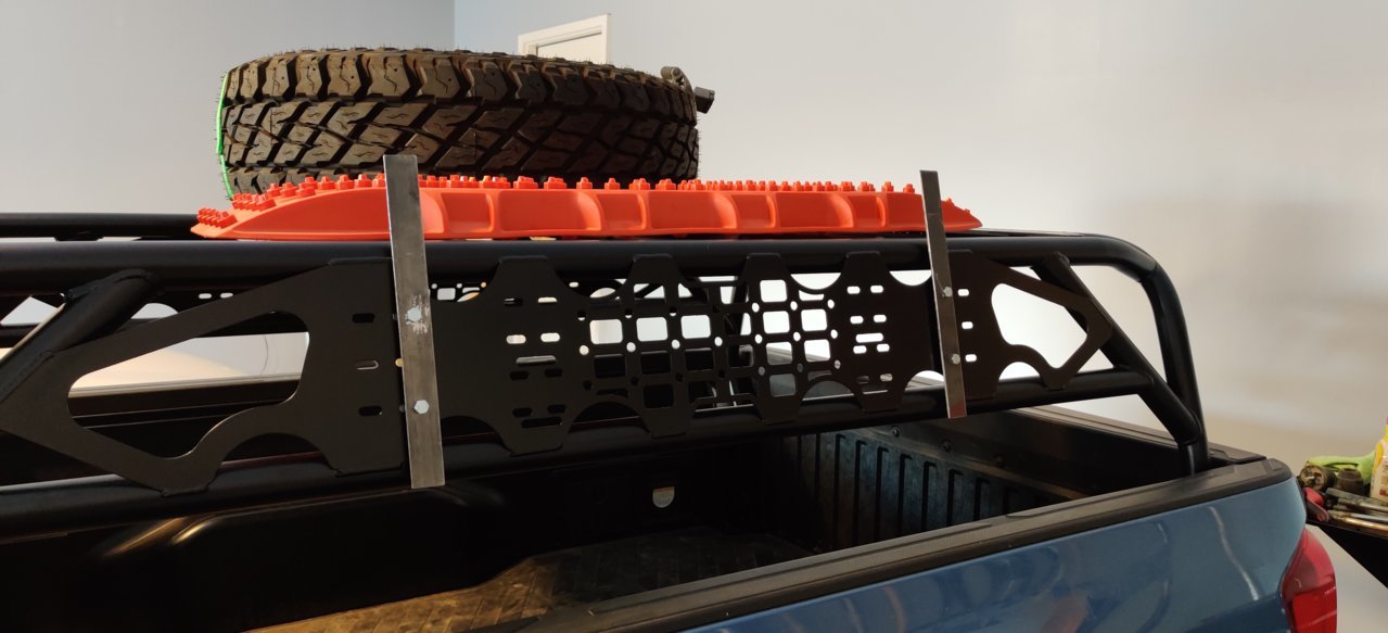

    Going to head to the garage and fab up some brackets for the recovery boards

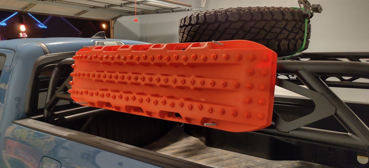

    Recovery boards mounted
    +200 expo points
