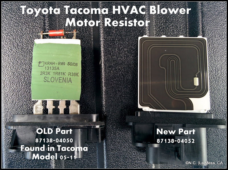

    Toyota does sell a replacement cable end if needed. There is a thread here somewhere that has a part number. You will either need to Butt Splice the wires or solder and heat shrink them.
    Plug = 82141-04M40
    Resistor = 87138-04052
    Here it is:

    Root cause of the burn is poor mfg tolerancing on the GM-made resistor connector. Not sure if it's just the pin or if the connector molding also contributes to the problem. If it recurs, buy the updated resistor shown in Jimmyh's photo; it's made by Denso and has better tolerances.

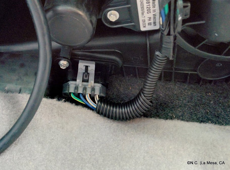

    Hey my blower started doing the same shit last summer. I'm pretty sure it only happens with the fan set to HI only. My (dumb?) question is, where on the truck are these 2 parts found?? Under the hood? Under the dash...? Thanks
  17. Mar 8, 2016 at 11:08 PM
    #17
    Jimmyh
    Jimmyh Well-Known Member
    May 16, 2012
    #78991
    14,264
    SC
    2012 Prerunner SR5
    Inside passenger floorboard on the blower fan motor.

    Here is a picture man.
    And here is a pic of my new one I just installed.
    The old shit one on the left, new-made-in-japan one on the right.
