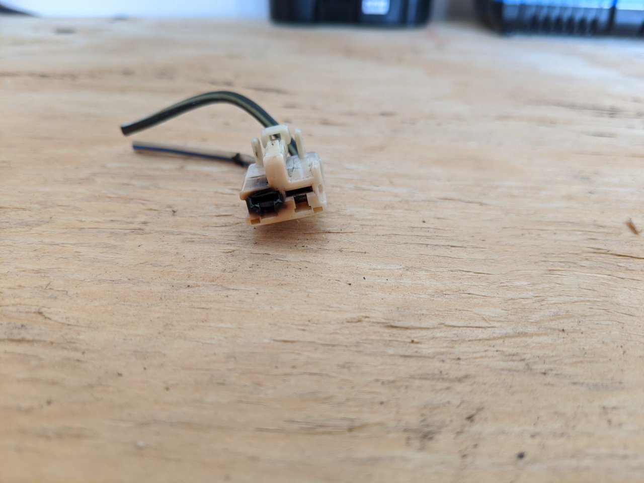

    Wow the plug looks burnt are these a common issue or a rare occurance? If that's the case I'll take it apart & see what's going on with the plug I hope it's just a loose connection

    Common,

    That is caused by a loose connection between the male and female terminals. Loose terminal adds resistance which generates heat. Heat = Localized Burning.

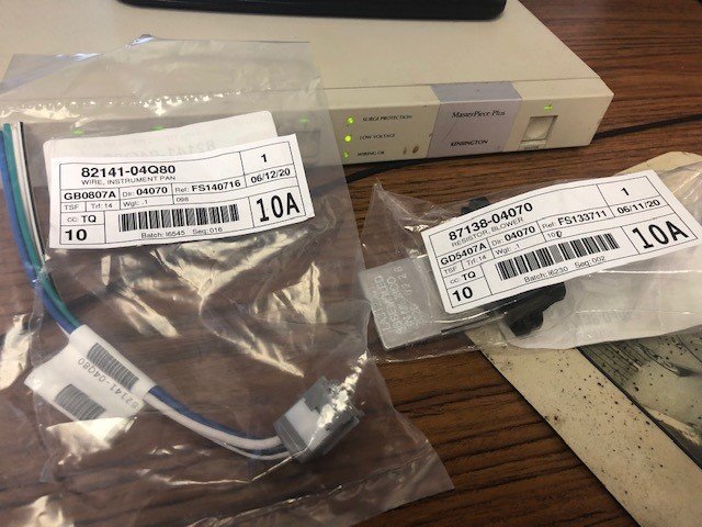

    I'm pretty sure you can get a kit that includes the resistor and the connector. If you get the improved resistor and connector it is shaped different and the wire colors are not exactly the same and the connector is square Let me look up the color for you.
    Here is the matching wire colors for the original to the square connector:
    Green W/Yellow stripe - Green
    White W/Black stripe - White W/Black stripe
    Blue W/Black stripe - Blue
    White W/Blue stripe - White
    lo2hi and TRDSport10 like this.
