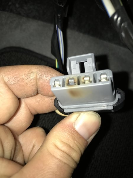

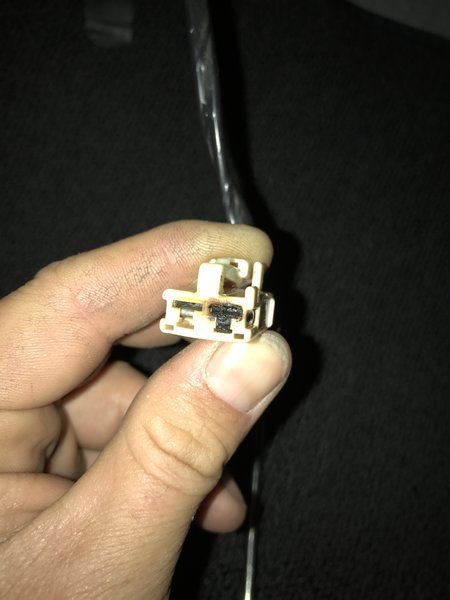

    Well it finally happened to me the blower motor for my air conditioner has burned up the wires . i'll be looking for two part numbers if anyone can help me. The part number for the resistor plug and the part number for the 12 V power to the blow motor

    Excellent. Would you happen to have the part number for the 12 V power to the motor. That connector is also burned. It is the connector in 1st photo.

    So have you tried some spray electrical cleaner and a fine wire to clean the burned tab off? Bend the male pin slightly toward the female connector to get a harder connection. (Sounds dirty don't it) Press dielectric grease into the tab and on the pin to stop the arcing. This worked for me and it's ran like a champ ever since. Pretty much a quick and free fix.

    Would di-electric greese on the new connector help it last longer?

    That isn't what Dielectric Grease is for.
    Dielectric Grease is a non conductor and is for preventing moisture or water into a connection. It does not improve a connection, just the opposite.

    Thanks for the fast response on the part numbers it's much appreciated. It will take a couple of days for them to arrive too bad it's so hot In the oc this week
