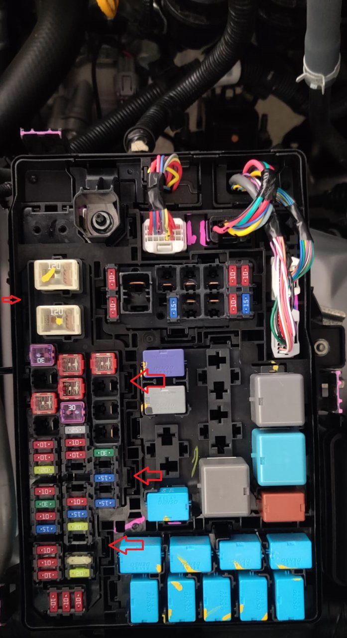

    Bumping this thread since I was dumb enough to blow the same 140A fuse. I cannot get the fuse box out. Read this 10x and maybe I'm missing something.
    Any other tips that can possibly help? Cannot find anything else on TW or the internet for that matter. TIA

    05 PreRunner TRD Offroad AutoTrans
    Hood Struts, My version Fogs always ON, Map & Overhead Light Mod,
    Battery cables disconnected
    All connectors to fuse/relay box disconnected
    Securing hardware of box removed
    Lift box, remove bottom tray
    Module for those fuses has securing tabs that need to be pressed sideways
    recess[QUOTED] likes this.

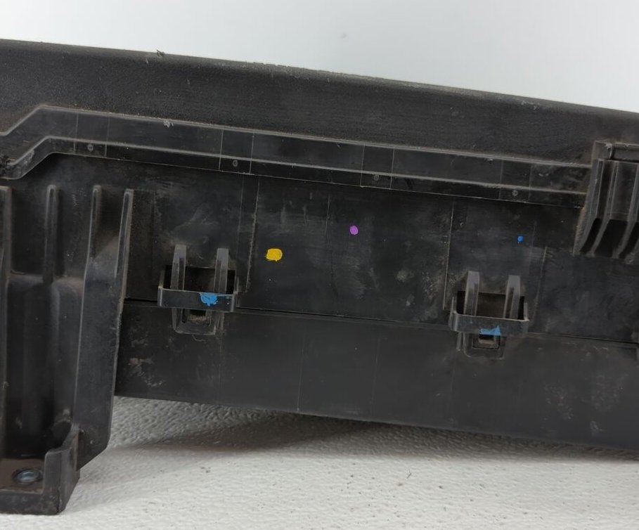

    I just went through this fusebox breakdown over the weekend and want to add one thing that I don't see people mentioning anywhere. There are also tabs on the underside of the fuse box that must be unclipped as well. The plastic is super cheap and the tabs break very easily, but I was still able to get it snapped back together pretty well. I also blew the 10a stop fuse and a few others, replaced those, and I still had to tow the truck to the dealer so they could reset the ECU and get it out of limp mode ($200). Hope this helps anyone having a problem getting that 140a fuse replaced.

    so there are those clips (which are super easy to get to), but once those two pieces come apart, there are clips on the bottom side of the top section (super tricky to get to, and completely hidden unless you know they're there).

    Different clips than the ones I posted on #22?
