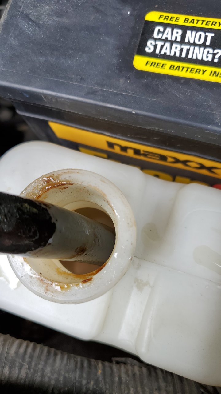

    So I recently I purchased the 4runner I have been looking for a long time. Has 183k miles, sport edition, excellent condition. I just discovered oil in my coolant reservoir. So I took it to my local shop and found out I have a blown head gasket. I really want to keep it since these are hard to come by over here. The shop is charging around 4k for the repairs. I was wondering if it would be easier to have them put a remanufactured engine instead or have them fix those problems. What's the average cost for an engine swap 3.4L 5VZE.

    Yea I found the OEM parts are much cheaper. Olathe Toyota Parts. I'm either going to take it to another local shop or Toyota dealership and see what they say. Either way Im going to have it fixed it regardless. I bought the vehicle private sale. Didn't show any signs of a blown head gasket until about a month and half later. Didn't overheat or anything. Seemed weird when I checked the coolant.

    Maybe, It was weird that it didn't reach proper operating temperature. It only reached about 1/4 of the way. Which I found odd. The Check Engine Light recently popped up which threw the P046 code. So I have to see what that is as well.
