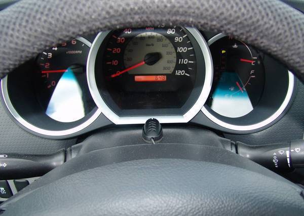

    I have the same truck and had the same problem. On the original installation the mic was mounted down by the ignition key. I relocated the mic to the upper console and have been told that it is 100% better for sound quality. With the original mic location (this is where Toyota recommends the placement to be) the blutooth was virtually unusable, now it works very well. Hopefully this helps.

    I added the rostra Blu logic set up to my 2011 and it is awesome. i put the mic right on colum and no complaints from anyone.

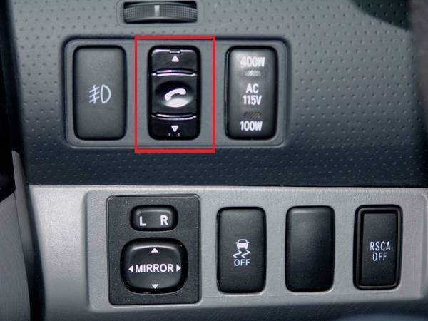

    Now this is where i wish they had put my call button. Mine is on the bottom spare and it is hard to see behind the steering wheel, my only complaint. One of these days i'm gonna relocate it like yours :)

    Several dealerships told me that Toyota called for the Blu Logic mic to be located by the ignition key, but it doesnt work well in that location . So as I said, I moved it to the upper console which solved my problem. I also did move the control switch from the lower bank of switches to the upper bank as it was hard to see when I was driving. Yours would work fine located on the A pillar, I'm sure.

    its easy to pop the blu logic out and move it. I just reached up from underneth. 2 minutes. oh yeah its works fine with my XM no problems. Plug & play the whole way. No problems. Now i got to get the blue lights switched out to orange.

    I got mine moved to just on the right side of my guages, people tell me it sounds like I'm talking on a normal handset. I might consider moving my buttons to the left side but it's not bad where it is now for me.
