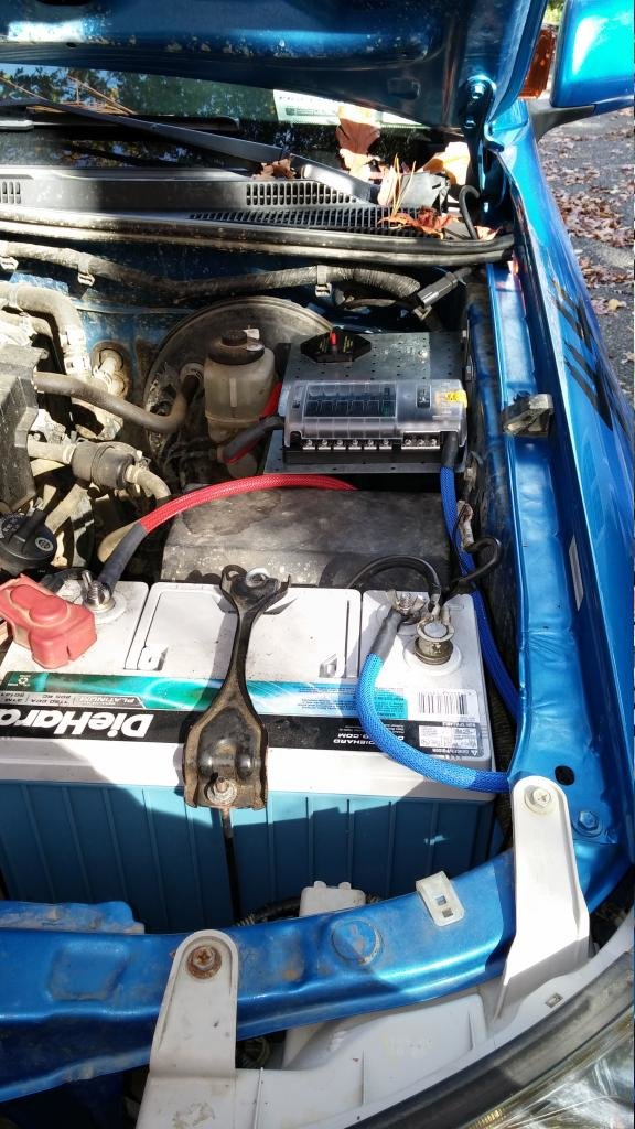

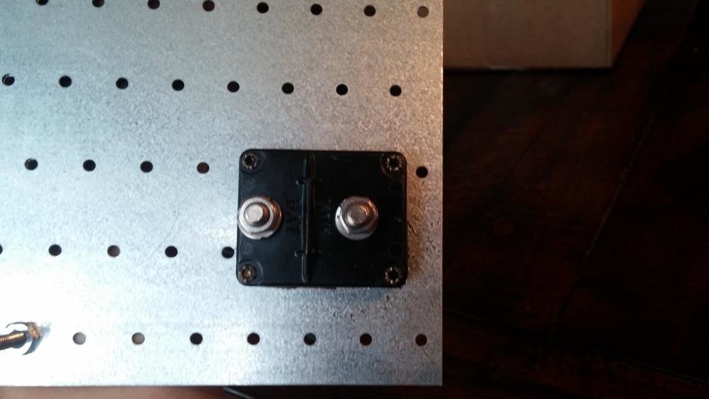

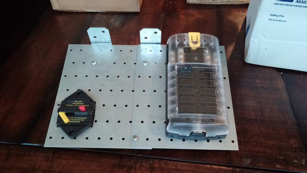

    Now for the good stuff... I FINALLY got around to installing my blue sea fuse box and circuit breaker. I made my own mount from some supplies i bought at home depot. Pretty sturdy, we'll see if it lasts. 1101141258_zps77igqq5w_0ecf4536d9c0e64d119717a2b495a2015e67d74d.jpg
    I used a dremel to cut out the spot for the circuit breaker so it sits flush
    The final product all wired up. I used techflex to cover the wires, and also heat shrink to seal the ends of it off and clean it up even more.1102141327_zpsicphfvnf_2c13057e8e5d7e62bc595ff8e6226ca561d6423b.jpg

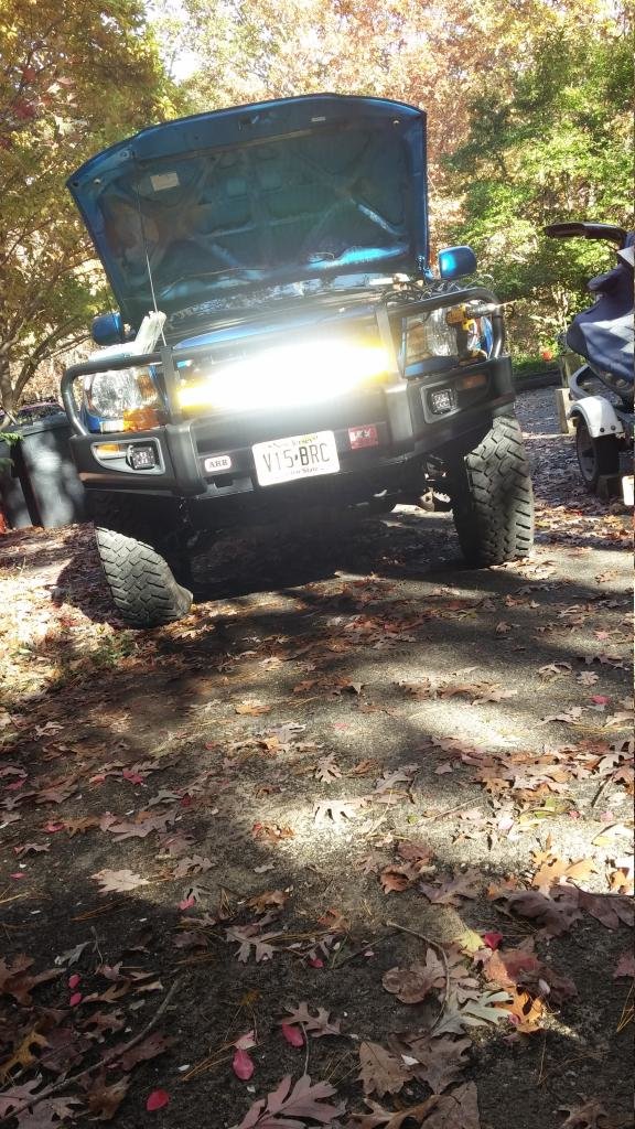

    Next is all my new lights.. I replaced the ARB fogs with a pair of 3inch LED pods. Got creative with the mounting but got them in nice and tight, they aren't going anywhere. These pods are WAY brighter then ARB fogs. Also got another pair of pods up on the windshield with some amber covers that are removable for when i want more light. Lastly, i have a 32inch LED Bar installed on my bumper. Thanks to my buddy Nick who helped me out with the install. Phil... ya came up short on this one.The Bar fits perfectly across the bumper and is bright as hell!! I ordered some amber covers for the bar too, mostly for rock protection but also to cut through fog and dust better then just the white. This is what it looks like with all the lights off.1102141407_zpsjnlbja2w_82db601507f8848f91968b5931250e9f3a05da13.jpg
    Just the bar.. during the day. i have amber covers on the end in this pic.
    And with everything on....
    I hooked these lights up to some new OTRATTW switches i ordered. I'm putting them in the sunglass holder, with the six switch holder. Haven't put them in their permanent spot yet but it should be done by this weekend. Overall, I'm super happy with the setup and I'm pumped for the next night run!!

    How difficult was it to install the blue sea fuse box and circuit breaker? Were there any "how to's" you followed? This is on my list of things to do, I'm always hesitant to do electrical stuff on the truck for fear of irreparable damage. ;)

    Honestly, it was not that hard. The hardest part for me was actually getting all the wires prepped and crimped before hooking it all on. After that, its just connecting the blue sea to the circuit breaker, and then the breaker to the battery. Then grounding it. As far as damage goes, this really wouldn't cause anything that would damage you're truck. Its basically just a neater way to have all your wires organized. If anything, its a bit safer bc of the circuit breaker, it'll flip if you ever do draw too many amps. Im definitely happy with the setup and its a big plus to have

    So the prep/crimped pieces I'm assuming you're referring to the wires coming from your various new lights. Or are there any wiring needed to be done to the fuse box coming from the looms from battery and ground?

    The wires from the lights are easy, that just consists of putting the fuse into the blue sea and then connecting the wire likes.. The long part was prepping the large 4ga wires that are connecting the blue sea to the batteries. Crimping the rings required me to actually go out and buy a large crimping tool. Then after that i used the tech flex and then heat shrunk the ends. Overall setting the 4ga wires up probably took me the longest to complete.

    I could probably look this up, but I'm going to ask anyway. Is all that stuff supplied when you order the fuse box? Wires/techflex/etc?

    No, i bought the fuse box at a local boat shop around town. Everything else i ordered online. I used this list from another thread to buy my supplies. I didn't get the tsunami volt meter though and made a different mount from supplies i bought at home depot
    Items Needed:
    - (1) 6" x 10" (16ga) sheet of steel
    - (1) 10" piece of right angle steel
    - Blue Sea Fuse Holder
    - Blue Wave Circuit Breaker (something similar)
    - Tsunami Fuse Holder w/Voltage Meter (or something similar)
    - About 5' of 4ga wire
    - About 1' of 1/2" shrink tubing (I used red and black)
    - Gold Rings for connecting 4ga wire
    - Not needed but I also used TechFlex to cover the 4ga wire
    This is the other thread too:
    http://www.tacomaworld.com/forum/2nd-gen-tacomas/103200-blue-sea-fuse-block-install.html
