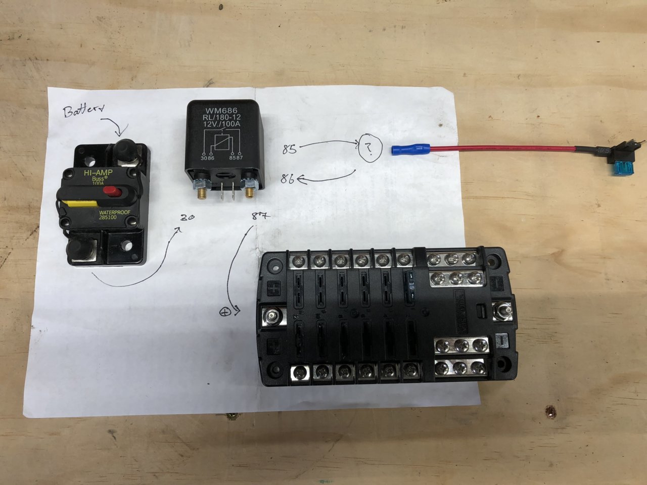

    Hi guys,
    Thanks to everyone that's explained so much of this so far, it's been a huge help. I'm working on adding the anytime camera mod as well as a front camera. I already have a light bar in the front bumper so I figured now would be as good a time as any to put in an aux fuse box so my wiring doesn't get too messy. It's a 2018 TRD OR.
    My question is this: I want my aux box to shut off with ignition since I'm super paranoid about draining my battery when I'm out camping. I have a beefy relay to put between the breaker and the new fuse box but where do I connect that relay to for ignition control? Should I use an add-a-fuse to an existing circuit, and if so which one, or is one of the open slots in the box ignition controlled?
    Please also feel free to criticize my wiring if I'm doing something dangerous.
    I do have a second question about how to make the new switches in the cab light up when the headlights are on but maybe that's for a different thread.
    Thanks!

    It doesn't matter if your relays get power from a fuse box connected to the battery. As long as the switches that activate the relays are powered from an ignition only source it's simply not possible for the battery to drain through the relays unless the ignition is on and a switch is pressed. So it's not necessary to also have a relay power the entire fuse box. If you want to anyway you'll need a high capacity relay or solenoid that is activated by an ignition source and also has a feed from the battery and then on to the fuse box as well as a ground connection.
    Typically the connections are:
    12V connection to activate the relay
    Ground for the activation side
    12V main power to the relay
    Output from the relay to the fuse box
    This also describes common 4-pin relay connections, 5-pin relays differ only in that they can used as either/or switches as well as on/off and off/on.
    For switch illumination keep in mind the switch function is mostly separate from the led function(they are separate circuits inside the housing). I say mostly because each switch usually has 2 leds, one that is always on and one the comes on with the switch(always on needs a separate 12V supply, both need ground of some sort to come on).

    As far as the question mark on your 100A relay goes, try this:
    Add-a-fuse from ignition only source to one of the spade connections and chassis ground (battery -) to the other(pins 85 & 86). Relays are non polar so it doesn't matter which is which(same goes for 30 & 87 for main power). If you want you can route activation power through an "auxiliary power" switch for even more unnecessary redundancy. If you choose to use a switch get power from the internal fuse panel, if not use the one in the engine bay just be sure in either case that it's an ignition only source.

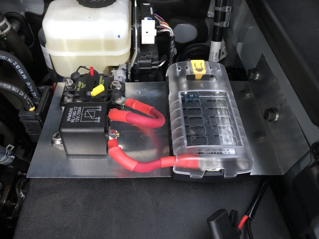

    Thanks so much for the comment. I think I’ll just try adding an ignition only circuit to the main relay to cut off the aux box.
    I also just learned the hard way that connecting a positive the the battery and then brushing it against my aluminum plate completes a circuit. Which makes a lot of sense in hindsight (see small crescent shape by the breaker).
    Below is the test fit before I ran out of light. I’m still tinkering with hot to fit everything together.

    Yeah, pretty much every piece of metal you see has some connection to the chassis and ground. That's why you disconnect B+ first and reconnect it last after your done waving wires around.
