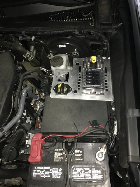

    Step one complete:
    ChadsPride and 303tacoma like this.
