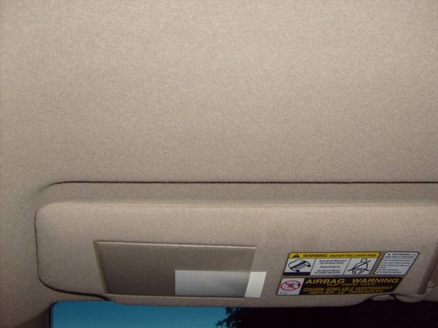

    A few weeks ago I purchased a BlueAnt Supertooth Light handsfree speakerphone based on bauermike's glowing review. But I quickly ran into a problem. As light as this speakerphone is, it still drags my visor down into my field of vision when using the supplied visor clip.

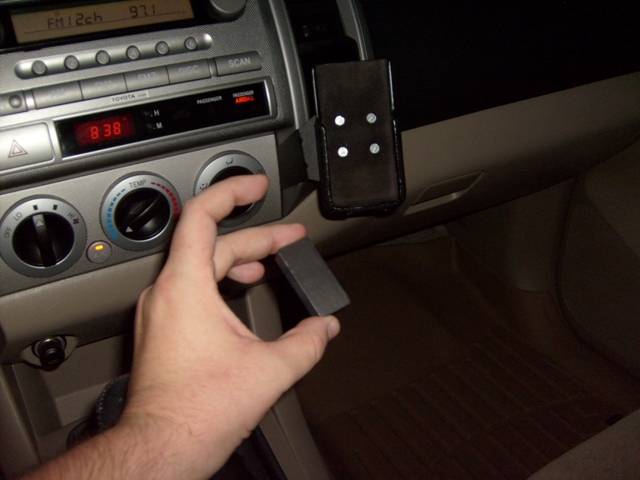

    I went to Home Depot and found some magnets like this for about $3

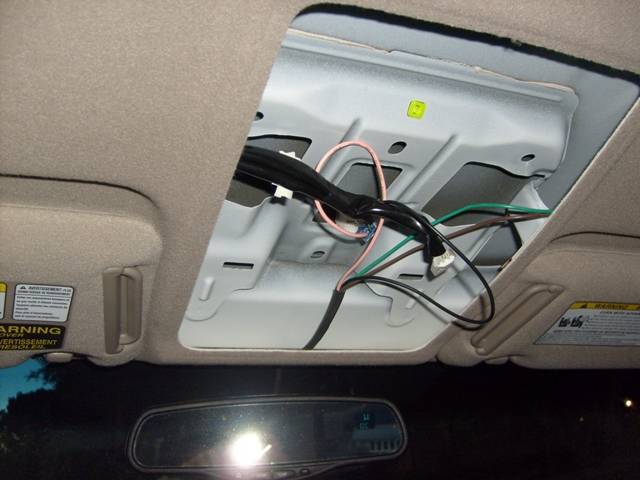

    I pulled down the overhead console

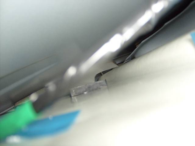

    I put some superglue on the back of the magnet, slid my arm between the roof and headliner and guesstimated where I wanted the magnet

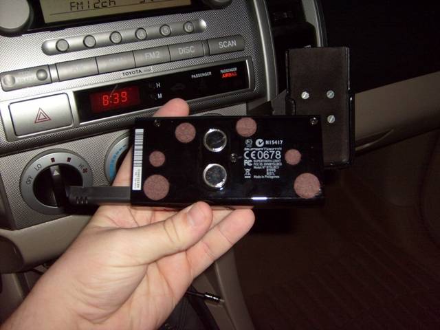

    I put some stick-on felt pads on the back of the unit which provded just enough friction to keep the unit from sliding down

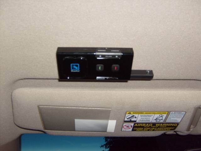

    So here's the view after the superglue is dry, and the magnet is in place
    And here's the BlueAnt Supertooth Light hanging magically above my head, out of my field of vision!
    It works great, and from what everyone's told me, the mic is in perfect position so that I can still be heard clearly.
