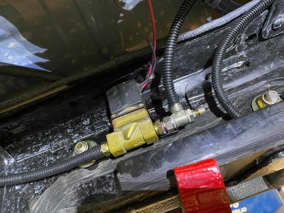

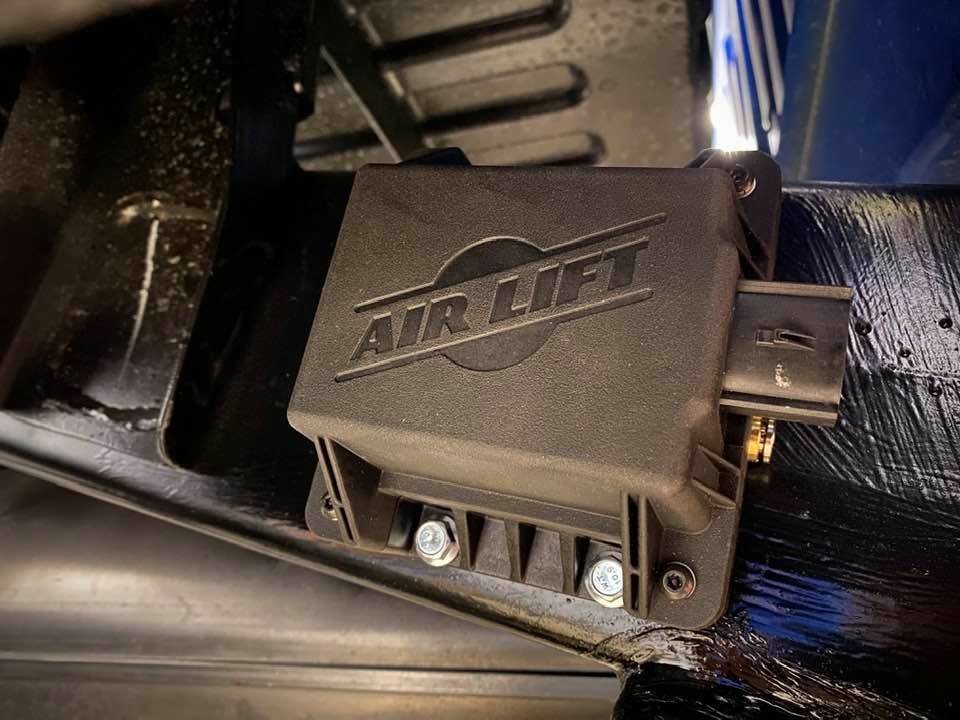

    Splurged on a fancy pants air controller but I really hate that it came with built-in 1/4" push to connect ports.
    Now I'm forced to run both 1/4" AND 6mm air line on this truck.
    And yes, I looked everywhere for an adapter that goes from male 1/4" to push to connect female 6mm port.
    Not a thing in North America. could only find 1 option in Germany and that's it.

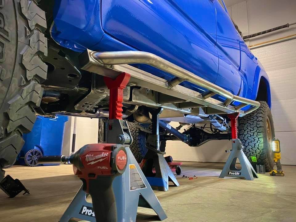

    and mocked up some sliders (this is before I made some more mods like the ones listed below)
    These are the BAMF bolt-ons but I spent some time modifying some things to my liking.
    - had to trim the rear to fit the 63" spring hangers
    - added clipping points to where the frame plates eliminated the stock wire harness clip points on the frame rail
    - removed a bunch of unnecessary steel, probably saved 5 lbs+
    - cleaned up some welds to my liking
    ready to prep these for paint next.

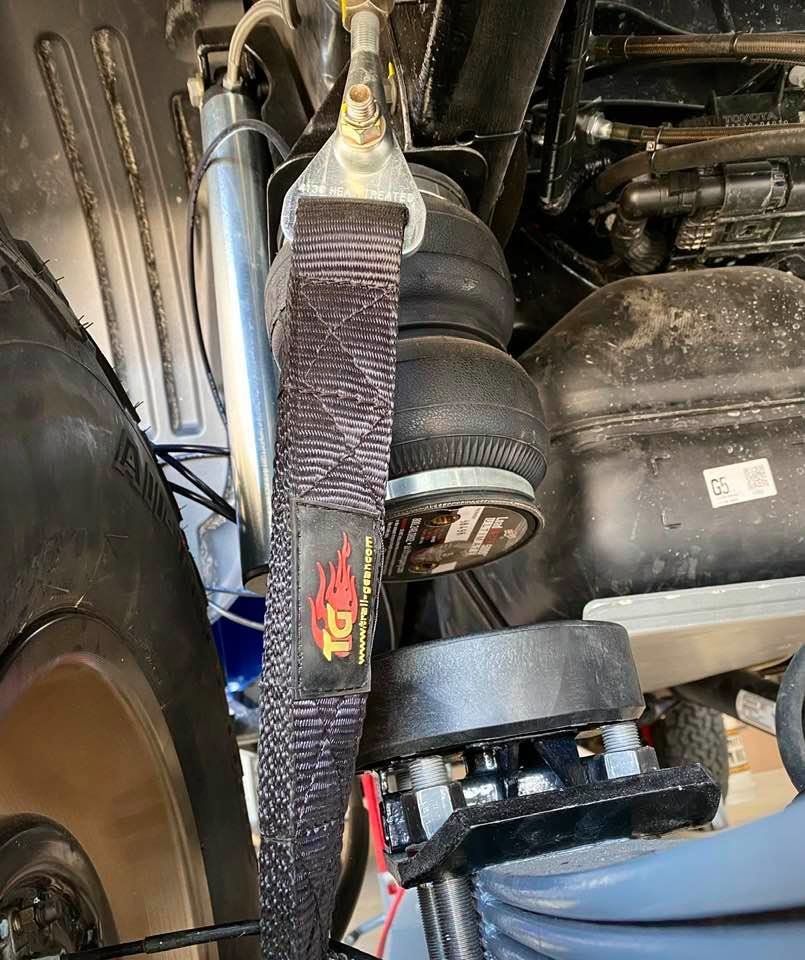

    Another question, do your limit straps ever rub on your tires? I really like where you put yours vs where I put mine.
  6. Feb 14, 2021 at 8:49 AM
    #46
    Blueberry.Taco
    Blueberry.Taco [OP] blueberry.taco (IG)
    Sep 14, 2020
    #340806
    865
    Ryo
    SE MI
    LT, triple locked, 35s, custom aluminum utility bed with FWC
    some welding required
    right now the total distance the truck has moved since I put the straps on is about 0.5 ft, so I can't answer that question at all, but the trail gear straps I got have a 'bias' for lack of a better word on which way they fold, and I have that pointed inwards. They should just bend towards the leafs rather than the tires, but maybe that's me being optimistic.
    but to answer your question, no, they have never rubbed the tires in ALL the driving I have done so far of 0 miles :D

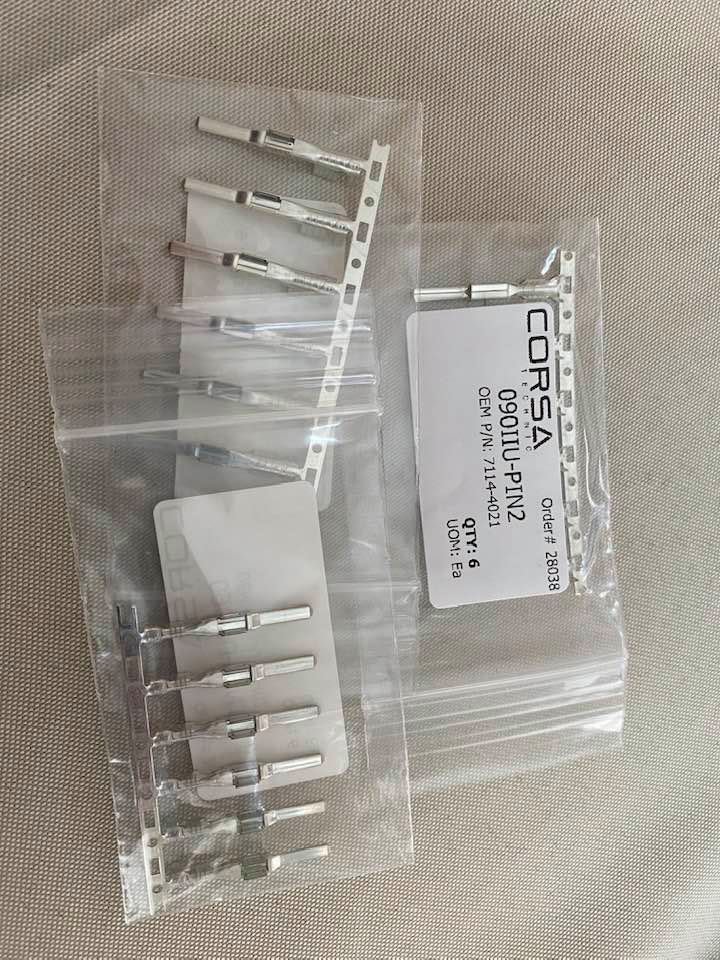

    I'm committing to spending money to source OEM connectors and pins to create little subharnesses rather than cutting the stock harness.
    Even though I have plenty of experience and success building engine harnesses and such (see v8 swapped Blazer), not cutting the stock harness in any ways is for sure the best long term reliability.
    Reliability > $&time

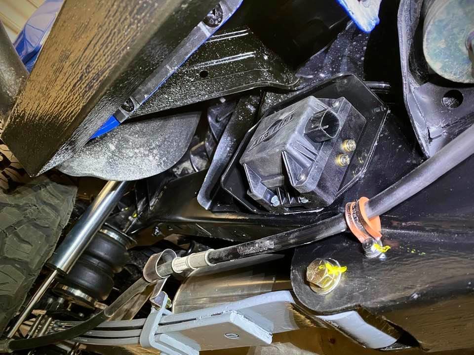

    Got the rock shield mounted up with the airlift manifold
    154959488_10114667241517243_255638316271_b07b44648e14563ddb8227847fb512193181eabd.jpg

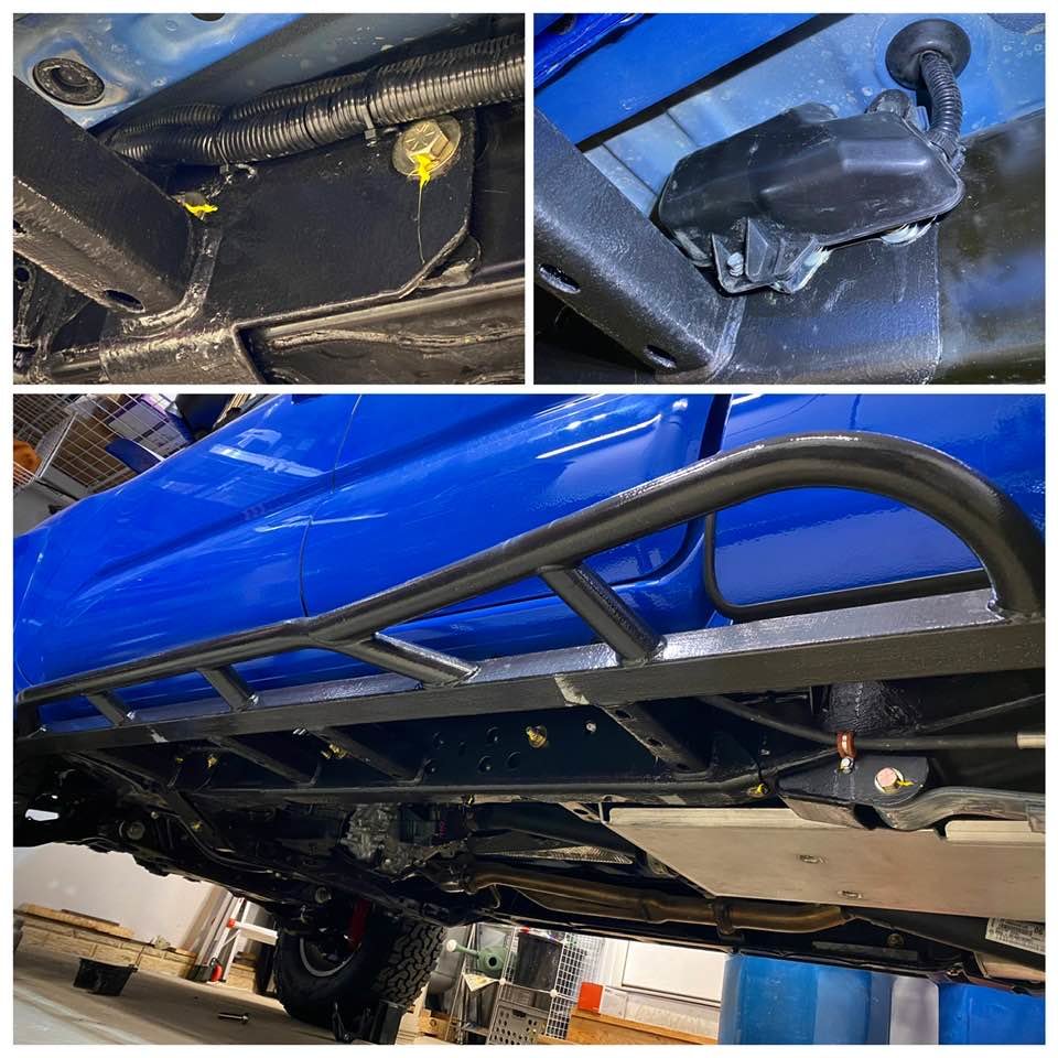

    modified BAMF sliders fully on now.
    Adding zip tie loops and relocating gussets for clearance to stock components in original locations a success. (installation instructions tell you to just shove the bracket over one bolt hole and hack it together which wasn’t acceptable for me, and the stock wire loom would just be dangling because one clip point hole is covered up now.
    154147182_10114669000646933_113535411699_414602b8802752ce727d2f91461250b72789c8ff.jpg
    below pic from installation instructions... look at that bracket shoving right up into the body grommet!

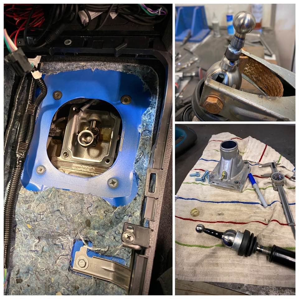

    And then Manuel got separated from his tranny and got his shaft extended for better feels
    149790293_10114669025701723_720726412825_dd135caf6c9a6065ac0092cff956b4cb20aaec5a.jpg

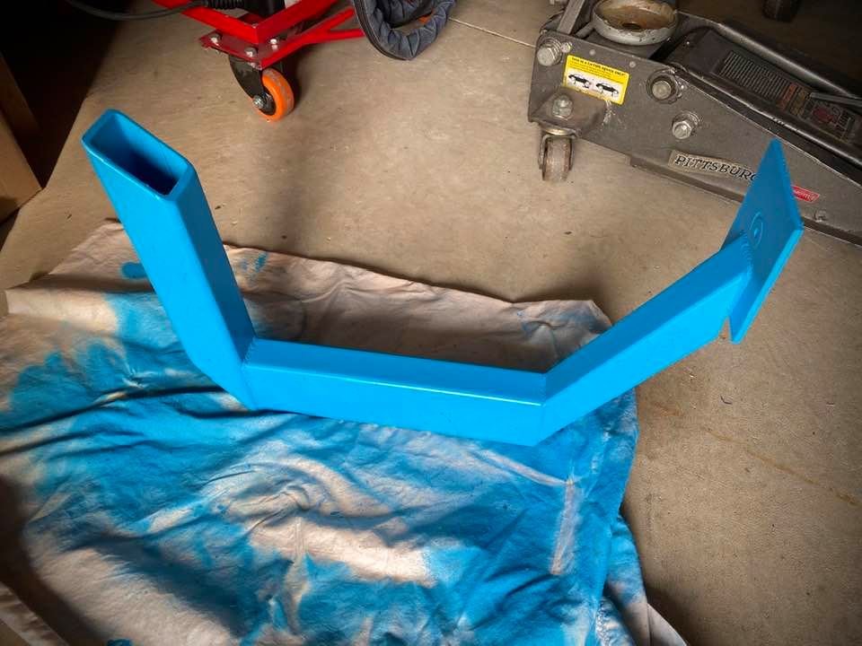

    I love when the scrap metal I am always hoarding works out perfectly.
    managed to make this useful tool without making a single cut, all the pieces worked out by just welding them together.
    can you guess what it is?
    154162906_10114672485133993_877904930758_593106031a0d4fb6ecb0c492eb0aa05d56bbc431.jpg

    Some sort of alignment tool?
  14. Mar 1, 2021 at 3:11 PM
    #54
    jenot
    jenot Well-Known Member
    Sep 4, 2020
    #339759
    48
    Uh... a really unaerodynamic horseshoe?

    A step.

    something to do with the spare tire? :confused:

    Kind of... sort of...
    are regular horseshoes aerodynamic to start with!?
    everything can be a step, just like it can be a hammer
    Nope, nothing to do with the spare

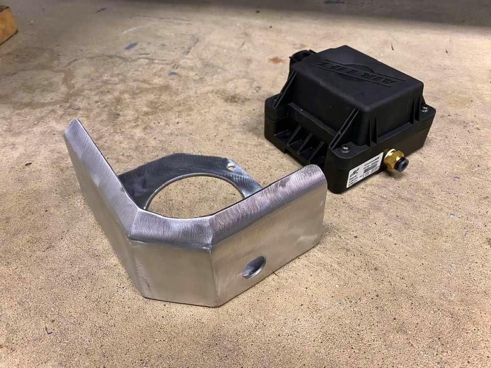

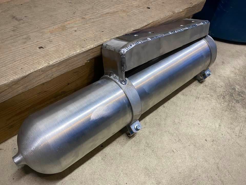

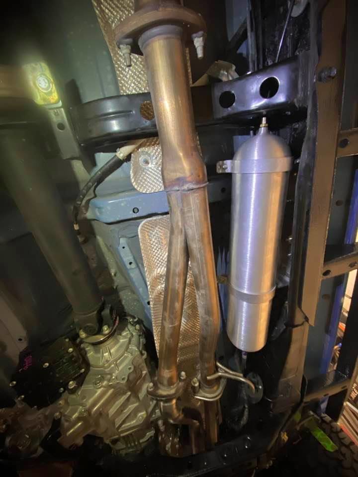

    Got around to making a nice lightweight aluminum mount for my nice aluminum air tank
    156189307_10114696661090183_716687237189_1f961a1def5e539f2d8400035ddf3082473d476b.jpg
    and got it tucked up in the frame rail.
    It should never drag on anything here.
    156822708_10114696663415523_573180384176_510a4a2e8a7912e01ed65fa65e573fec8995d12c.jpg

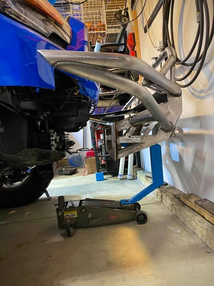

    and used my fancy blue tool to hold up the front bumper so I can move it on and off by myself while making incremental cuts in the bumper cover and mocking up more tabs to weld on.
    I finally finished up everything (fingers crossed) and dropped it off at the powdercoaters too.
    157953099_10114700216445223_616571780040_0030f9dfd7e86c0928f98125bac5b13740eacd67.jpg
