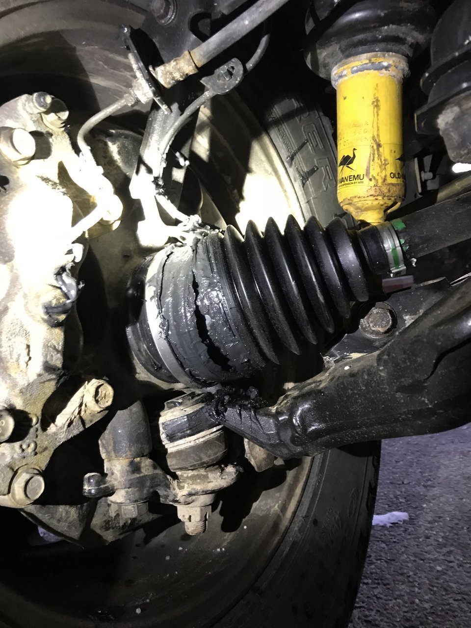

  7. Jan 18, 2018 at 2:50 PM
    #507
    Bocsy44
    Bocsy44 [OP] Well-Known Member
    Mar 30, 2016
    #182850
    5,196
    Erik
    Ottawa, ON, Canada
    09 DCLB Sport
    This that and the other thing.
    :eek:
    did the boot rip or did the strap thingy slip off? is that the new boot you just put on?
    MarX and EatSleepTacos[QUOTED] like this.
  8. Jan 18, 2018 at 2:50 PM
    #508
    Kemosabe
    Kemosabe Little bitty life
    Apr 2, 2015
    #152362
    6,198
    Louis
    Western Quebec, Canada
    2010, 2.7l, 4x4, M/T
    URD STS, Spidertrax spacers, AFE Pro dry
    It is in the future ;)
    Edit: it is no more haha
    :eek::eek::eek:
    What happened?
  9. Jan 18, 2018 at 2:51 PM
    #509
    EatSleepTacos
    Mar 24, 2015
    #151688
    59,840
    Randy
    West Valley, AZ
    2017 4Runner
    I just made my post in the lair, but the damn thing just slipped off! The way the clamp is designed, it couldn’t physically get tighter, so I have no idea what I could have done differently.
    MarX and Kemosabe[QUOTED] like this.
  10. Jan 18, 2018 at 2:53 PM
    #510
    Bocsy44
    Mar 30, 2016
    #182850
    5,196
    Erik
    Ottawa, ON, Canada
    09 DCLB Sport
    that's not cool. how do u feel right now? I wouldn't be trusting the other side either if u redid that one too
    MarX likes this.
  11. Jan 18, 2018 at 2:53 PM
    #511
    Kemosabe
    Apr 2, 2015
    #152362
    6,198
    Louis
    Just red it... at least the boot is not broken! Have you thought about using some piping clamps?
    MarX likes this.
  12. Jan 18, 2018 at 2:54 PM
    #512
    EatSleepTacos
    Mar 24, 2015
    #151688
    59,840
    Randy
    West Valley, AZ
    2017 4Runner
    I don’t trust it either.
    I may just redo them all with hose clamps and drive them till they break.
  13. Jan 18, 2018 at 2:58 PM
    #513
    Bocsy44
    Mar 30, 2016
    #182850
    5,196
    Erik
    Ottawa, ON, Canada
    09 DCLB Sport
    I'm surprised they don't just use those in the first place haha u can buy some stainless steel band clamps. that's probably the route I would go lol

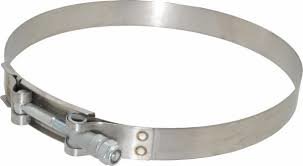

  14. Jan 18, 2018 at 2:59 PM
    #514
    Bocsy44
    Mar 30, 2016
    #182850
    5,196
    Erik
    Ottawa, ON, Canada
    09 DCLB Sport
    something more like this one tho, so the little holes in the regular hose clamps don't rip into the rubber boot while u tighten it
    MarX and EatSleepTacos like this.

  18. Jan 18, 2018 at 5:02 PM
    #518
    Kemosabe
    Apr 2, 2015
    #152362
    6,198
    Louis
  19. Jan 18, 2018 at 5:05 PM
    #519
    EatSleepTacos
    Mar 24, 2015
    #151688
    59,840
    Randy
    West Valley, AZ
    2017 4Runner
  20. Jan 18, 2018 at 5:07 PM
    #520
    Kemosabe
    Apr 2, 2015
    #152362
    6,198
    Louis
    Sure seem like an easy way, but with rust and stuff I knew the lower Bj bolts were easier to take off than the lca bolts and tie rod lol
