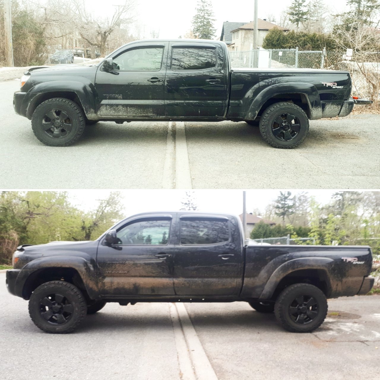

    How It Sat:
    How It Sits:

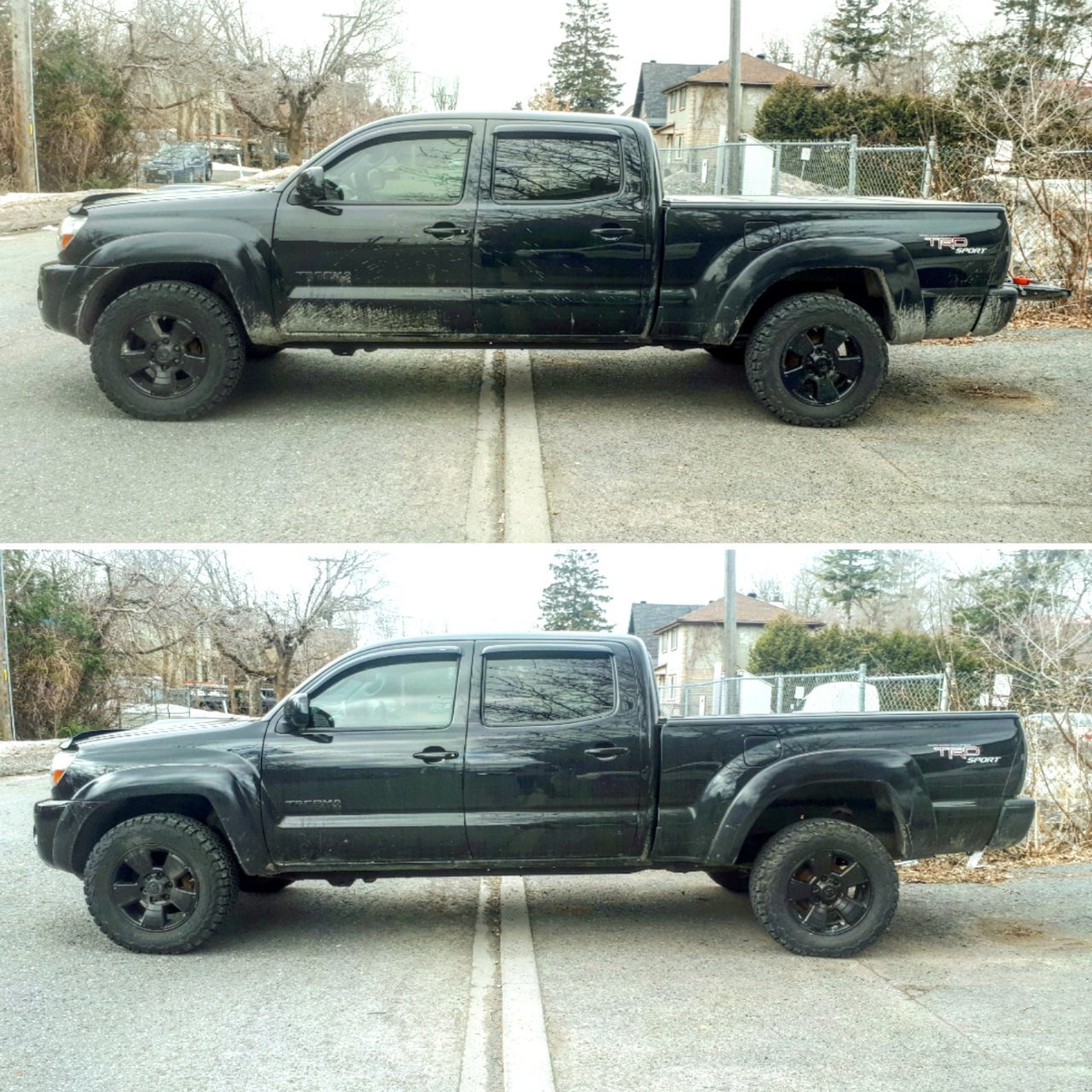

    Before and After Lift:

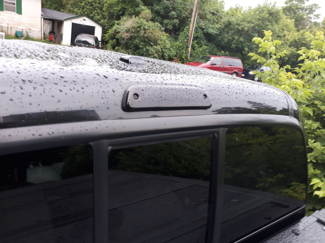

    I did not like the RED lens on the third brake light so I ordered a smoked lens off the interwebs. It came in the mail and I was really excited, when I installed it, it had this ugly purple colour to it. So I took it upon myself to VHT night shade that shit, now it looks awesome! haha but I put one too many coats on and u can barely see any light thru it hahaha

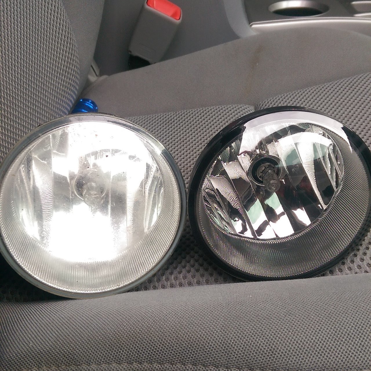

    My Fog Lights were looking pretty faded so I ordered some "smoked" fogs from Spyder, not as dark as I was wanting but I'm happy with them none the less.

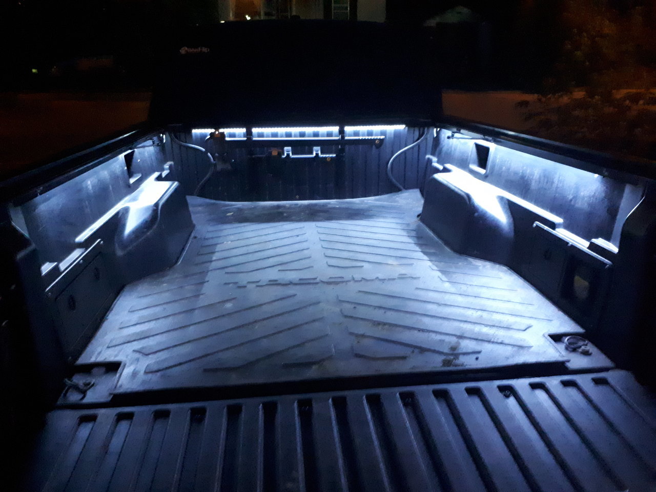

    Bed Lights from Mattgecko

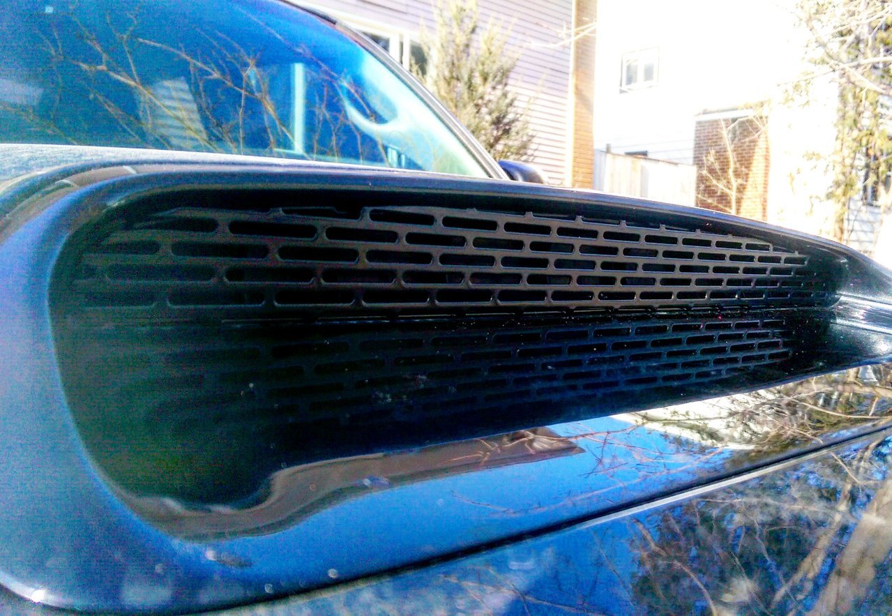

    Hood Scoop Mesh Insert from HomerTaco

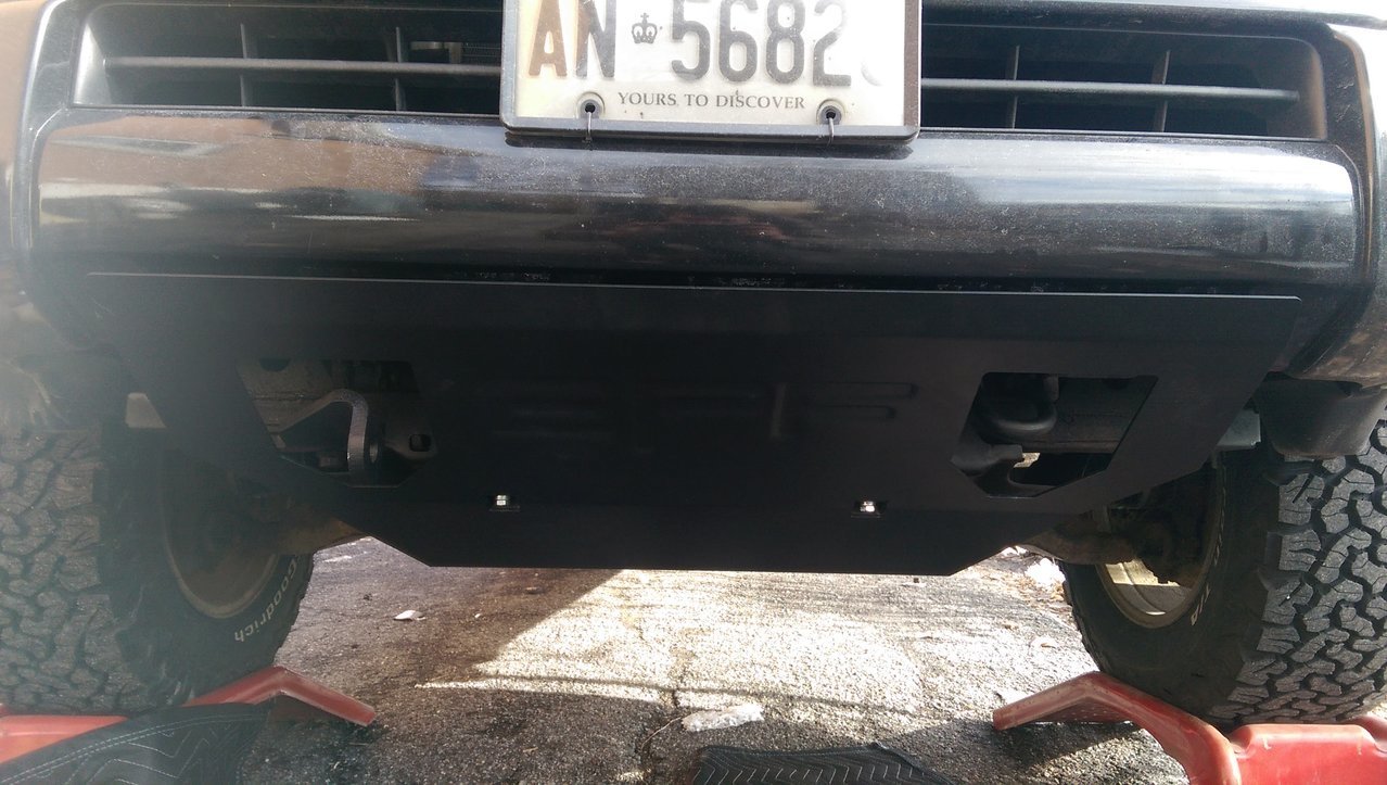

    Bullet Proof Fab Skid Plate and Tow Hook

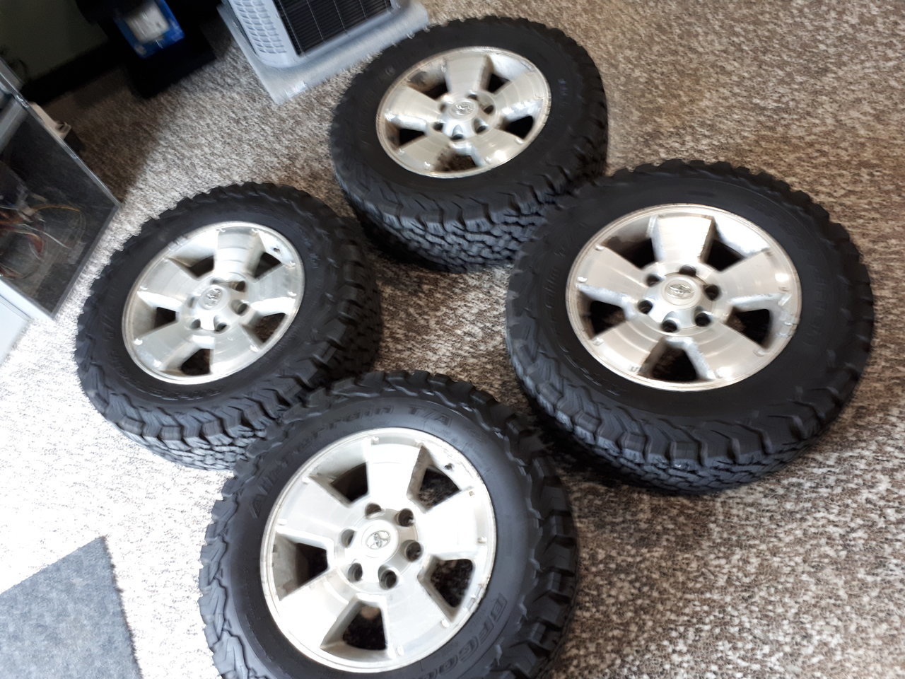

    Next up, was my OBA set up on a budget. My rims were in pretty bad shape, the aluminum is oxidising so bad that my rims leak air, so once a month I had to add air, now I can do it on the go.
    I bought myself a Viair 70P compressor because I wanted it to be small enough to install into the big cubby in the bed. I had to modify it by removing the handle and the pressure gauge. I didn't use the supplied hose and installed a quick connect instead. The issue I did run into is that the hose supplied has a built in pressure relief valve, so I did buy an adjustable PRV off Amazon and added that to the compressor, I adjusted the PRV so release pressure at about 30PSI. I did this so that while I fill my tires, once the relief valve lets out air, I know my tires are up to pressure. I keep the hose and all the accessories in the Viair bag behind the rear seats.
    once this compressor fails I will be investing into an ARB dual air compressor and installing it under the hood with the SLEE bracket that places it by the windshield washer fluid reservoir.

    Rear Lift Installed
    Front Lift Installed

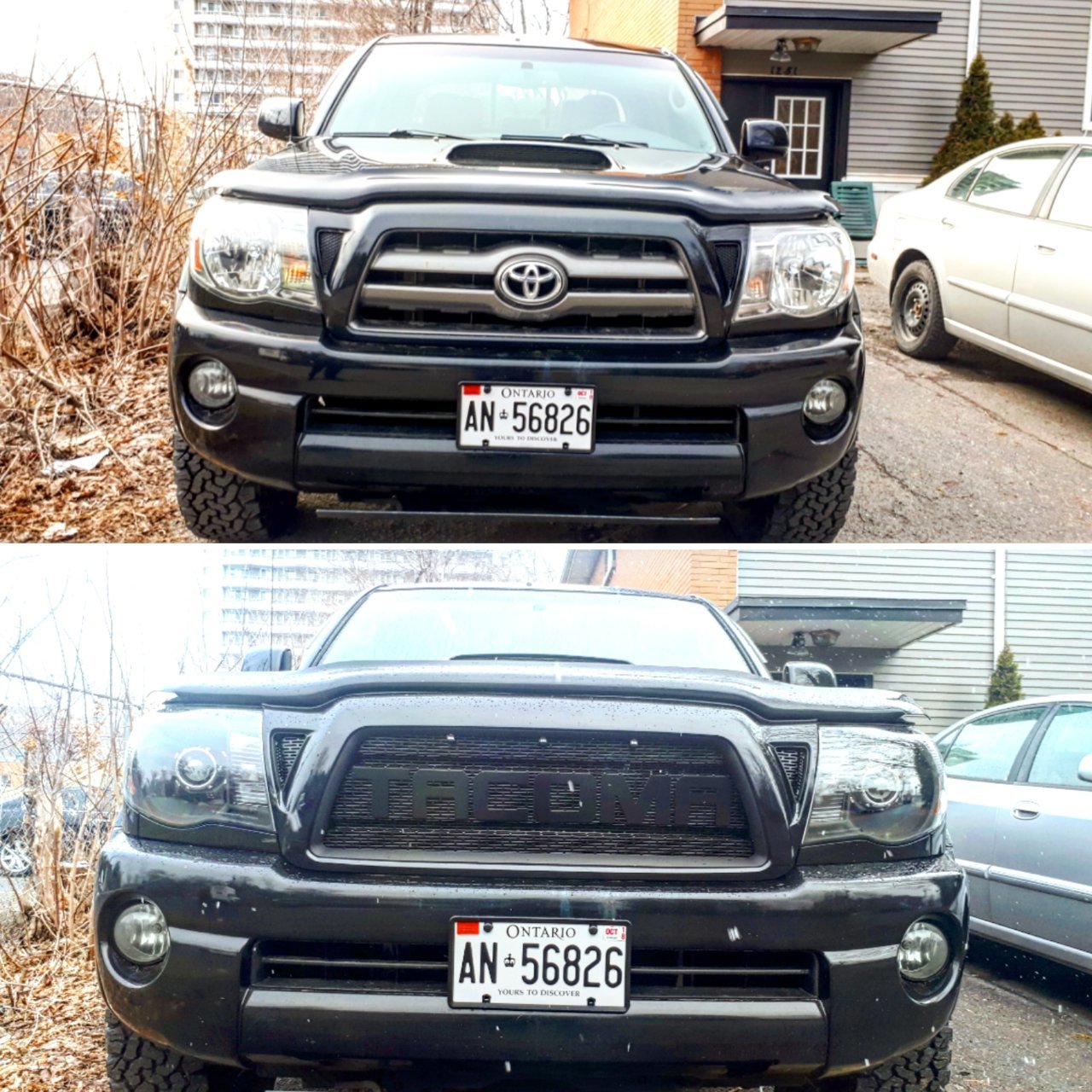

    New Grill and Headlights

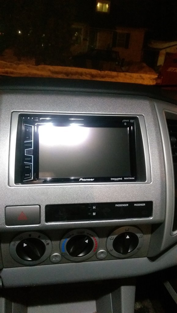

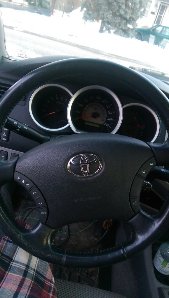

    I upgraded my head unit with an AVH-X2800BS and I used the Metra Dash Kit.
    Not long after doing this upgrade, I found out you can add some Bluetooth steering wheel controls to the right hand side of the steering wheel. I did a full write up HERE.

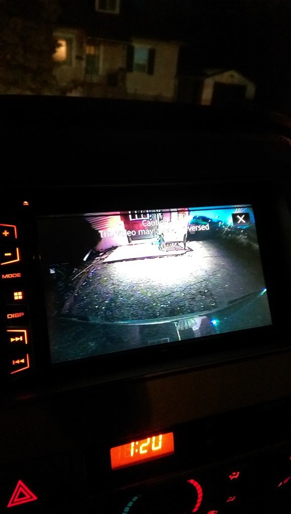

    While I was at it, I also hooked up my rear view camera to my head unit using this thread:
    https://www.tacomaworld.com/threads/oem-camera-connection-below-dash.30889/

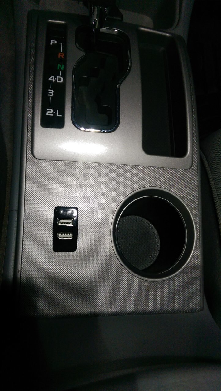

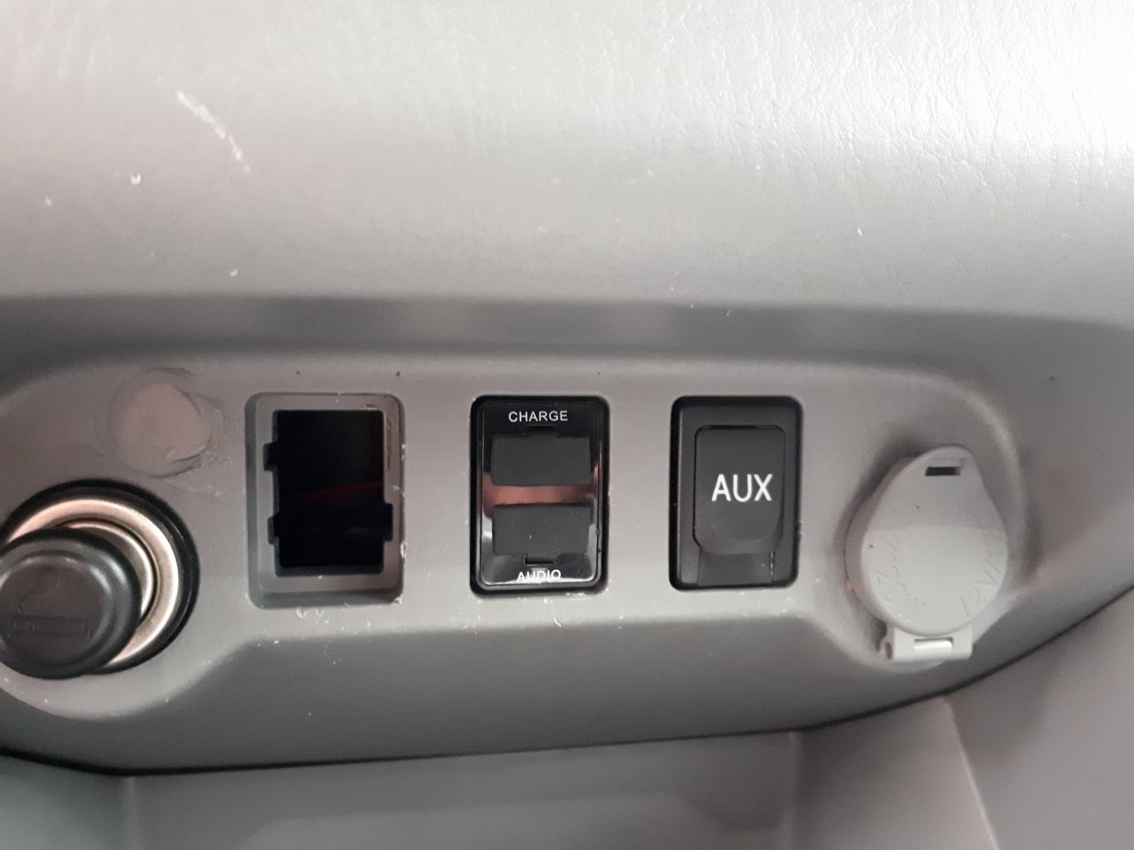

    Since I was messing around with the wiring in the truck, I added a USB/AUX port to the truck. I ordered one from MicTuning which their website said it would fit in the blanks under the AC controls. Well long story short it didn't so this is where I installed it.
    THEN!! a few months after installing it I stumbled upon one that actually does fit under the AC controls hahaha
    http://www.ebay.com/itm/Dual-USB-Po...Lexus-Scion-/262456463133?hash=item3d1b9fcf1d

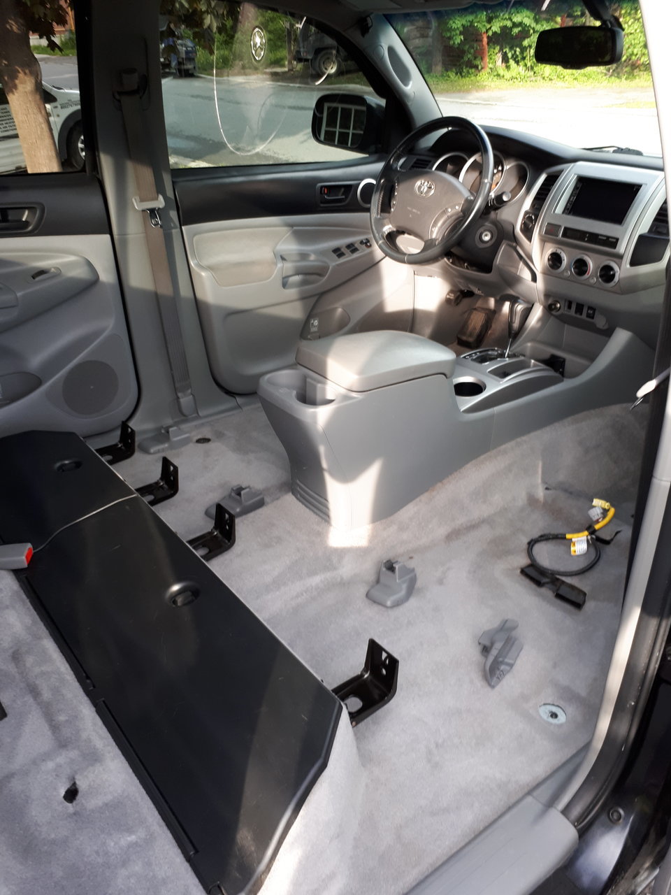

    Made the decision to get rid of my tonneau cover and get a cap. I only had about 17'' of room under the cover which just wasn't enough room. It was hard to fit a good cooler under there, or even stand a propane tank upright. Found one for sale on FB for 400 bucks and came with a roof rack on it.
    I cleaned up the inside, put new screens on the windows, replaced the halogen dome light with the updated LED version, cleaned the outside of the cap, got the rack powder coated and replaced all the rusted hardware. Designed a better mounting system for the rack to help keep the water out. Replaces the fiberglass piece on the bottom of the window because it was broken and wired up the 3rd brake light and dome light.
    For the dome light, I wired it to my bed lights so it now turns on with the same remote.

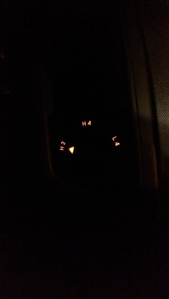

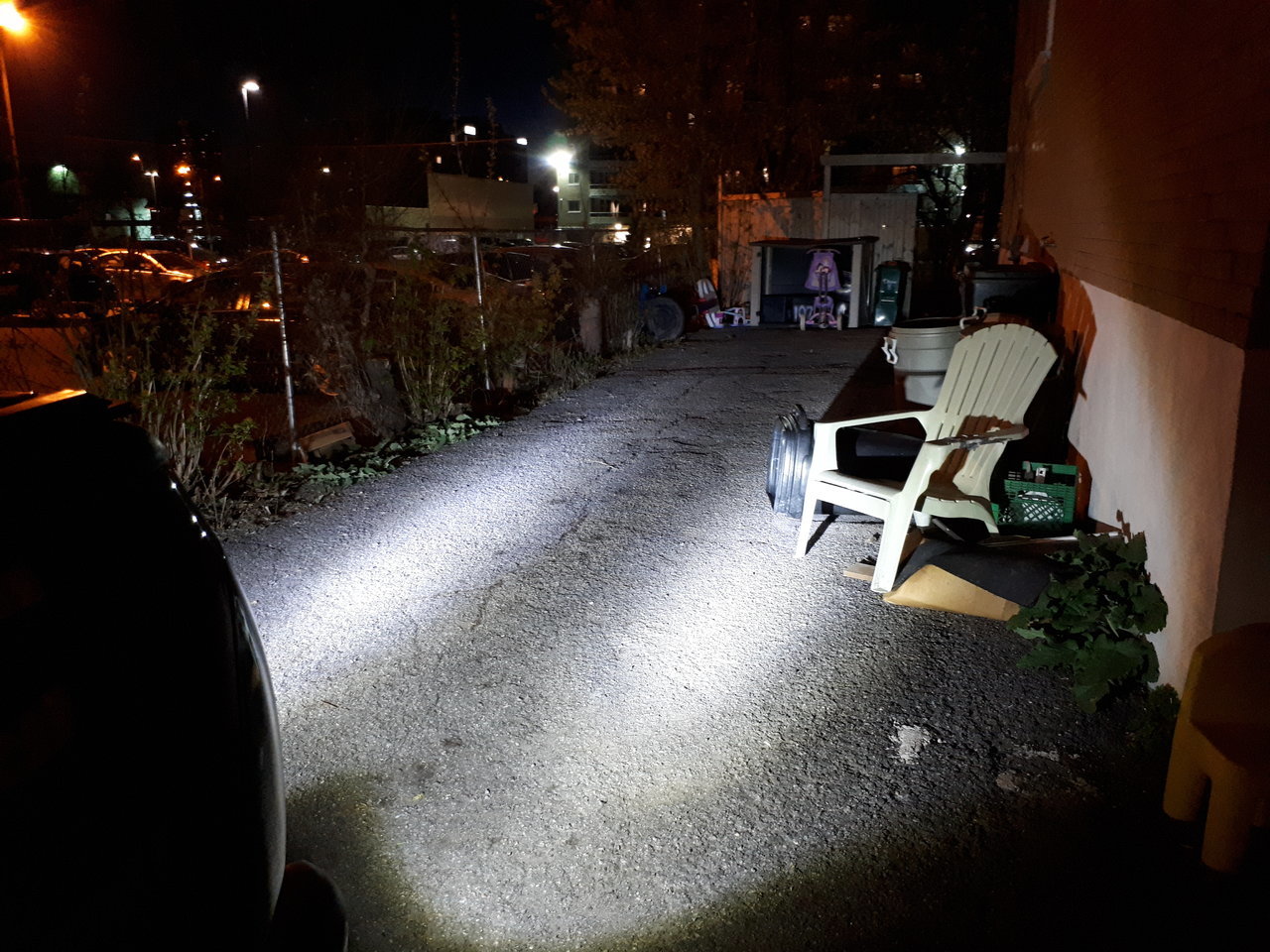

    NEXT up haha my flush mount LED pod install. I bought me some Rough Country flush mounts. the wiring harness is TOO SHORT to reach the back bumper!! so make that baby longer hahaha also make sure you have a lot of cutting wheels for your dremel! or be smart and have a grinder lol anyways! I cut off that piece of crap push button they supply with the wiring harness and installed me a CH4x4 switch instead. DO NOT order the amber! it is more of a yellow then a burnt orange, so if u want it to look close to OEM as possible, do yourself a favor and order RED!!
    for those who care, to wire in the CH4x4 Switch next to the steering wheel and have it DIM with the dash light, do the following.
    you can cut that push button off the supplied wiring harness and hook up the switch real easy. so WHITE from harness would go to GREEN from switch (power from battery that will get sent to energize relay). BLUE from harness goes to RED 1 from switch (this wire sends the power to the relay). then the black from harness I did not use because is it just the ground for the illumination on the push button. I wired my switch to dim with the rest of the dash lights. to do that, on the switch you then have a RED 2(+) wire and a BLACK(-). These are your illumination + and -. I wired them to the dimmer switch to the left of the steering wheel. Green with WHITE stripe is GROUND and solid GREEN is your positive. so RED2 to GREEN and BLACK to GREEN w/ WHITE STRIPE.
    http://www.ebay.com/itm/2005-2015-T...AIR-PLUG-PLAY-/192209615077?fits=Model:Tacoma
    Also notice the LED license plate lights
    Notice here the 3rd Brake light and how little light shows thru due to too many coats of VHT night shade hahahaha

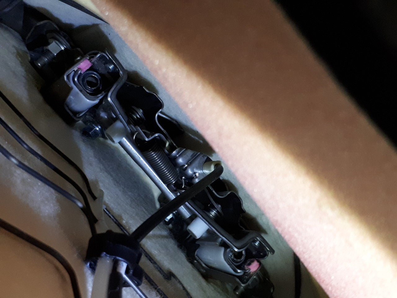

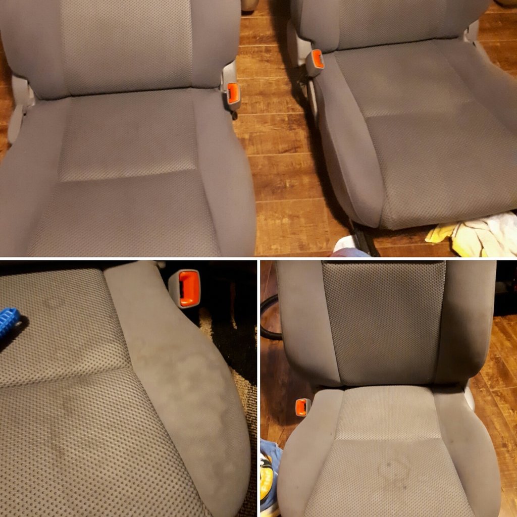

    removed my seats and cleaned those babies up reeeeaaallll niiiceeee!!

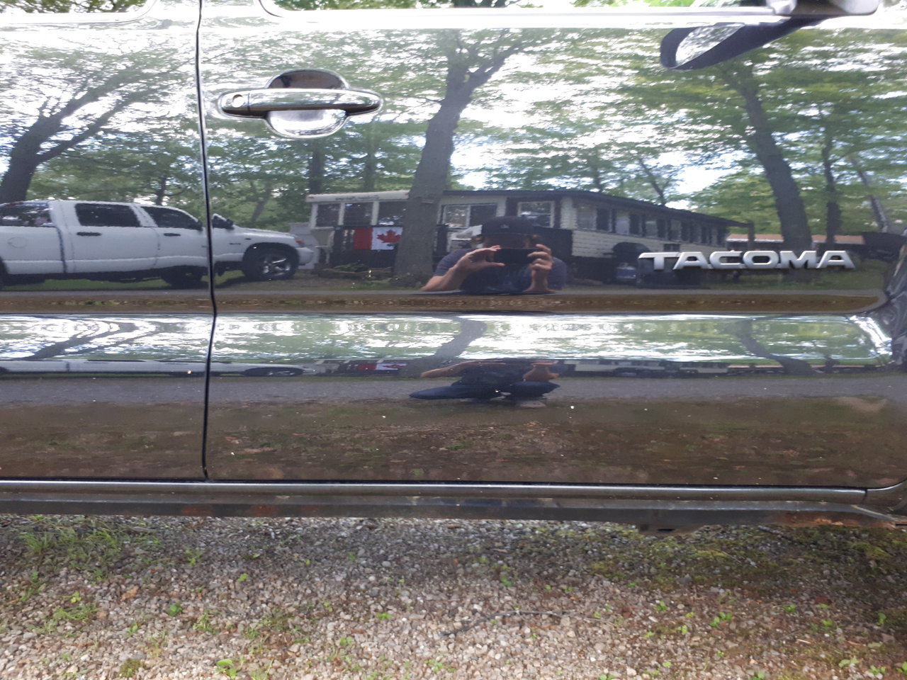

    Since I am talking about detailing, it is a good time to talk about my paint.
    I got my truck professionally buffed and polished, also removed the chrome logos and replaced them with matte black ones.

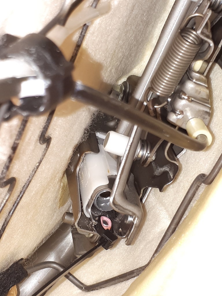

    FIXED HEADREST RATTLE!!

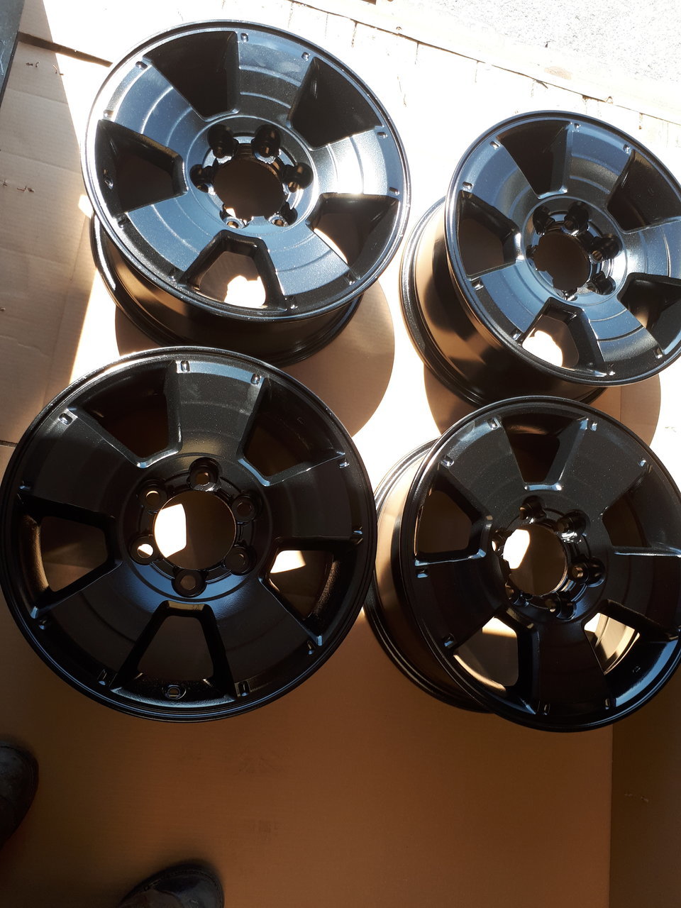

    Got my oxidized to shit rims powder coated black and now they no longer leak air! I also replaced all the TPMS sensors but never calibrated them to the system so the light has been on the dash for like 6 months lol and it surprisingly doesn't bother me.
    BEFORE
    so, long story short, it sat like this for a month while I waited for my rims to get done lol Oh I also installed some 1.25'' SpiderTrax Wheel Spacers.
    AFTER

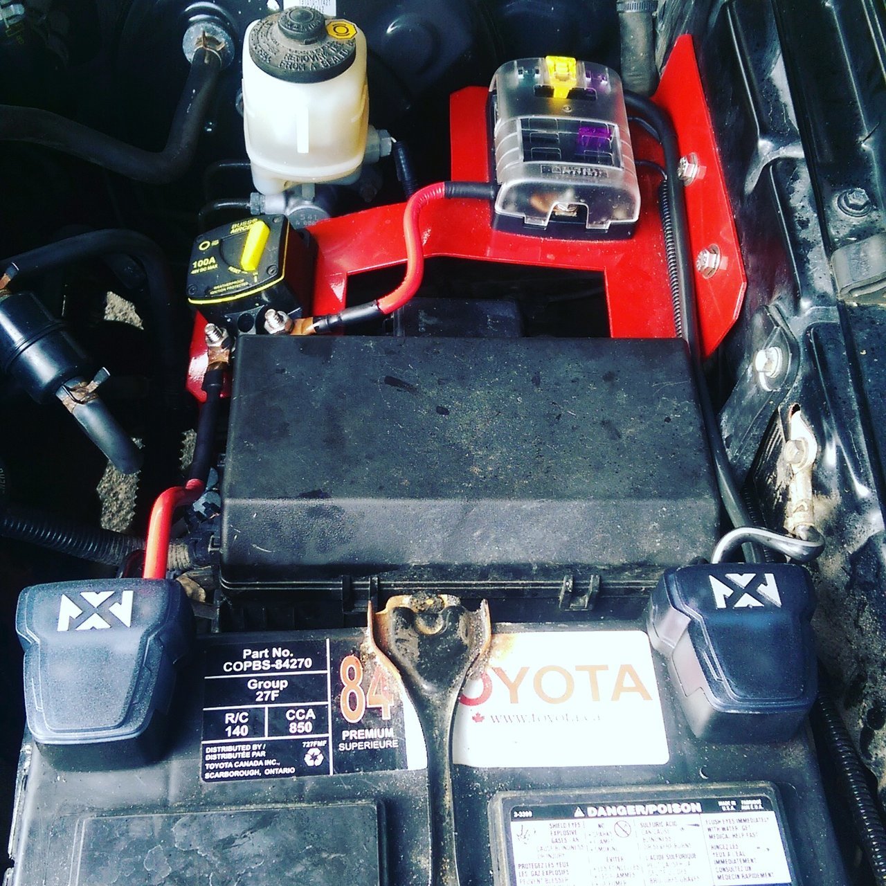

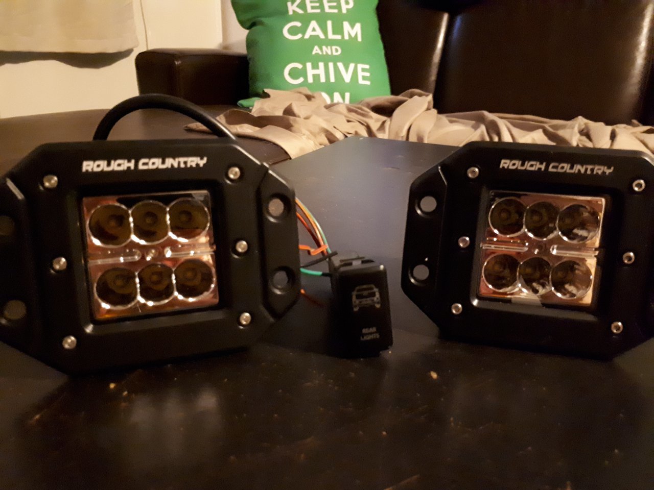

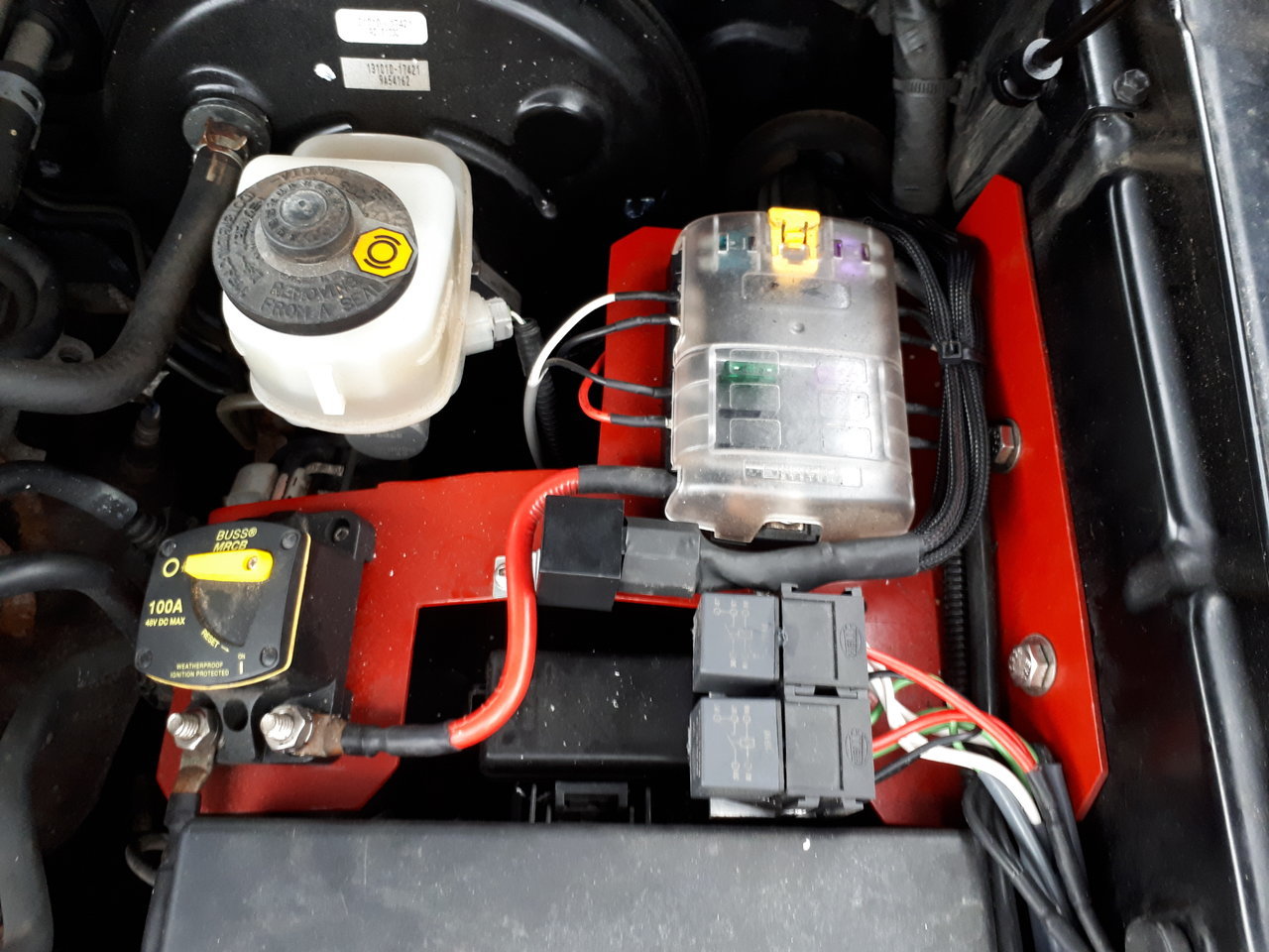

    Maaaann you went full crazy to wire those flush mount led! I've never took apart my dash like that haha! always run my electric wires with a steel wire lol
    How do you like your aux fuse box? I was wondering if it worth having it. Are all the accessories always hot when it is wired in this box or you can add a relay to have them hot with a oem accessory? like ignition switch or parking lights?
