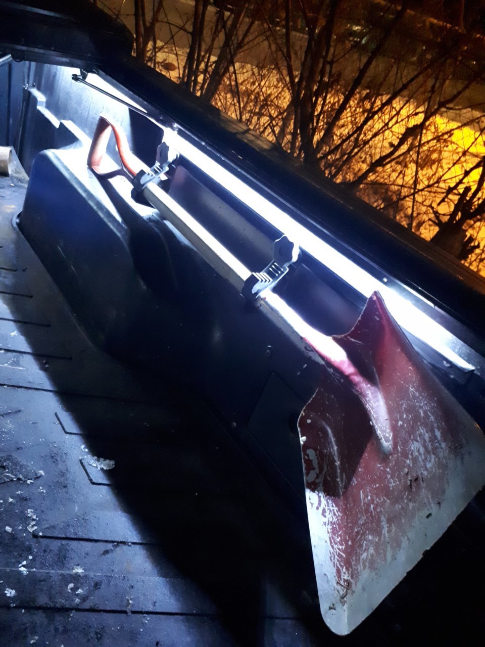

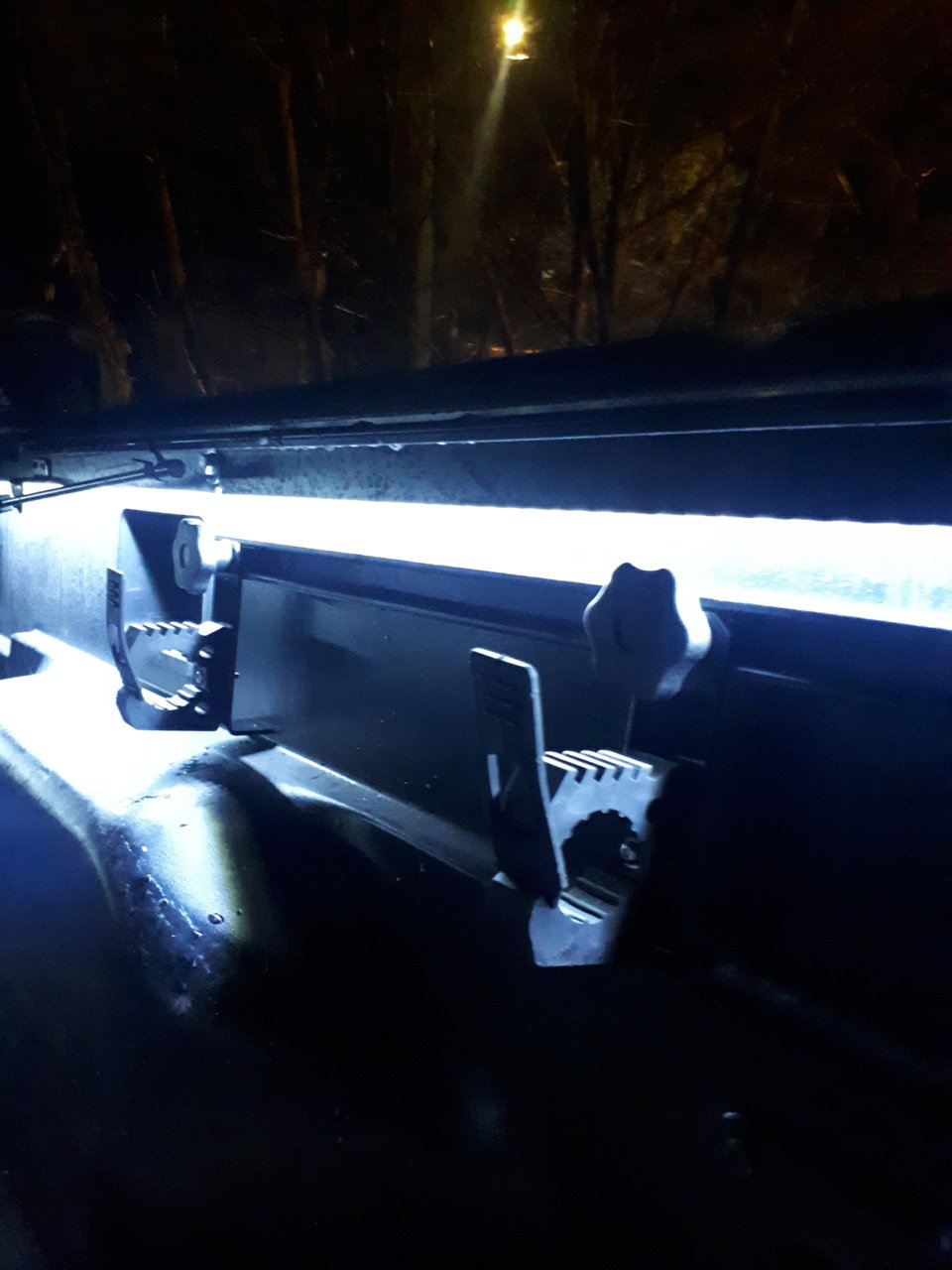

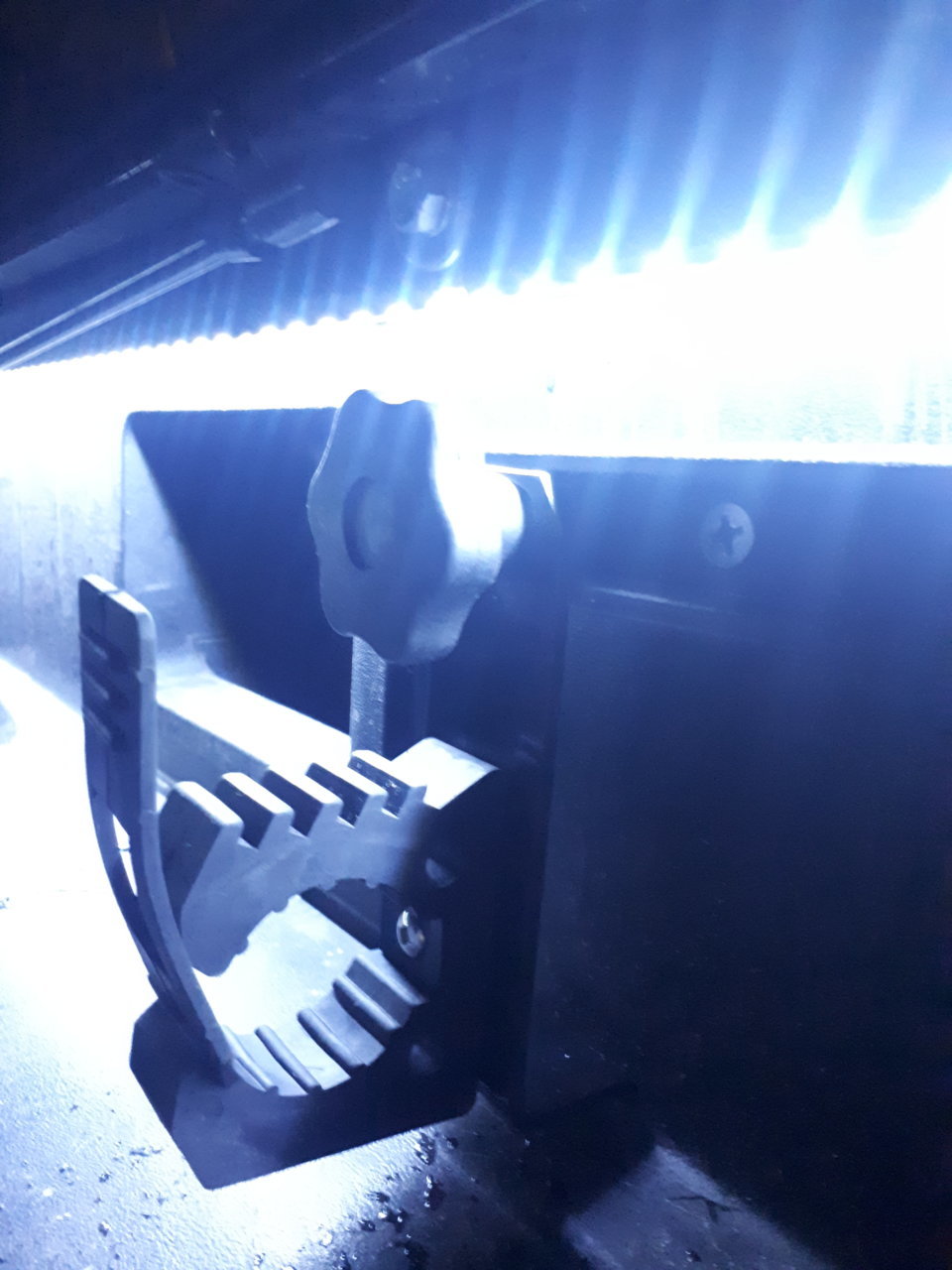

    So I made some shovel mounts to be mounted on the extra bed rail I put on this past summer. They turned out well but not perfect.
    Issues to be rectified:
    - raise the quick fist up about a 1/4" on the bracket above the fender well to prevent the handle of the shovel from rubbing.
    - leave a little more bracket above the hole for the knobs. The way it is right now, the top edge of the bracket doesn't sit against the rail. This results in the bottom of the bracket being forced away from the bedside when the knob is tightened.
    I made these using some aluminium flat stock. 1" bend at the bottom to rest against the bedside. T slot nuts and knobs found at Ottawa fasteners. I had to trim the threads on the knobs because they were too long.
    Here is a link for the PROPER knobs -> no modifications required.
    Here is a link for the T slot nuts

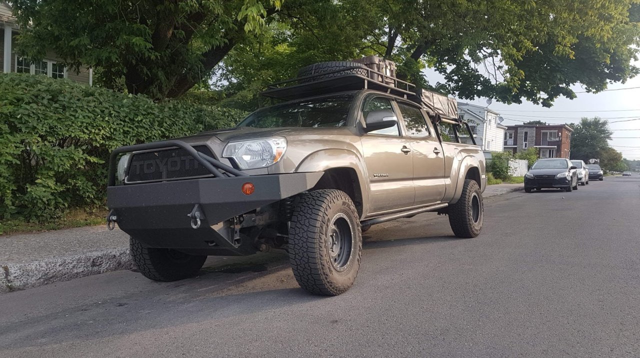

    I just asked a friend for the contact of the guy who made his roof rack and sliders. He seems to be doing custom works, so top plates on the sliders should be ok with him lol and also he did a pretty nice roof rack, but not something like prinsu tho, but still really cool. like custom roof basket
    and about front recovery, I may pull the trigger on the mobtown front recovery bar, so I dont always haul the winch, and is also interchangeable between our model and the 2012-2015, so if (when) I go for DC i can still keep it. And Canadian Tire has a great deal on a 11k lbs champion winch, in a craddle, with wires and a snatch block too. would be the best option imo

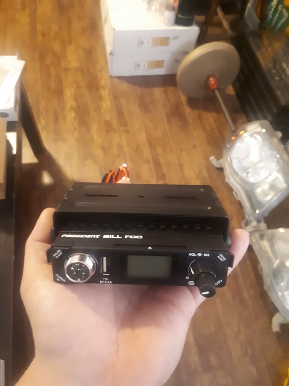

    Got my CB in the mail! Now I have to wait for warmer weather to install it.

    That thing is nice and small. What make is it? Hard to read the labels
